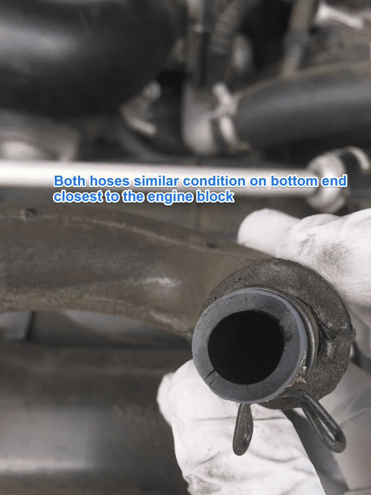

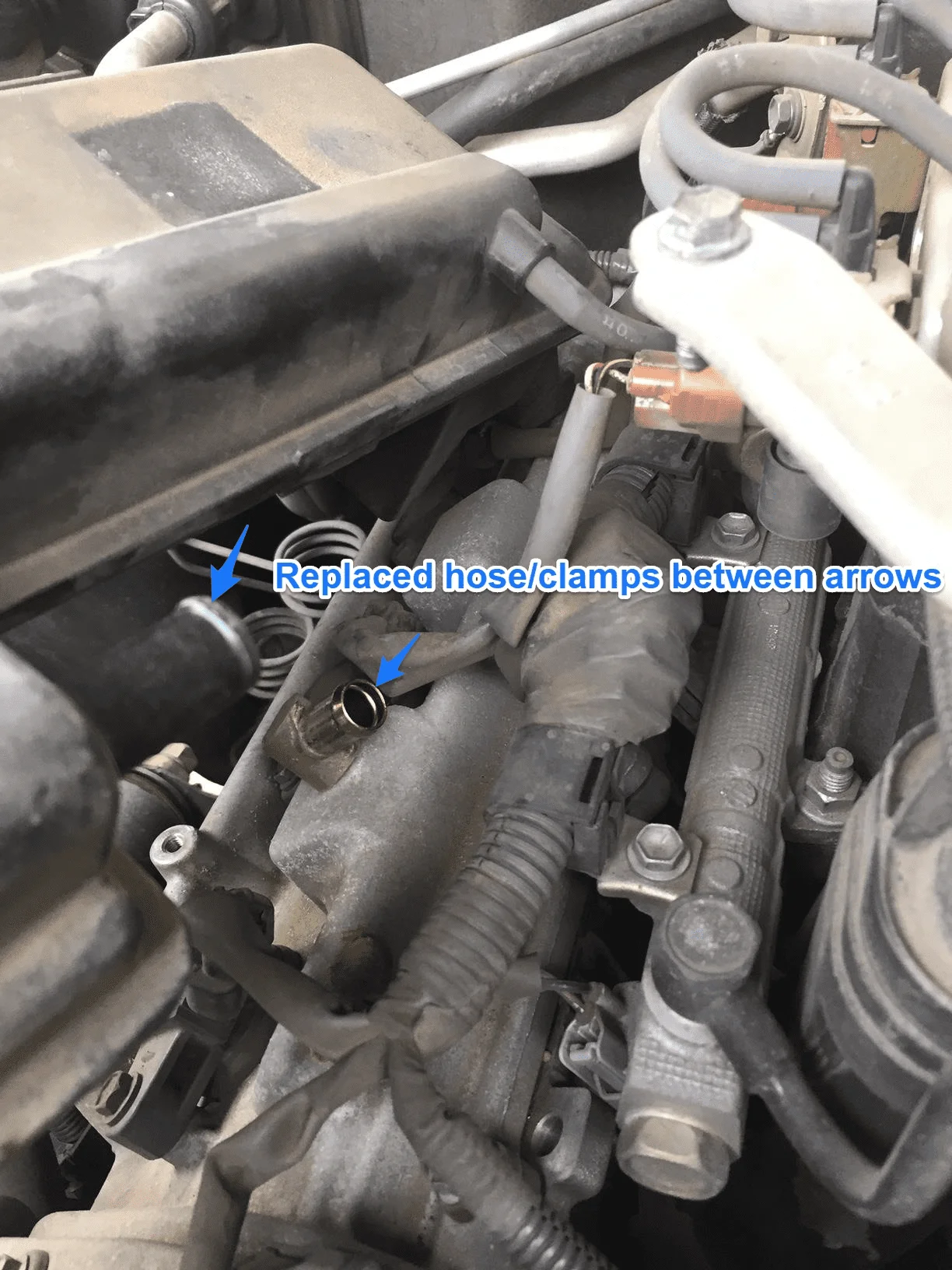

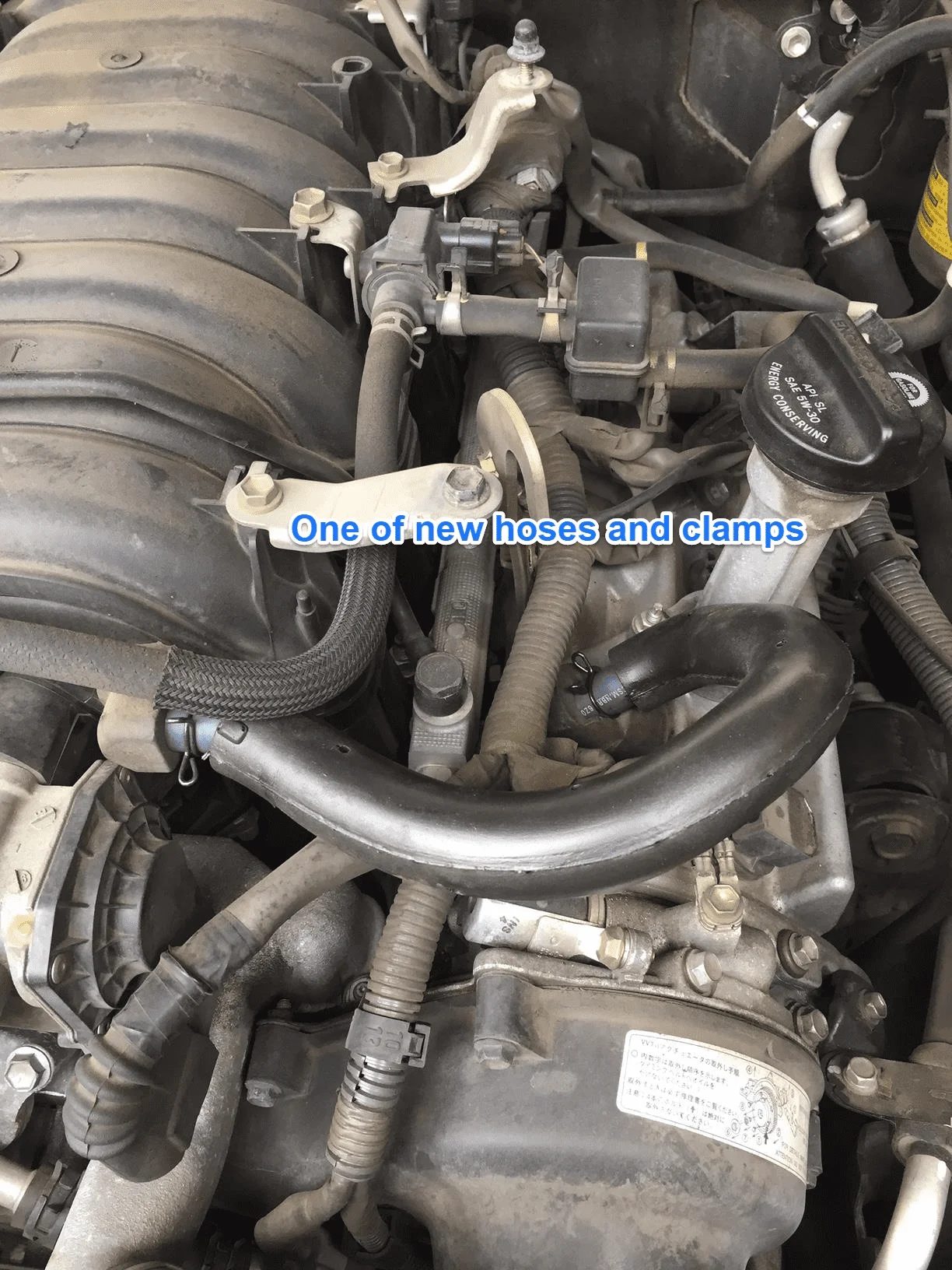

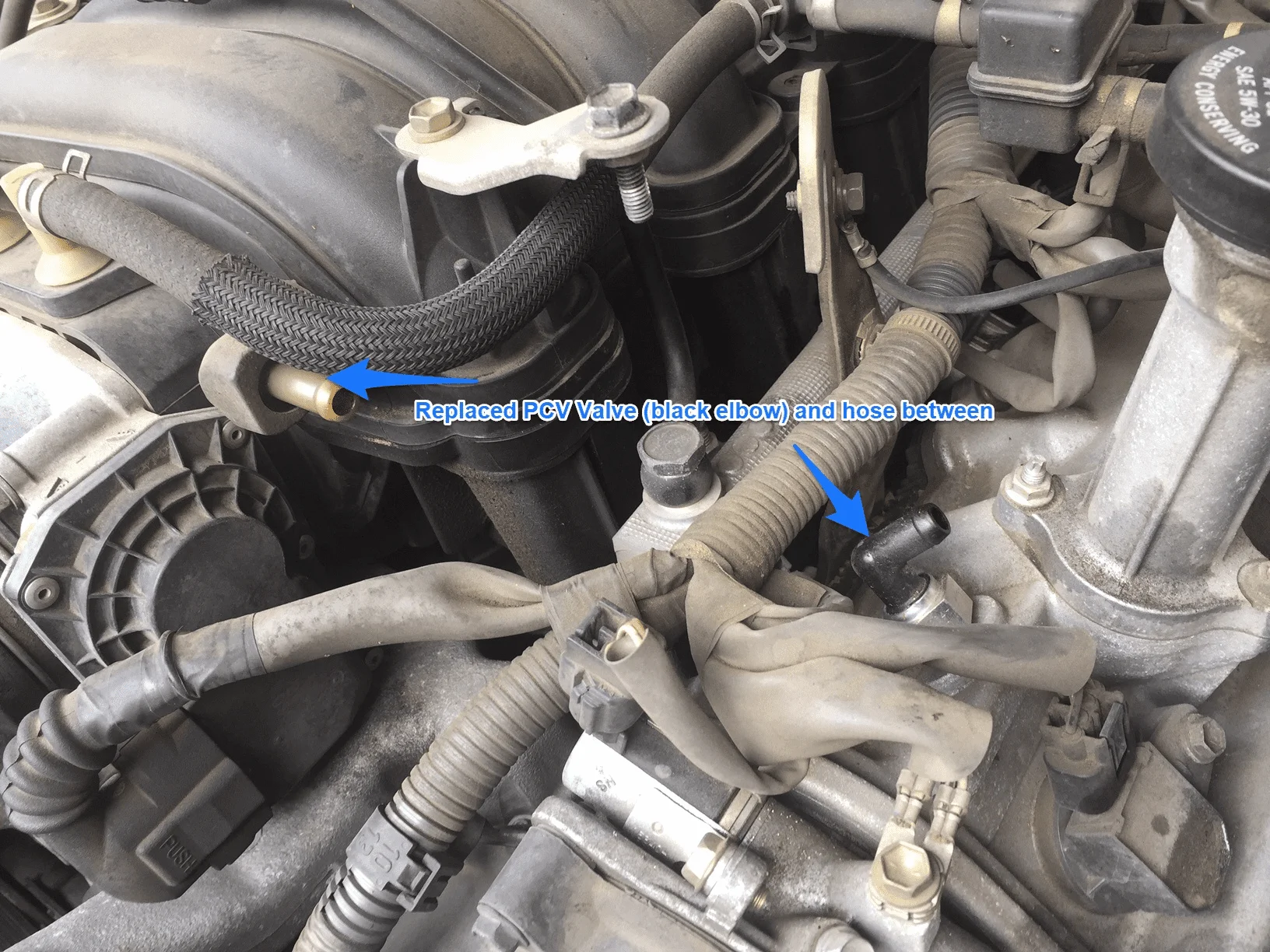

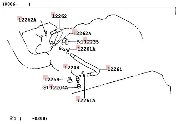

My Notes from '06 LC - replacement of both vent system hoses and PCV valve at 147,650 miles (Parts total was $39.99 + tax after receiving 25% club discount at local parts counter)
Part No.: 1226250080 (ID 12262)
HOSE, VENTILATION, NO. 2 - ($16.53) $13.51
Part No.: 9046720010
CLIP, VENTILATION, NO. 2 - ($1.41) $1.15 ea. (qty. 2)
Part No.: 1226150070 (ID 12261)
HOSE, VENTILATION - ($22.11) $18.08
Part No.: 9046715021
CLIP, VENTILATION - ($.95) $.78 ea. (qty. 2)
Part No.: 1220450030
PCV VALVE - ($9.96) $8.14
