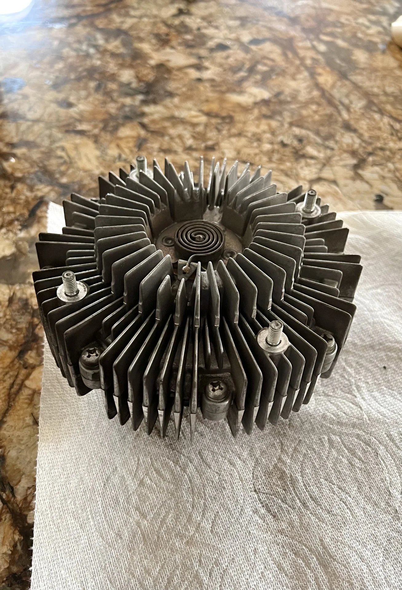

Fluid (fan) clutch engagement is based on heat. The coil visible at front of fluid clutch expands with heat, turning a center shaft it connects to. The center shaft opens and closes a valve within fluid clutch, resulting in varying resistance applied to fan. Fan clutch should still engage and disengage to varying degrees even in higher OAT conditions. Since higher OAT & ECT result in hotter air passes out back side of radiator fins, on to FC's coil. It's understandable, the higher the OAT the sooner fan engages to a greater resistance. But as you noted, it is not fully engaged shortly after cold start.

Very unlikely, two new OEM fluid clutches bad out of the box. The biggest complain of new FC is: Not enough resistance. Which some replace FC oil with a thicker oil, to increase resistance increasing cooling.

I do not recall you talking much about actually testing of fluid clutch!
How I test fluid clutch (06-07) 2UZ-fe VVT):
  1. Cold engine/coolant/radiator, before start-up. Hand spin fan blades will have mild resistance to spin at first. After spinning a few revolutions, resistance lessens. If fan will not spin (locked), fluid clutch is bad.
  2. Cold start engine: RPMs will be high, SAI pump on (can be heard), engine cooling fan roars and cannot be stopped from spinning.
  3. About 30 to 90 seconds after cold start, fluid clutch resistance reduces (disengages). At 90 second the SAI pump (blower) shut down (sound like turbine shutting down) and RPM are dropping back ~1,200 to 1,000. Fan blades can easily be stopped with either a rolled-up paper or water pressure.
  4. As ECT climbs above normal operating temp and radiator radiates more heat, as works to dissipate coolant heat. The radiant heat, heats coil on fan clutch expanding it turning fluid clutch valve. Fan cannot easily be stopped from spinning with water pressure or rolled up paper.
  5. Stop hot engine while fluid clutch engaged. Very high resistance felt, when spinning fan by hand.
A stuck fluid clutch will result in lower ECT and lower MPG. They'll typically also result in fan blades/fluid clutch, being off balance. Resulting in excessive engine vibration.

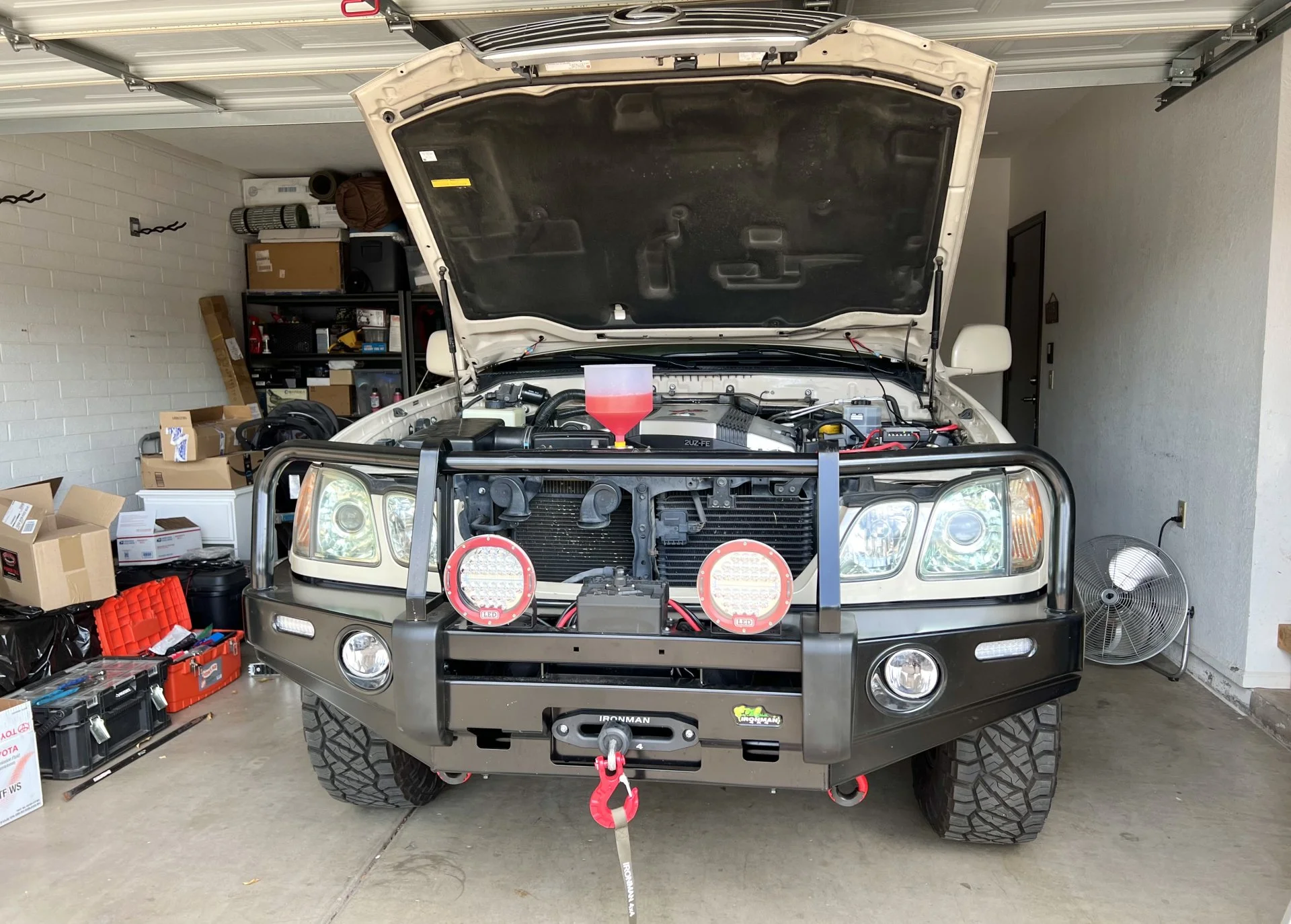

I notice you use one of those special funnels to fill radiator.
Have you checked coolant level under the cap. Before starting up, before sun comes up and after 8 hour cool down?
This is best done, with front of vehicle higher than rear, so high point (air pocket) is at rad neck/cap. Any air under rad cap, coolant system will not function at peak.
Additionally, I'd check to make sure reservoir full and its hoses & cap clear of obstruction and inner hose drops straight to bottom of reservoir. I find many reservoir hoses curled up, from getting hung on shelf inside. This result in sucking air, into radiator (air bubble). I also find, clog in reservoir hose or its cap and or bad radiator caps. All must work as designed, or you'll run hot.

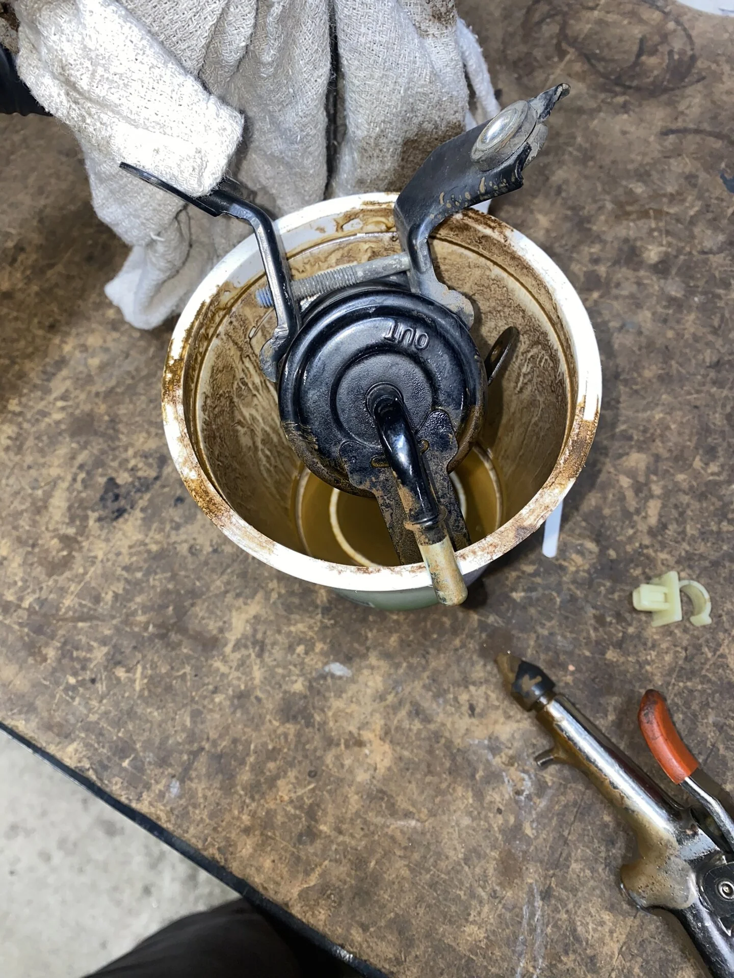

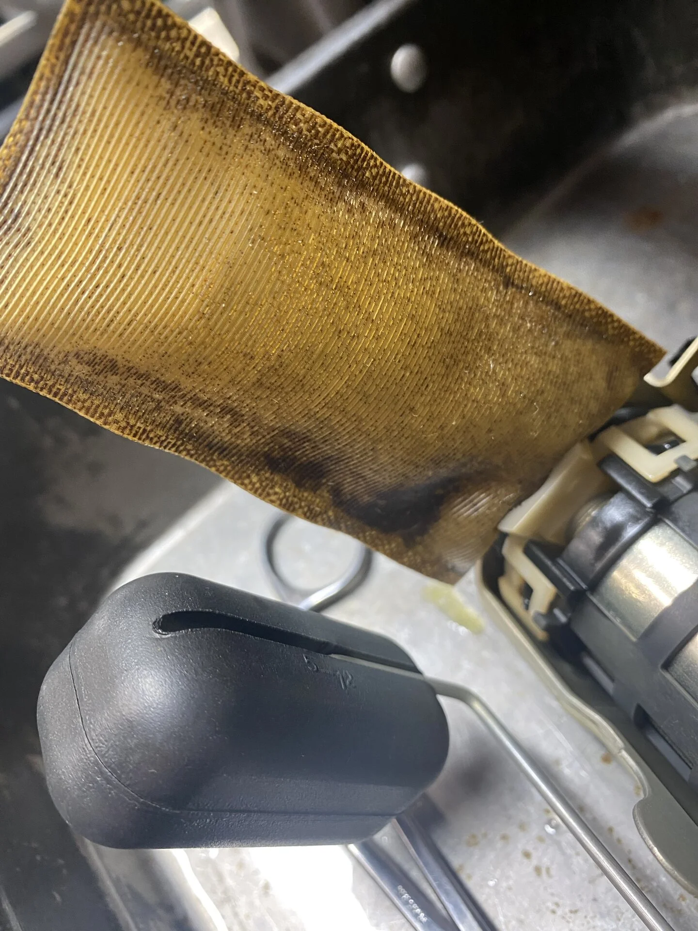

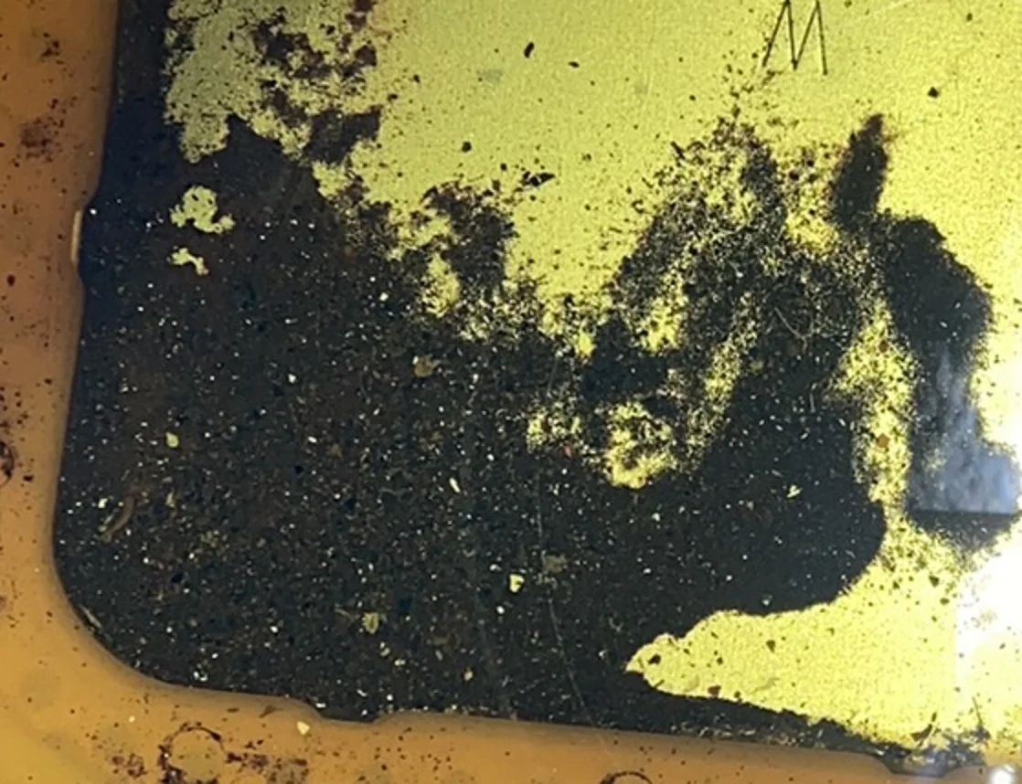

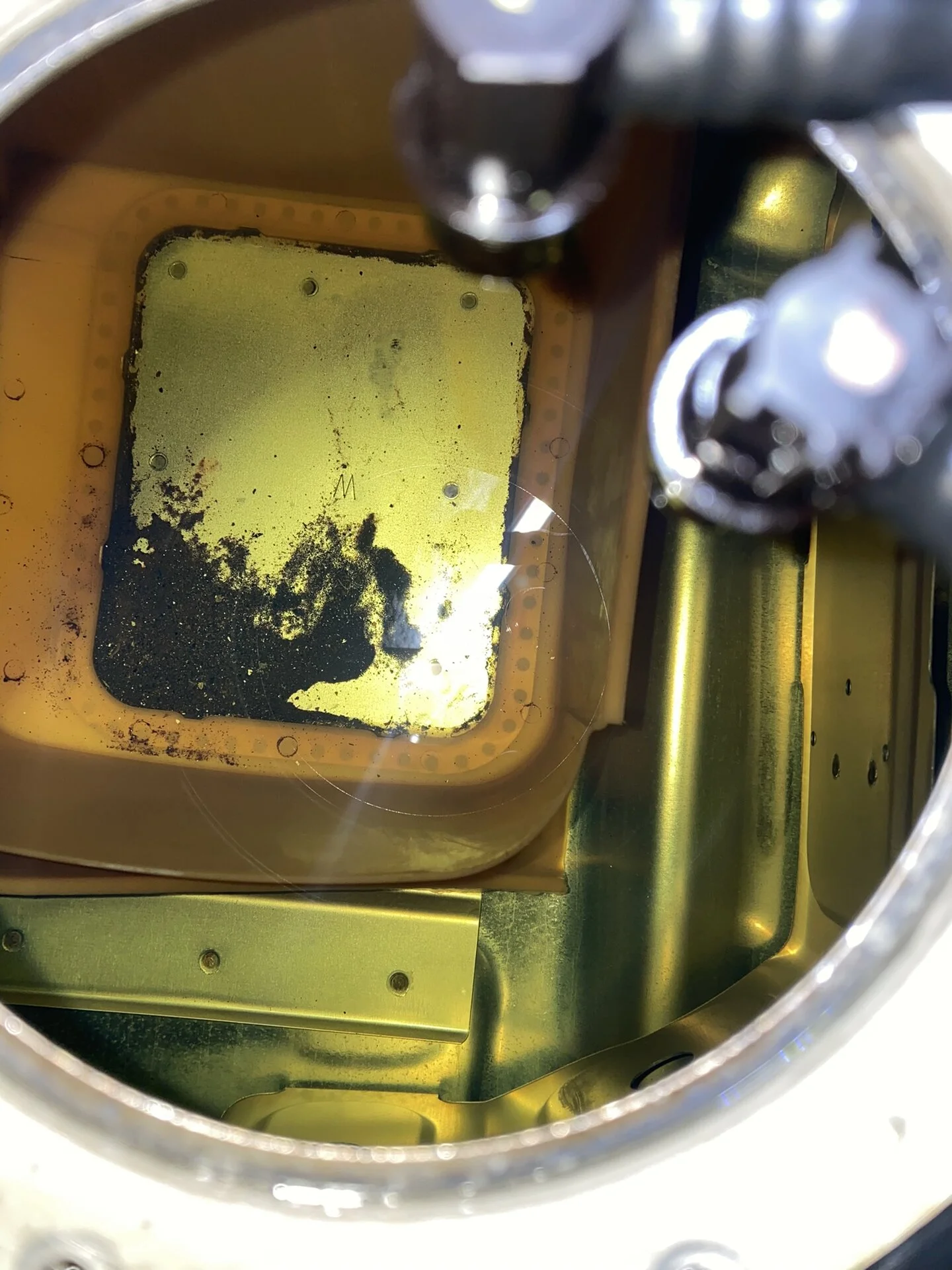

Long term fuel trims are showing "what" ECU is doing, to correct fuel trim to achieve a 15:1 AFR. A positive LTFT, is indicating a lean running condition. When we see LTFT above 5%, we need to look at why we're running lean. Easy way to say/reads this is; needing more than 5% increase fuel to the mixture to achieve 15:1. We also compare LTFT to STFT, to see if ECU adequately correcting. Wherein most cases the ECU will correct FT enough to prevent, cylinder head temp being to high (lean) or low (rich). The FT is an indicator very helpfully to watch, as a clue something is not operating optimally.
A case I just corrected fuel trims on (lean running). Was 06LC w/250K miles, with LTFT ~7%, NO CEL or pending DTC.
After using 44K a few times, full tune-up (plugs & boots, vacuumed lines, PCV, TB CLN, T-belt, etc.), coolant service and all fluids over last few years of servicing. This excellent running, handling, braking, shifting LC. A/F and o2 sensors checked out fine, with no indication of weak MAF or damaged CATs. Compression good.
But LTFT remained over 7%, the entire time. Last month, getting it ready for a very long trip and move out of state. We R&R fuel pump & filter. LTFT for the first time came inline afterwards. LTFT now steady at 0-3%.
It was interesting what I found in fuel tank, fuel pump sock and fuel filter before replacing.
Which must have been restricting fuel flow (lean condition) indicated by LTFT 5-7%, now at 0-3%.
Iron, remains of Rust from fuel station storage tank sediment.
