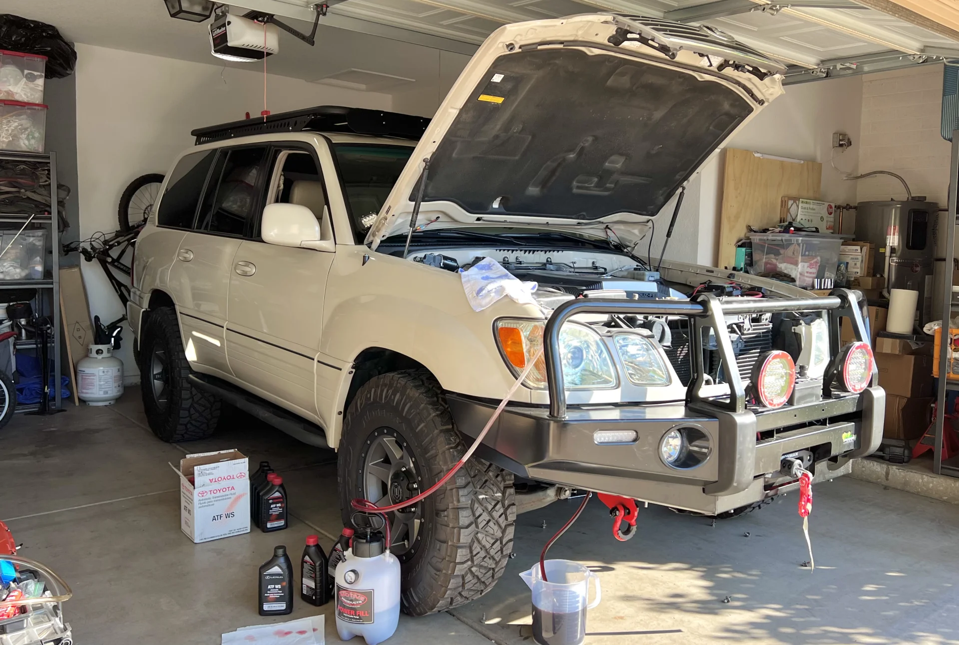

nice job. and you even got the correct hose for transmission fluid change.

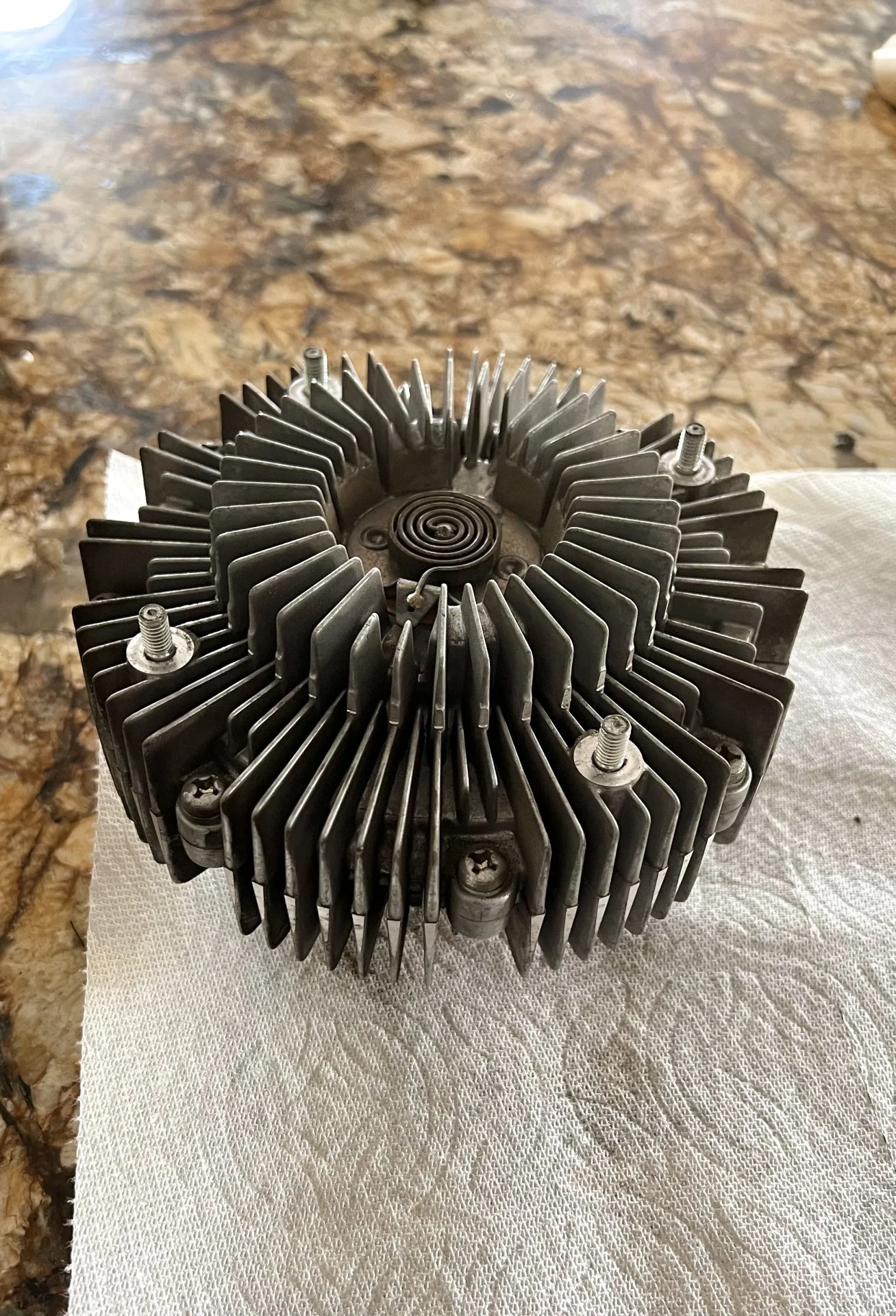

List the part number of the FC you installed. Make sure the right one for the right application.
Start Engine from cold, idle for a couple minutes to shear the fluid back into the reservoir and shut off. Go and rotate the fan by hand- you shouldn’t feel too much resistance on a cool engine after only a couple minutes of operation.
The factory fill of silicon fluid in the Blue FC is usually under filled from AISIN maybe 20-25ml total thus causing it to spin more freely vs staying hooked up( fwiw-optimal volume is around 45-50ml). It is entirely possible the fluid is either greater than normal fill or the opening temperature of the internal valve is set wrong. Too much fluid will keep it engaged longer or fully when hot.
If you purchased from Amazon- return it and try another or if not returnable, open it up and reset the temp at which the valve opens and closes.
Fan clutch is OEM from the dealer.
Before cold start, spinning the fan with my hand gets it to spin 1.5-2 blades. Cold start then idle a couple of minutes then shut off. Spin it with my hand again, about the same maybe just a tad looser about 2 blades turn.
