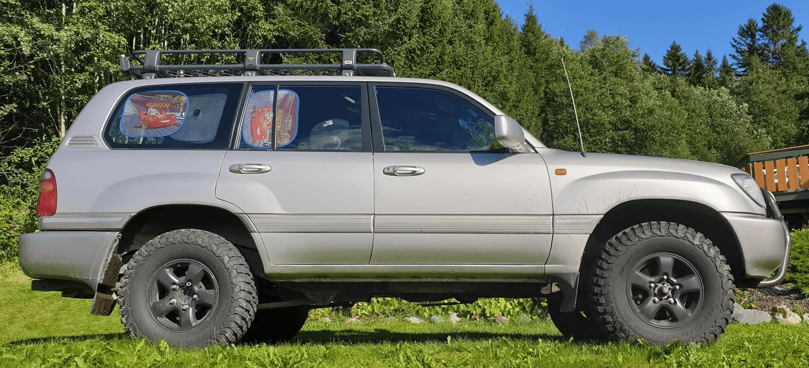

My car: 2000 model HDJ100 with 4.2 tdi and a 4 speed auto + AHC. Mileage: only 325 000 miles.

I have nothing tech to add, but we'd all love more pics of your HDJ100! Welcome!
