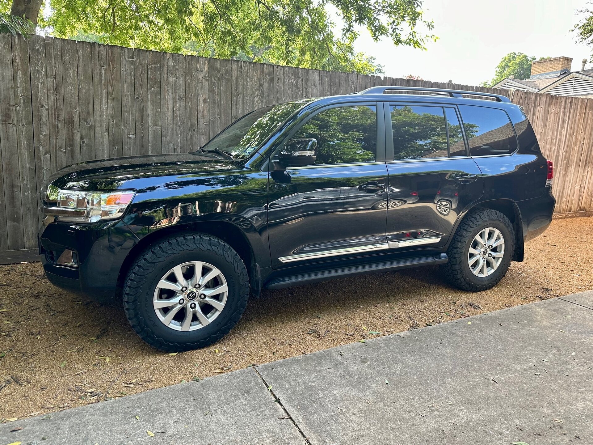

Just in case you lean back into the 285/65/18 on stock wheels. No rubbing. Front coil spacer

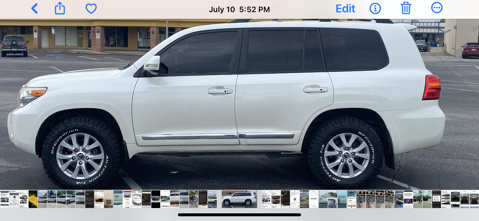

I've run both 285/65R18 and 275/70R18.. (at the same time! double check your tire shop's work folks!) IMO the extra width of the former looks better than the marginal extra height of the latter.
That said I dislike that nearly all 285/65R18s are e-load tires.. we have no need for that robust of a tire. But the Wildpeak is available in non-LT 285/65R18 construction which I believe to be a huge win for us.
