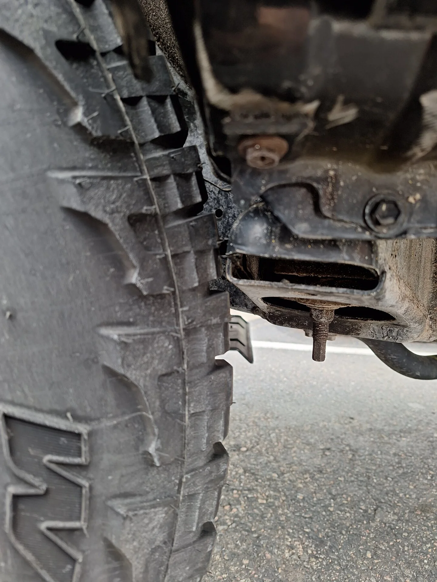

I recently pulled the trigger on a Dobinsons 2.5 lift with JBA UCAs. After the install, I was having some rubbing issues on the driver's side frame mount. I took the vehicle to Toy Crawlers here in Broomfield, CO, and had them install new OEM LCAs, SPC cam bolts, and Total Chaos cam tab gussets, plus an alignment. Unfortunately, I'm still getting some rubbing at slow speeds and tight left turns, like in a parking lot, and it seems to be worse when braking or if the vehicle is pointing downhill at all. It's definitely better than it was before I got this work done. Oddly, the passenger side is fine. Forgot to mention, the wheels are FN 17x8.5 with a -6mm offset and 4.5" backspacing. Tires are Falken Wild Peak 285/70R/17.
Toy Crawlers is recommending a BMC, which I'm ok with, but I'm wondering if swapping to SPC UCAs would be the better option here. I don't go hardcore 4wheeling or anything like that, and I will not be upgrading to larger tires in the future. What would you guys recommend? JBA allows you to return their UCAs for any reason within 12 months of purchase, so I'm good there. It would definitely be more expensive to swap to the SPCs and I'd obviously need another alignment. It sounds like they were only able to get about +3.5 degrees of caster with the JBAs, and from what I'm reading, the SPCs will allow for more. Is there a chance that after a BMC, I could still have rubbing issues? Any input is appreciated...sorry for the long first post! Thanks - Jeff

Thanks for the reply. I will try to grab some photos tomorrow, but we verified it's definitely rubbing on the driver's side body mount.

But OP said he rubs body mount, so chopping it is probably his best option

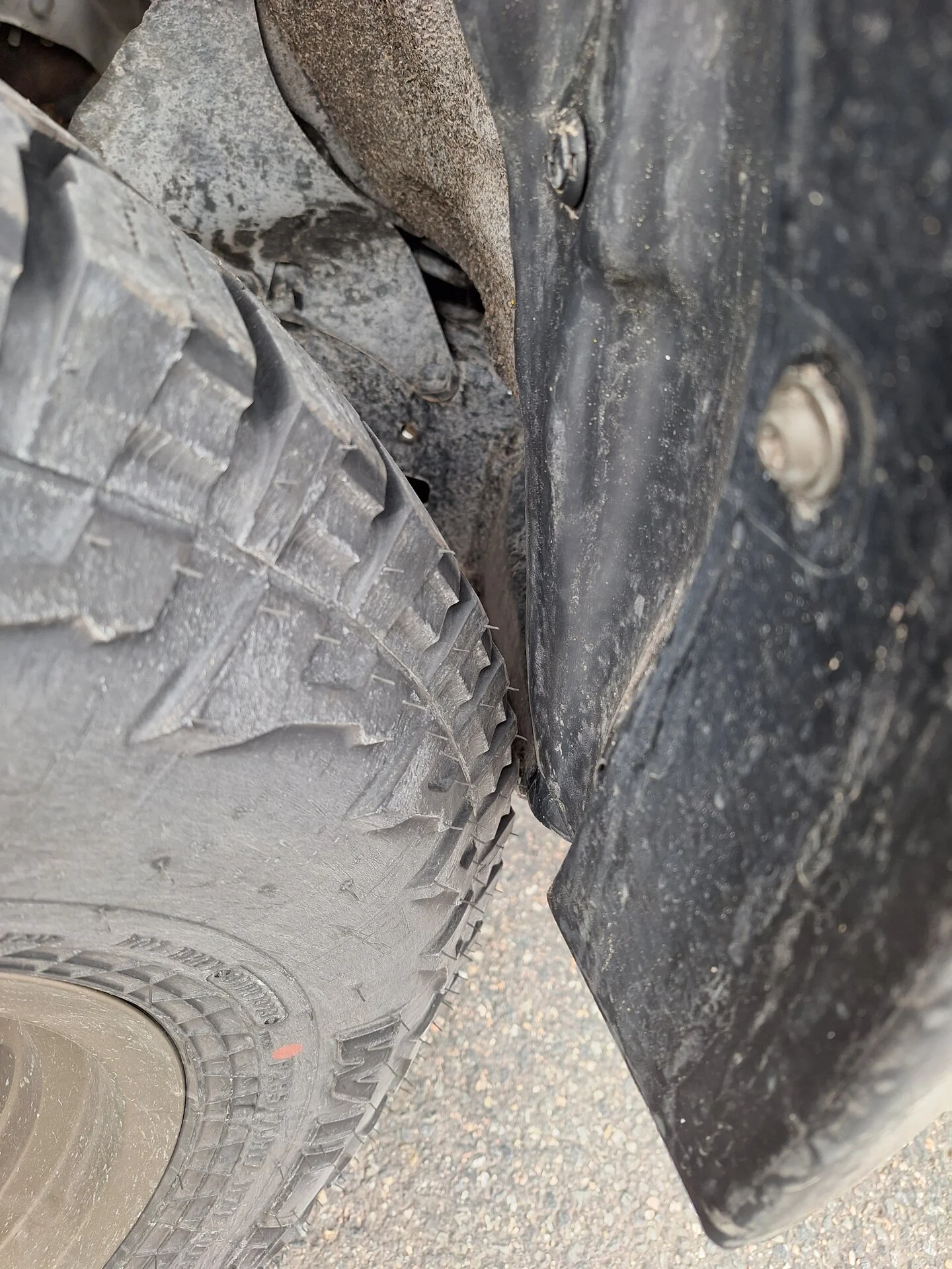

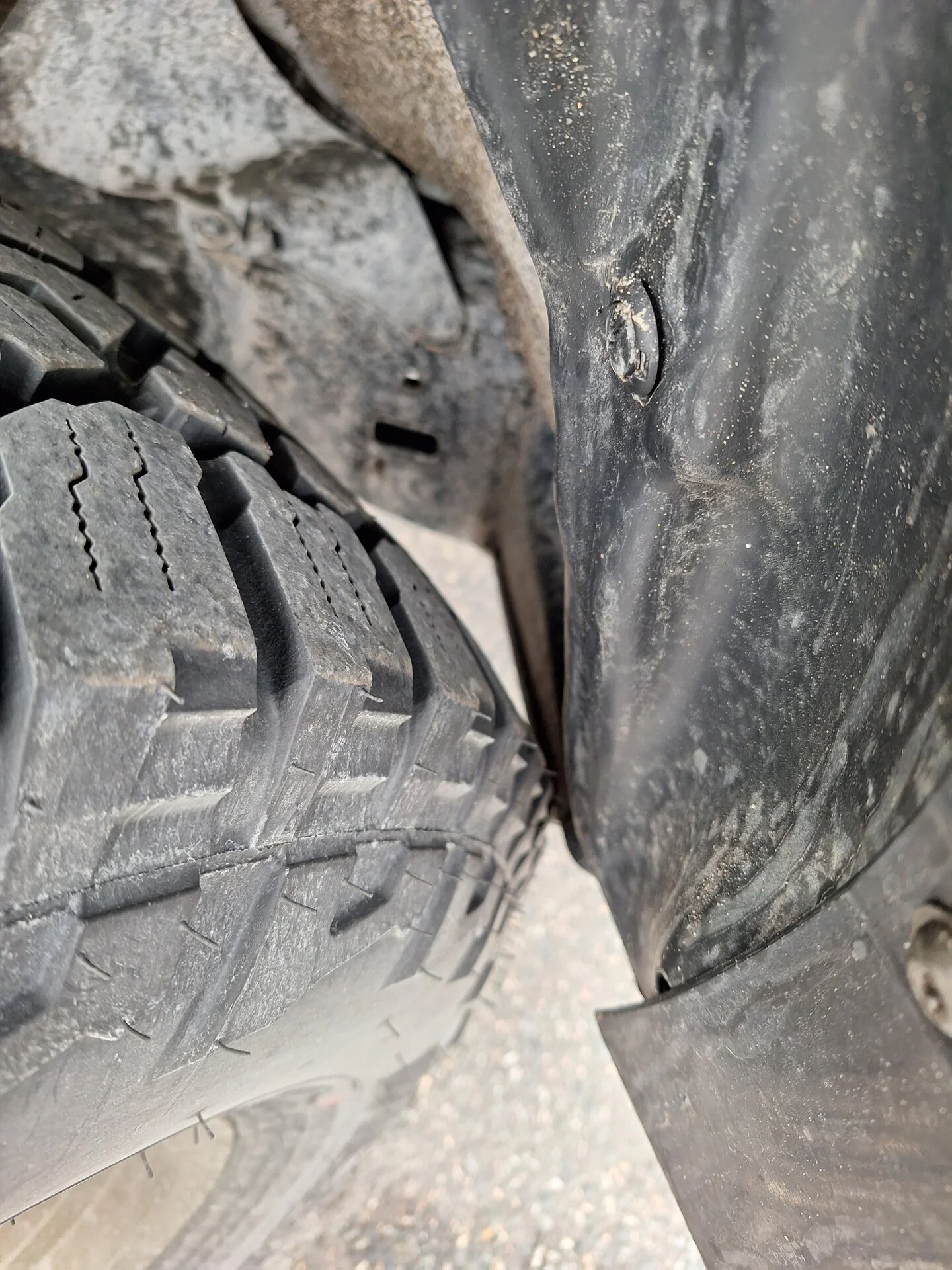

Apologies for the delay. Here are a few photos. I'm parked on a very slight decline here.

Adjusting for more caster through the UCA effectively moves the tire rearward, making your issue worse. With the SPC, you'd be adjusting for less caster for better clearance. It looks to me like you should start with the BMC and go from there. You can also go with offset bushings in your lower control arms (LCA) to move the LCA/ball joint connection point as far forward as possible (position forward frame side LCA pivot as inward towards the engine as possible and the rear LCA pivot as far outward as possible): SuperPro Front Lower Control Arm .Camber/Caster Offset Bushing & Camber Pin Combo - https://superprousa.com/collections/bushings/products/superpro-front-lower-control-arm-camber-caster-offset-bushing-camber-pin-combo. But, then you'll need the adjustability of the SPC UCAs to be able to dial in the alignment for both caster and camber.

Right on, that's great info. I appreciate it. I think I'm gonna just do the BMC because it's the most cost effective option at this point.
