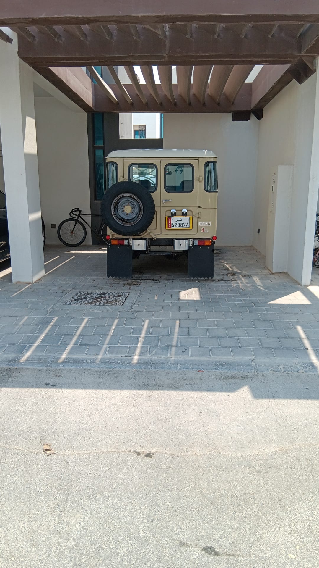

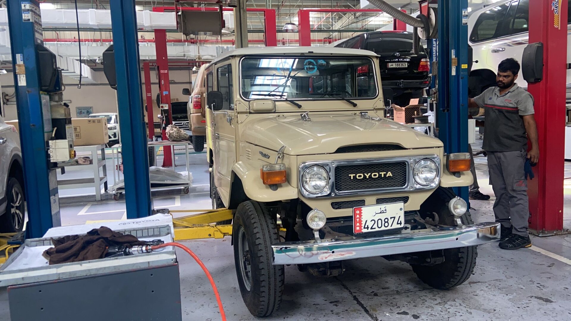

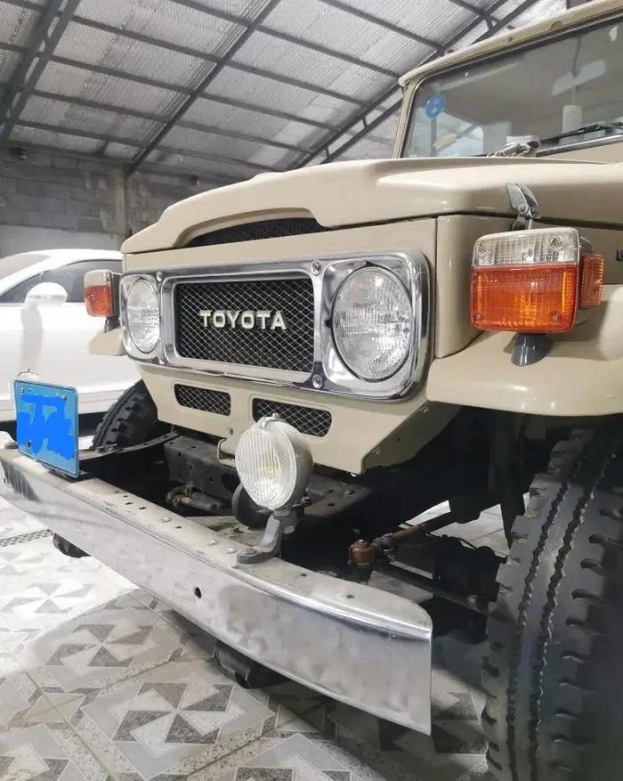

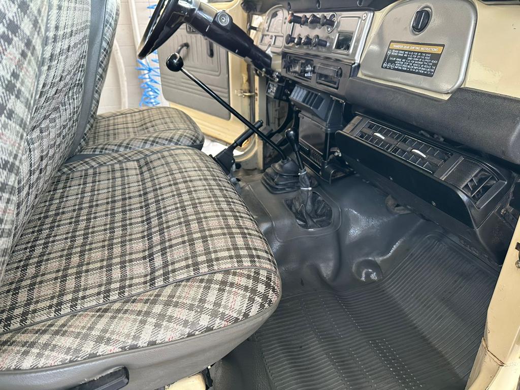

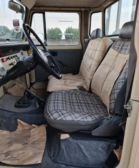

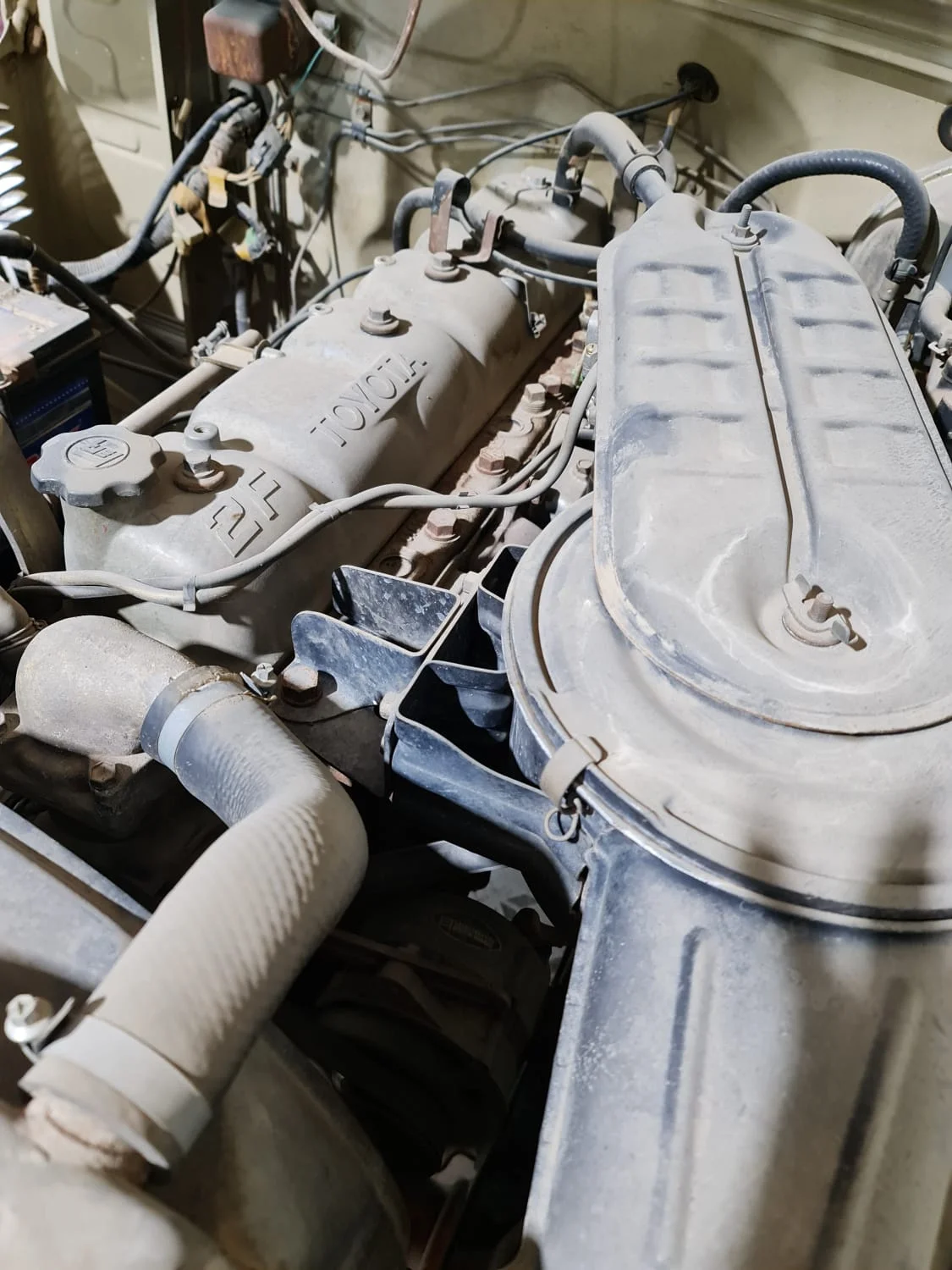

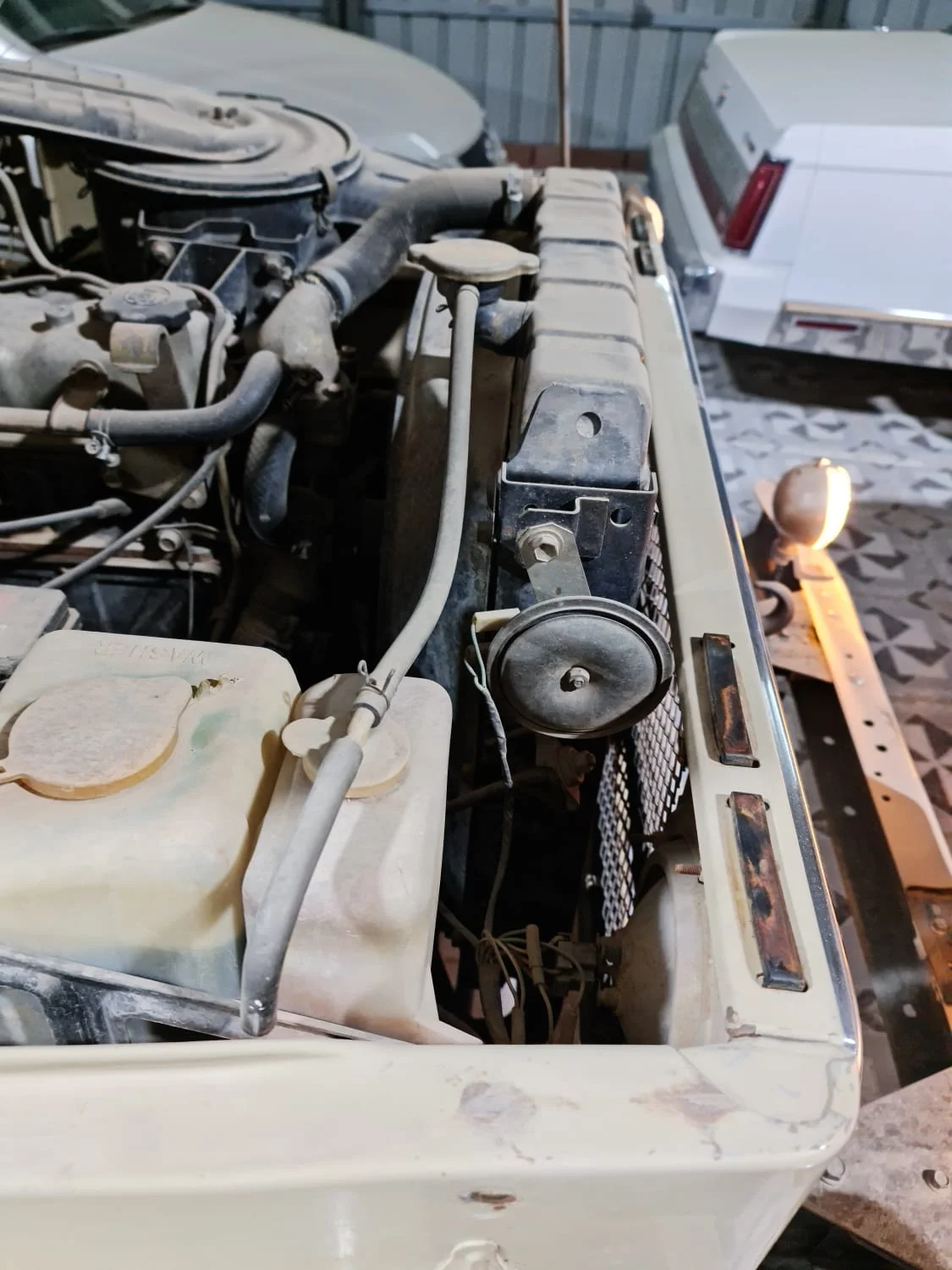

Thanks, I'm really pleased with. Here are a few photos i have of it. Not sure if the old Panasonic radio is standard, its possibly from an FJ60 - although i guess dealers fitted whatever they had at that point in time, given the FJ60 was out around then too.

Congratulations, it's beautiful!

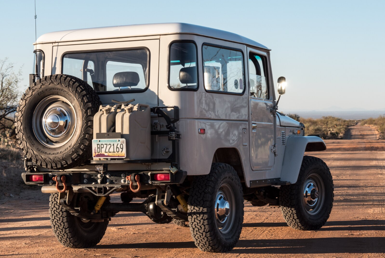

The "benefits" of split rims are wildly overstated. I ran them for several years on my FJ40, and have several tens of thousands of miles experience with them in Africa. Yes, you can break down a wheel and fix a puncture in the field—but ANY puncture requires the full procedure. Safari clients get tired of waiting after a while. With tubeless tires and a plug kit most punctures take about three minutes to fix, on the vehicle. And with Tyrepliers and irons I can pull a tire off a non-split-rim wheel anyway if I need to. Most tires on split rims in Africa etc. are still heavy and rigid bias-ply and ten-ply rated, to fend off thorns and minimize a 30-minute long (if you're good) tube-patching procedure. Split rims sound all romantic and bushman; the reality is different.

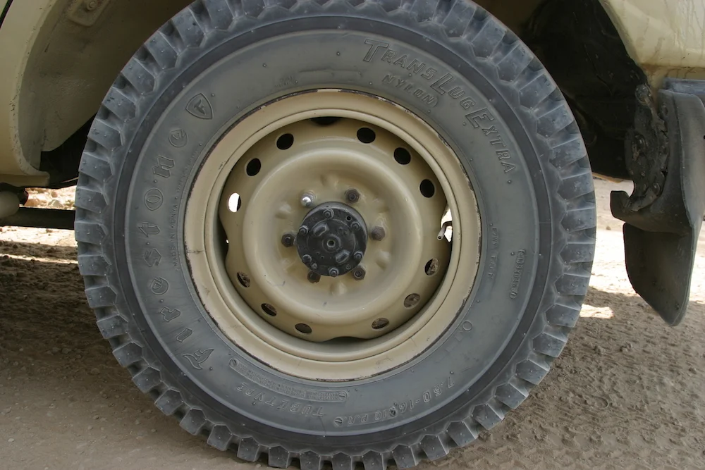

I plan to keep the current tyres for a little longer, as you say - they look the part. They are made by a company called Swallow, and seem to be a copy of the old Dunlop pattern, as you suggest. Not sure on the quality, but i've noticed a lot of Middle Eastern 'restorations' being sold with these, so not surprised to see them on it.
