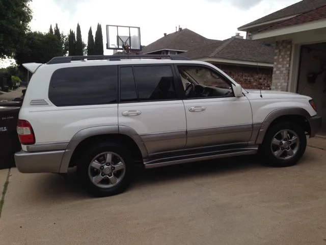

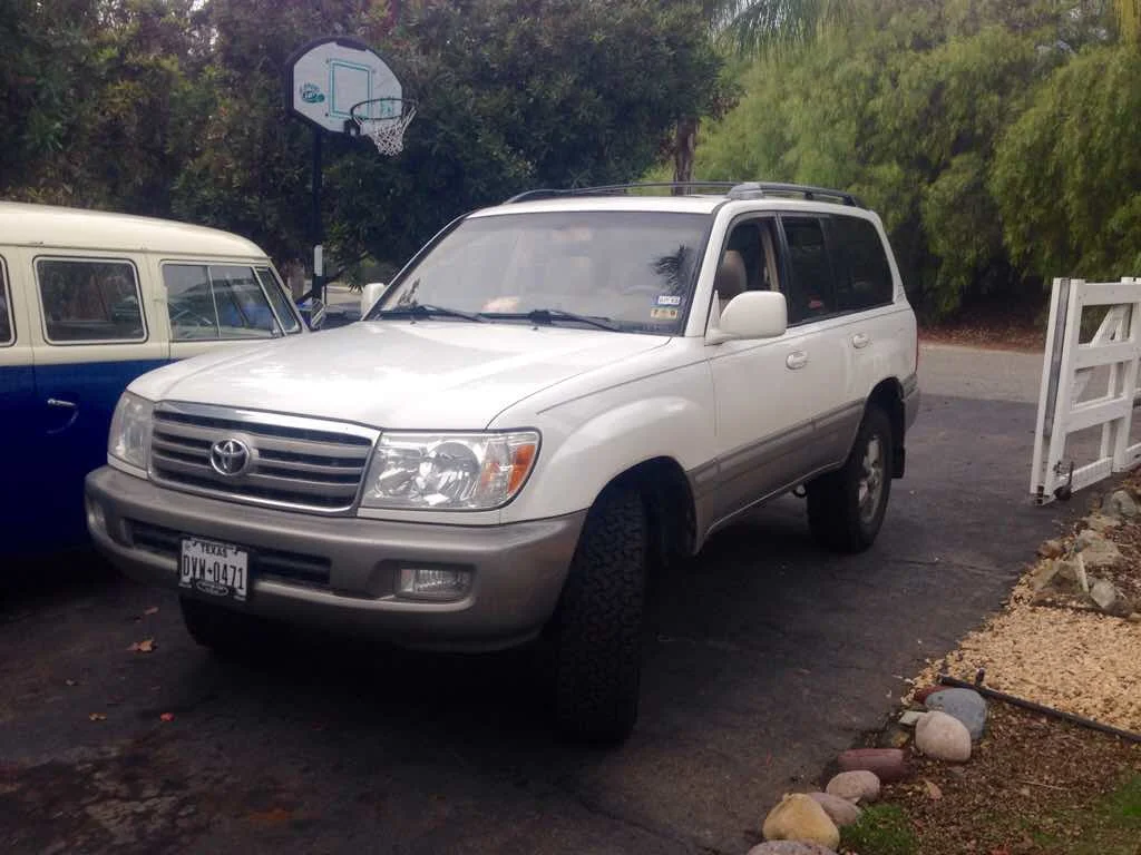

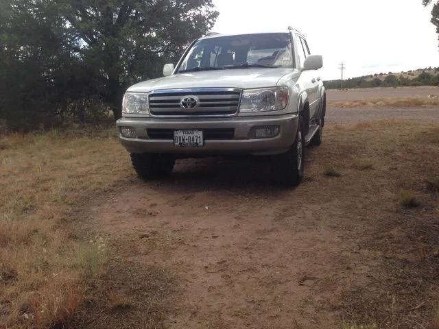

Anyways, while deployed I found a nice low mileage (93000 miles) 2007 land cruiser and asked my parents to check it out. Next thing I know it was in their garage in Dallas. Original picture attached. Knowing I was going to drive back to San Diego I decided to do my first upgrade and go with 275/70/18 BFG A/Ts. I was also planning on visiting my friend in Lubbock on the way home and going to buffalo springs.

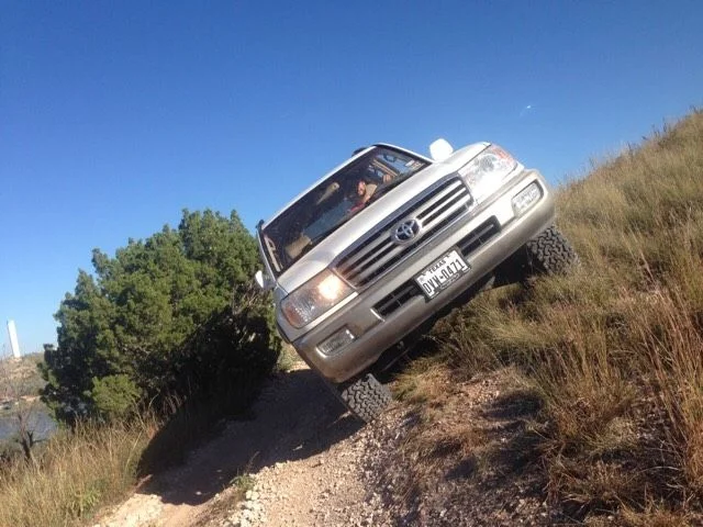

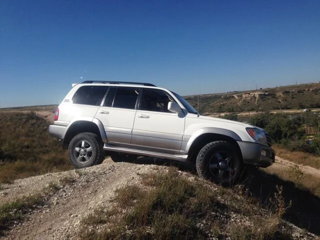

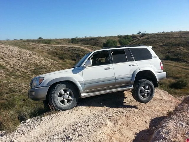

Upon my arrival I discovered a car that met and exceeded all my expectations. I've never even driven a hundy before so it was all new to me. The drive was amazing and it even looked better than I expected inside and out. The larger tires helped. My long drive home took me to Lubbock as planned and let me explore the off road capabilities of the truck. I got to use all the off road goodies (low gear, high AHC setting, and central diff lock). This thing was amazing. For such a large truck it did so well especially compared to my buddies stock wrangler (with 33s). Overall I am very pleased and can't wait to do more traveling and wheeling.

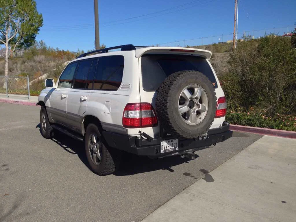

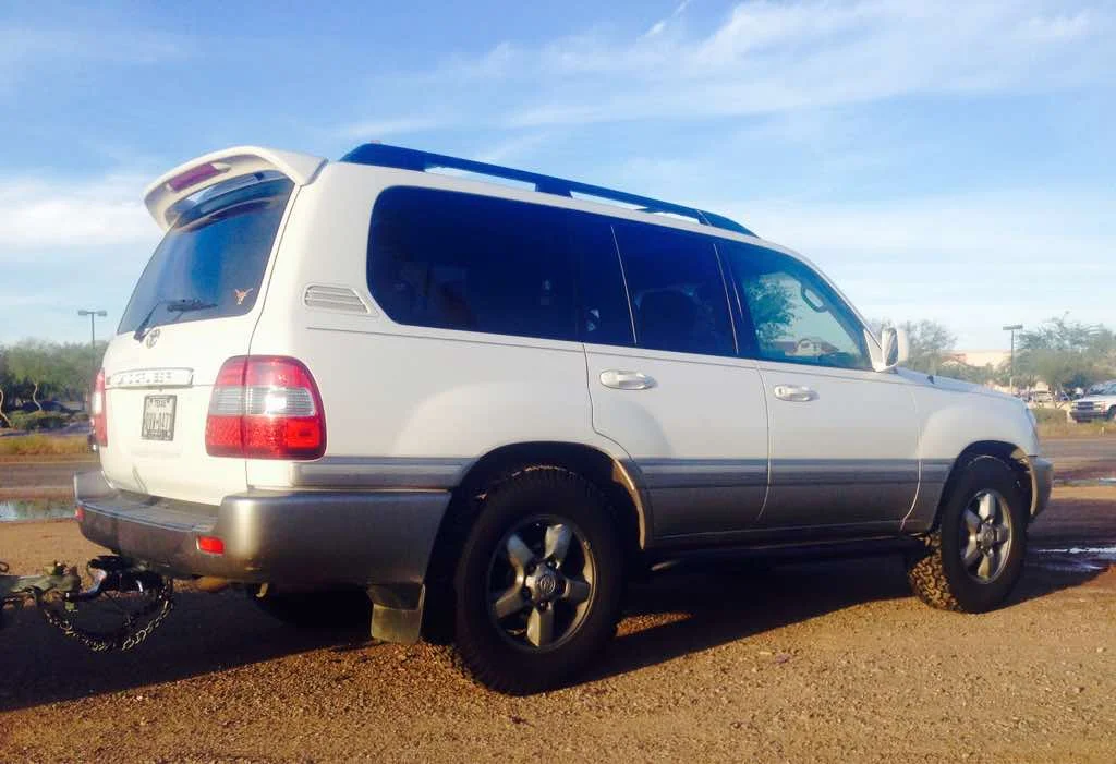

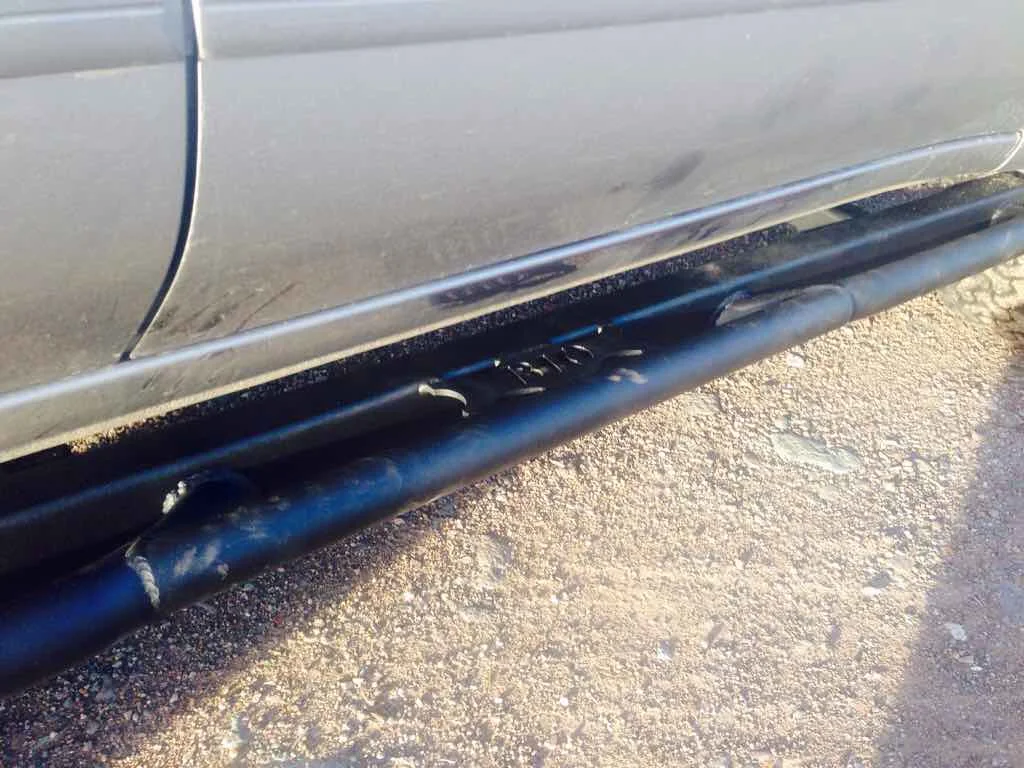

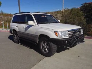

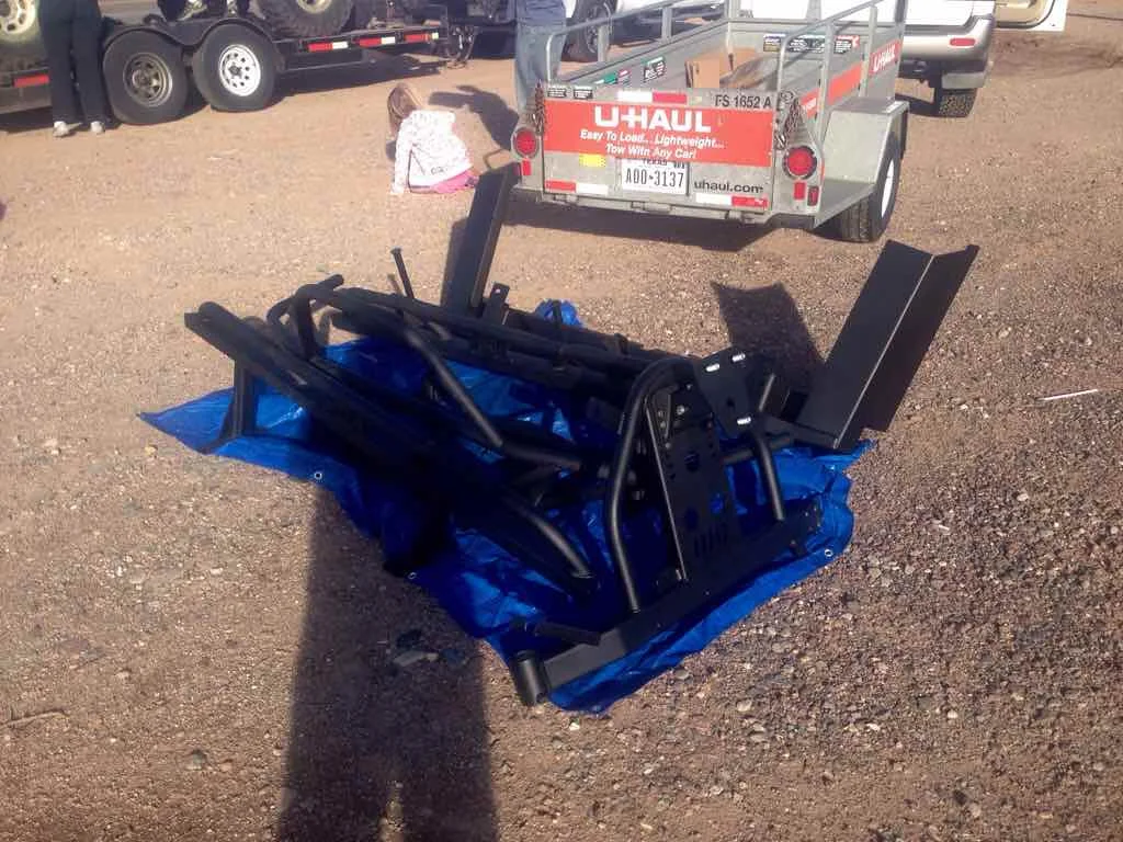

My time in queue finally came to recieved all my Bump it off road parts. Mike from Bior agreed to meet me in Arizona on the way to family vacation so that I can grab all the amazing assortment of quality parts that he had meticulously crafted for me. Mike is great. His customer service is hard to beat and his prices are very reasonable. I ordered a custom front tube bumper with mounts for multiple lights, a license plate and wench. Also got a rear bumper with a driver side tire carrier and bike rack as well as tube sliders. I still plan on having him build me a roof rack in the future, but this was great start. So my friend and I met with Mike and his family, put the sliders on and returned to California. As a matter of fact I'm still driving, but we did manage to put the sliders in prior to leaving. Here are some pictures of what was done so far...
Tomorrow the plan is to put on the front bumper with winch and rigid dually lights in place of the fogs. In the read well put on the bumper with all the accessories. More pics to come.

After an excessively long install on every bit of bior candy that I purchased the truck is finally complete.
Parts installed with ease:
- sliders

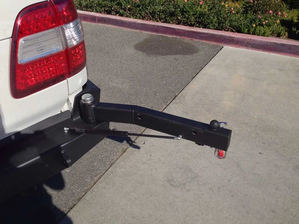

- accessories (tire carrier, accessory swing out)

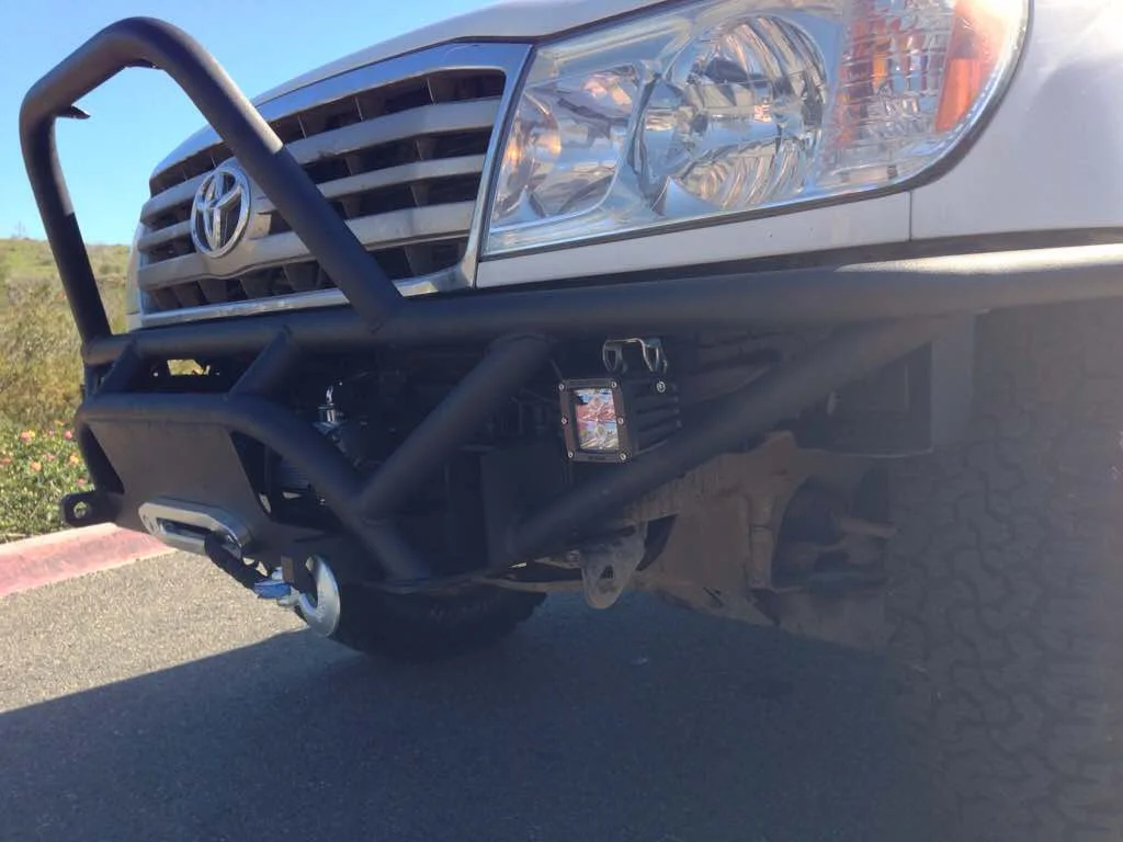

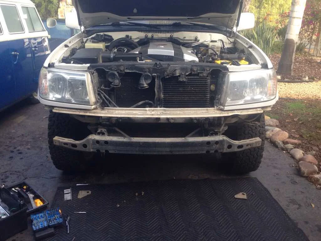

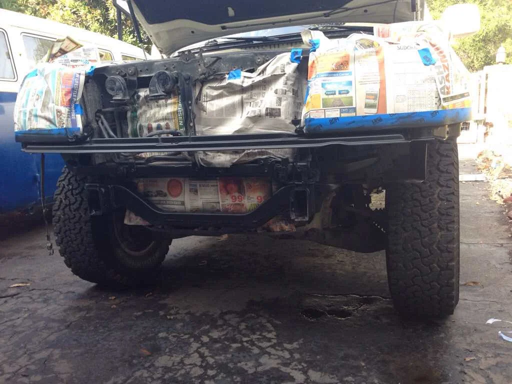

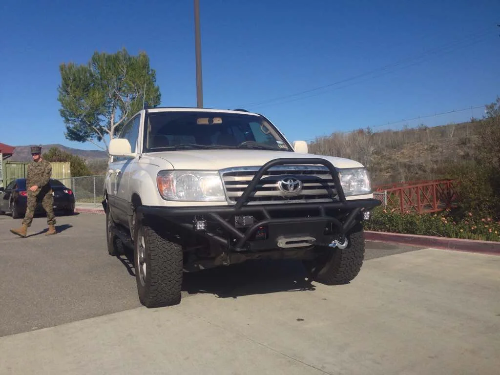

After arriving back home we settled in for the night to start the build in the morning. First we started with removal of the front and rear stock bumpers. Than went on to the front bumper install. All the white overspray parts were painted with plasti dip to give it that uniform look and all the cables under the lights were tucked out of view. Afterwards we decided to install the Engo 12000s winch. This required removal of the solenoid because it was about 4mm too wide to fit on top of the winch. You will see from the pictures that I put in on the passenger side of the winch and attached it to the bumper using a hose clamp.

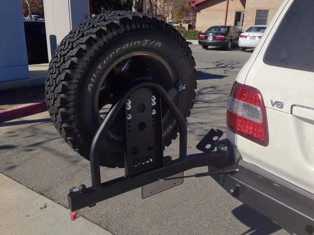

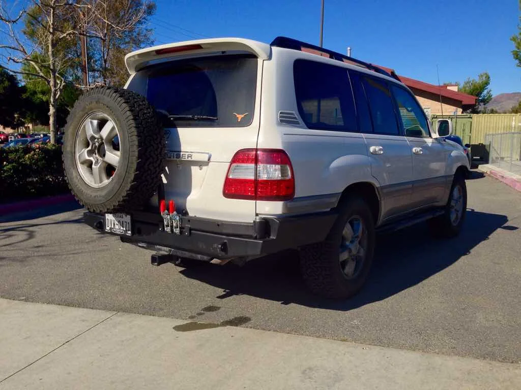

The winch was tested and after I made sure it was functional we tightened everything up and moved on to the rear bumper. On the rear I ordered a cut out for the tow wiring which requires cutting into the cross member. After the cut, the rear bumper was attached with all the necessary hardware, which was straight forward enough and we moved on to the accessories. The tire carrier was solid and a great fit but the bicycle rack mike made was not compatible with the rear spoiler (which I'm actually keeping, I know most of you are cringing at this). So we'll have to work something out.
Last step was to attach the rigid dually LEDs to the factory fog wiring harness. This was really straight forward and worked like a charm. They're super bright and look great on this bumper in my opinion.
