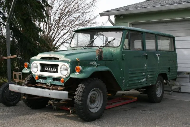

The road to this point has been a long but reasonably steady one. After a long slog getting a 45 year old truck safetied so it could be registered and driven, it sat outside over a full winter. And it's real winter up here - it drops to -30C more than one woudl like. Went outside last summer, turned the ignition, and drove it 500 miles over two mountain passes at 70 -75 mph. Passed a few folks, too! Understatement to say that mileage isn't so great at those speeds.
Now at a friend's house where it is getting the full treatment that it deserves. Going back as close to stock as possible.
More to follow!

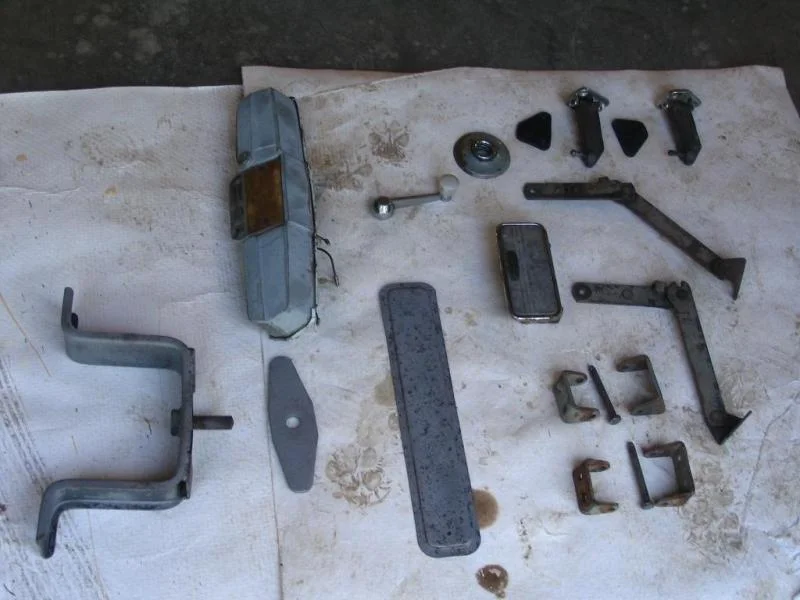

Also just got the following much-needed parts out of two Canadian LV's that have 'parked' (small tree growing through one of them) in a field in BC for 20 years. I made a deal on them with the owner (who I have known for 15 years) and when this restoration is completed I intend to make the balance of the parts available to mudders per my hope to do so back in 2006.
Is that a wingnut to the right of the spare tire holder? I have a different one with the holder I have. I've been asked to re-produce it (the whole assembly) but I wonder if my nut is home made rather than stock. I've had this particular project on the back burner for some time now. Would you be willing to let me take a look at that nut, assuming that's what it is, at some point in the future?
You can have all the looks you want, I'll get it to you. I believe that part is not threaded and there was a butterfly nut that secured it, though. Someone else will know for sure.
Very nice! By any chance was there a fender mirror on either of those 'parked' LV's? Have been looking for one for quite awhile with no luck. If so, maybe we could work something out. Thanks, Brian
No problem, hopefully there is one!
The LV's are in a different province in the yard of the guy that had them for all that time, and who runs a repair business with his family. My deal with him is that I bought them outright (at his long-time asking price), will take the parts I need for the resto, and then part the rest out. I would seek to make/recover zero dollars on this and would organize the parting out for the sake of mudders restoring lv's that could use the parts.
It seems best to address the parting out all at once (say next spring, or once the resto is nearly done). A potential plan at that point would be to get photos up so folks can see what is there, collect all interest, get the parts pulled off for his end of the deal (hopefully just the labour cost of pulling them all off), share that cost equally amongst the folks who wanted the parts, and then have each person pay for their own ride.
If this seems unusual it might help to know that I while I would happily do it all myself I have the following constraints: I am quite a distance away and have no way to transport two non-running trucks back hereabouts, no personal field to keep them in if I did, no plasma torch / cutter with which to easily disassemble (although I would happily get one and take a crack at it), three young kids, no wife (widowed halfway through this resto, she was a great person and god rest her her soul, would mention that she was very supportive of the land cruiser obsession), and a full time job.
When we get to the parting out point I will set up a new thread to deal with it so that no-one misses it. That said, please feel free to note your interest in any parts on this thread for now. It might not be that gratifying as I won't know if the parts are there but it can't hurt to stake an early claim.
