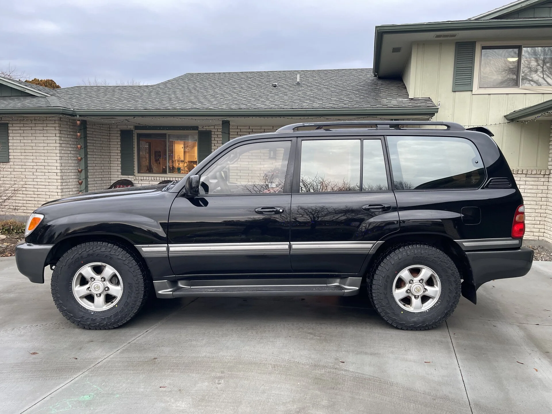

Hi all! Long time lurker and hopefully a future fj40 or fj55 owner. In the meantime, I picked up this beauty a few weeks ago. 2000 with 240k miles. No rust. Lived here in Boise since 2003. Took it to the local shop to get everything baselined and am getting an Ironman foam cell pro 2” lift installed in a few weeks since the current suspension is a bit tired. Already out on new tires as well. Can’t wait to take many adventures with my kids in the new rig we named Phil.
