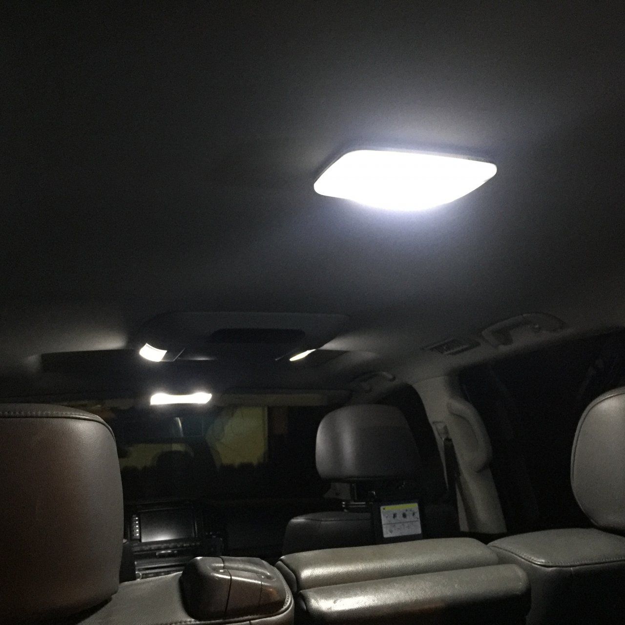

Installed LED interior bulbs - Polarg LED wedge bulbs

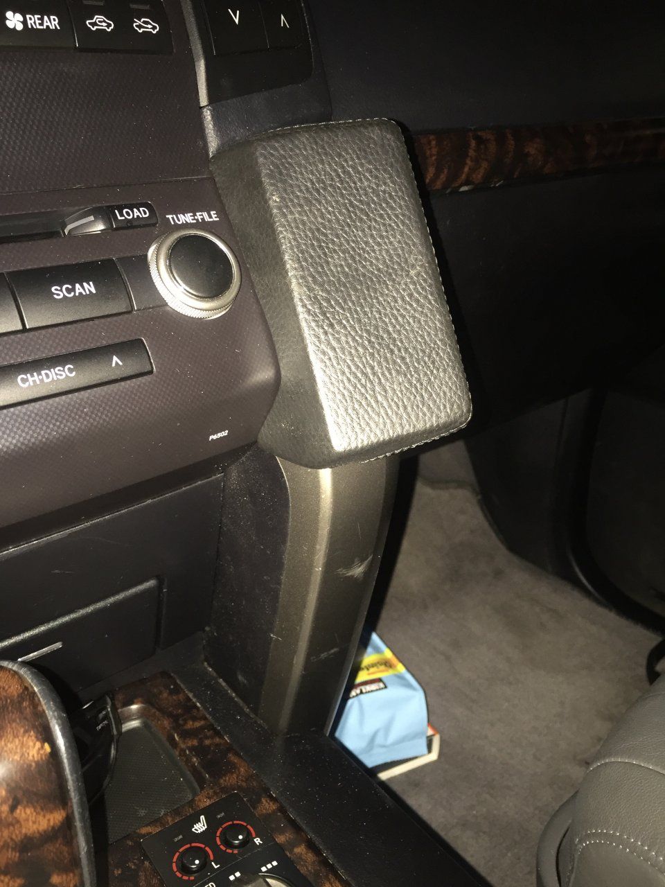

Here is the Kuda cell phone mount. I had to take the entire panel off and ground down the inside to ensure a tighter fit. I would of preferred a solid double sided tape install and not requiring to drill holes and cut panels to fit. Overall great concept.

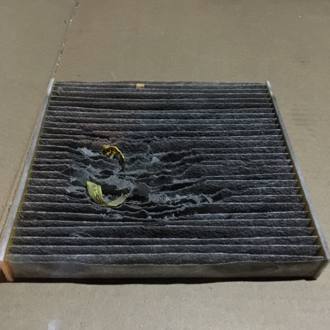

Oh. If you look at the filter the center is carved out. It's what happens when you get a mouse or rat in your car.
The dark color is the charcoal filter Toyota sells. The charcoal is better at elimination odors
Trap for young players: Make sure the ventilation fan is set to "recirculate" before trying to remove the pollen filter or there will be tears.
why is that? just curious as I always have recirculate. Especially since the fires near me in the past few days. Got to fix why the valve is stuck open though (can smell the fires) when stuck on recirc.
attempting to remove the filter while on "fresh air in" almost always results in breakage of the mounting brackets holding the filter. I believe its included as a warning in the owners manual. Lots of guys get caught out by that one. Easy to do but bloody expensive to repair.
I am on that list. Did it first 2 weeks of ownership.

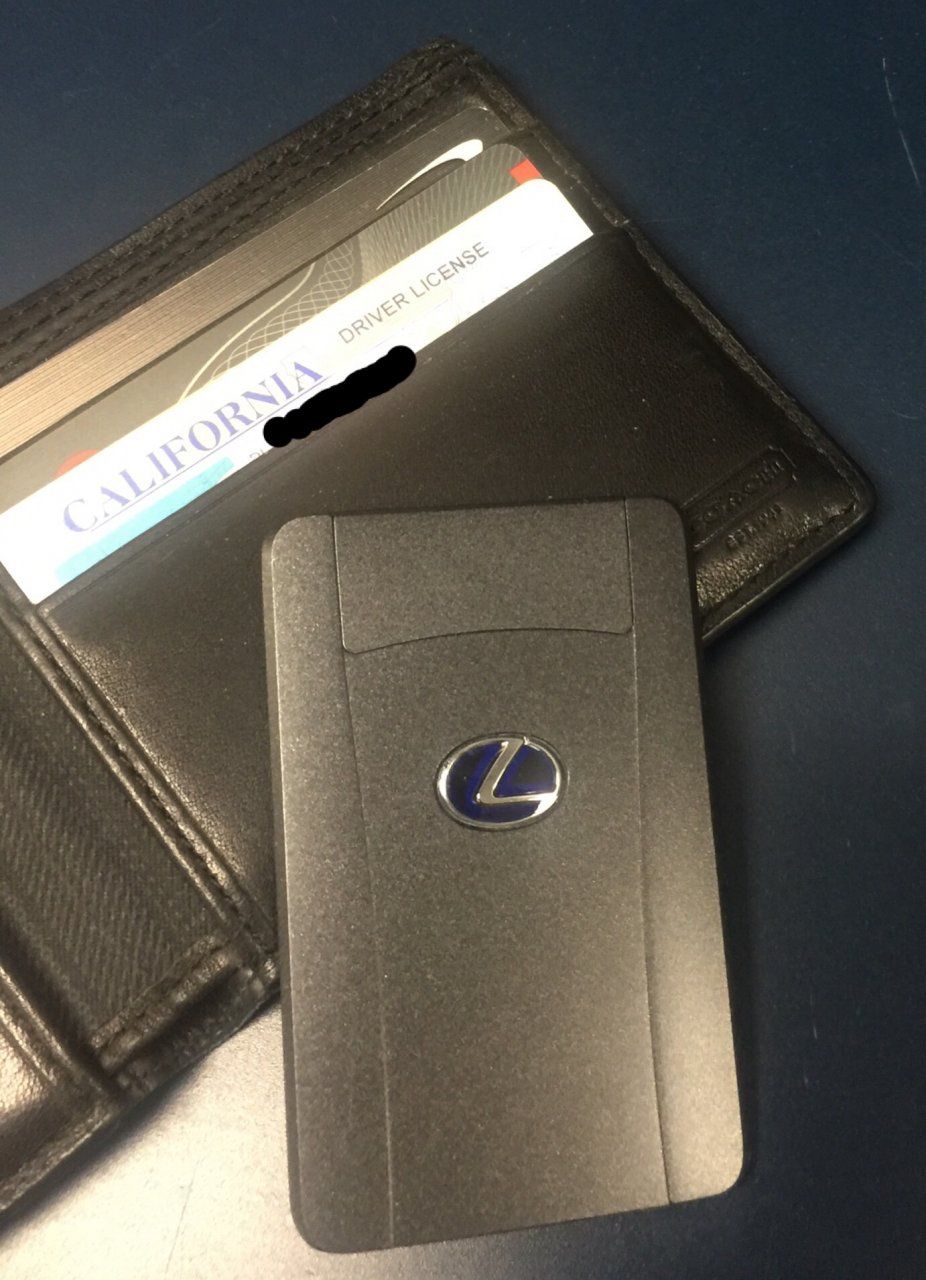

Here is the Lexus Card key that replaces my key fob. Can't use the remote start but I don't think I would ever use it anyway. Prefer the card so I just need to make sure I have my wallet.
What is FCC ID of your Toyota Key fob? What is the FCC ID of the Lexus Smart Credit Card key that is compatible with your Toyota Key fob?

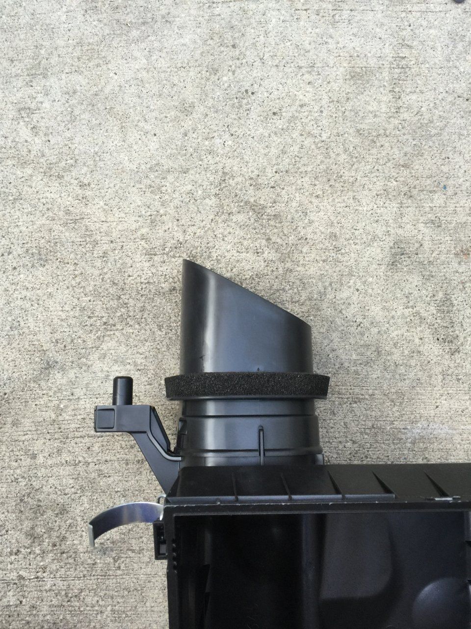

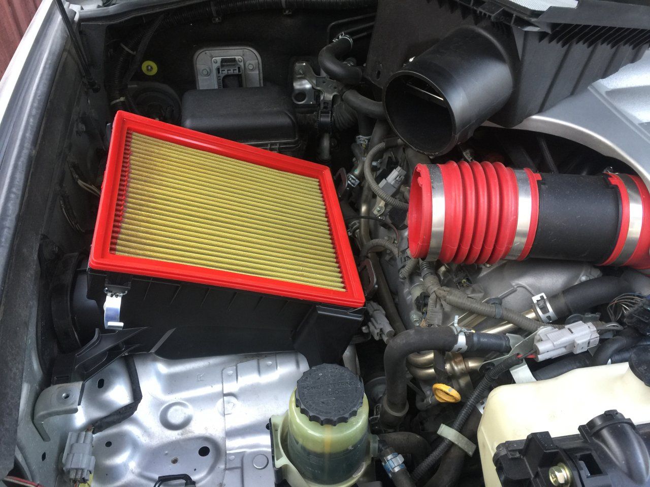

Because I like challenges I found a new TRD intake on Craigslist for $250 and purchased the matching lower intake box. Some minor mods but basically bolt on.
Cut off that pin, and removed the scoop to reuse the one bolted to the land cruiser.
added a piece of foam to the lower intake where the scoop attached.
everything else bolts right up and it's pretty much a drop in.
