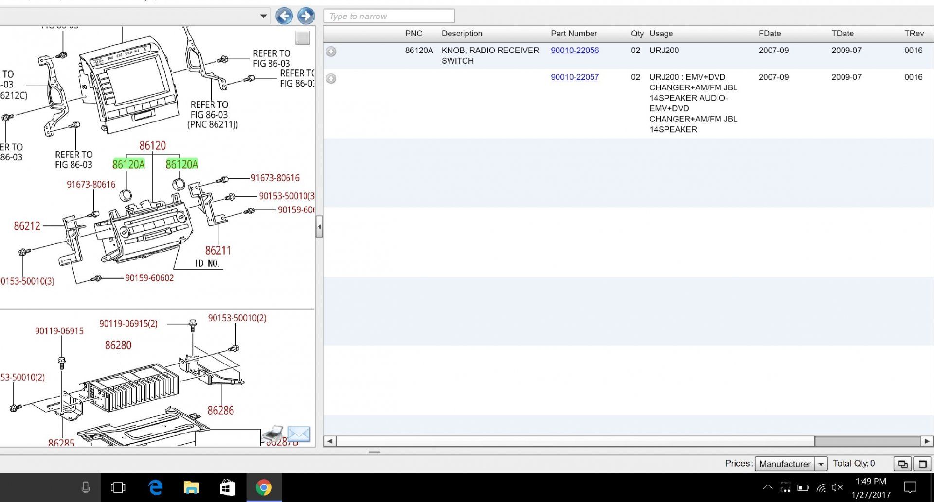

@NetJunky Where did you find the replacement rear entertainment knobs?
knob info
