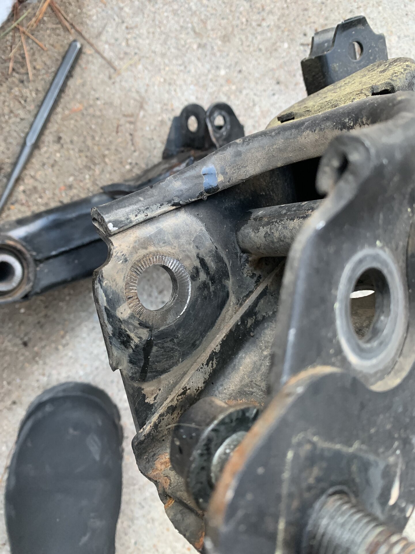

This time at 70-75 mph, only on some roads mind you, there is a very definite front end shake or vibration. Slowing down it goes away and even accelerating can smooth it out. The bull bar is bouncing very rhythmically, antenna swaying and steering wheel is shaking. I don’t think it’s the road and even if it was, it should be absorbed.
Today I removed the front drive shaft and went for a test drive and it didn’t make a big difference. It was fun driving without the front drive tho.
I’m afraid it’s looking like those front LCA bushings need to be replaced. Steering rack is new, shocks are newish, sway bar bushings are new-enough.
I also noticed today that this last weekends trip to Flag and the fire roads around there tore an inner CV boot so I’ll be doing that while I have the front disassembled. I’m not too upset, it’s a 22 year old boot with 224k miles.
