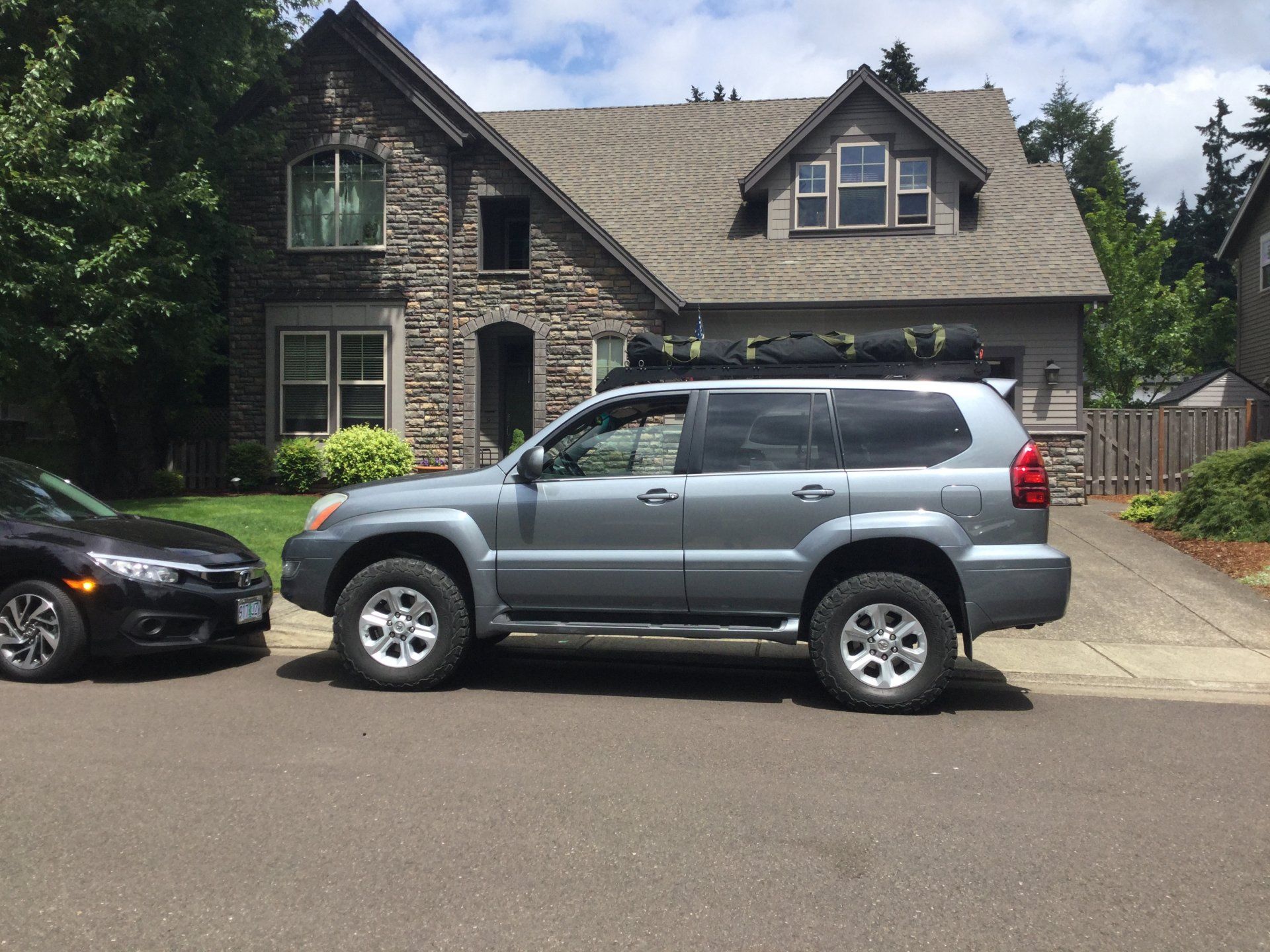

Pic is with an Ironman Nitro lift, 2.5”, but the tire/wheel combo fit before I lifted the GX.

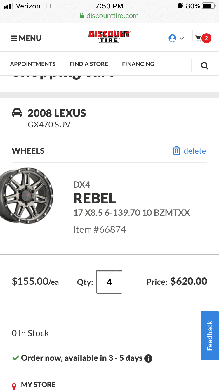

I think I’ve settled on these:

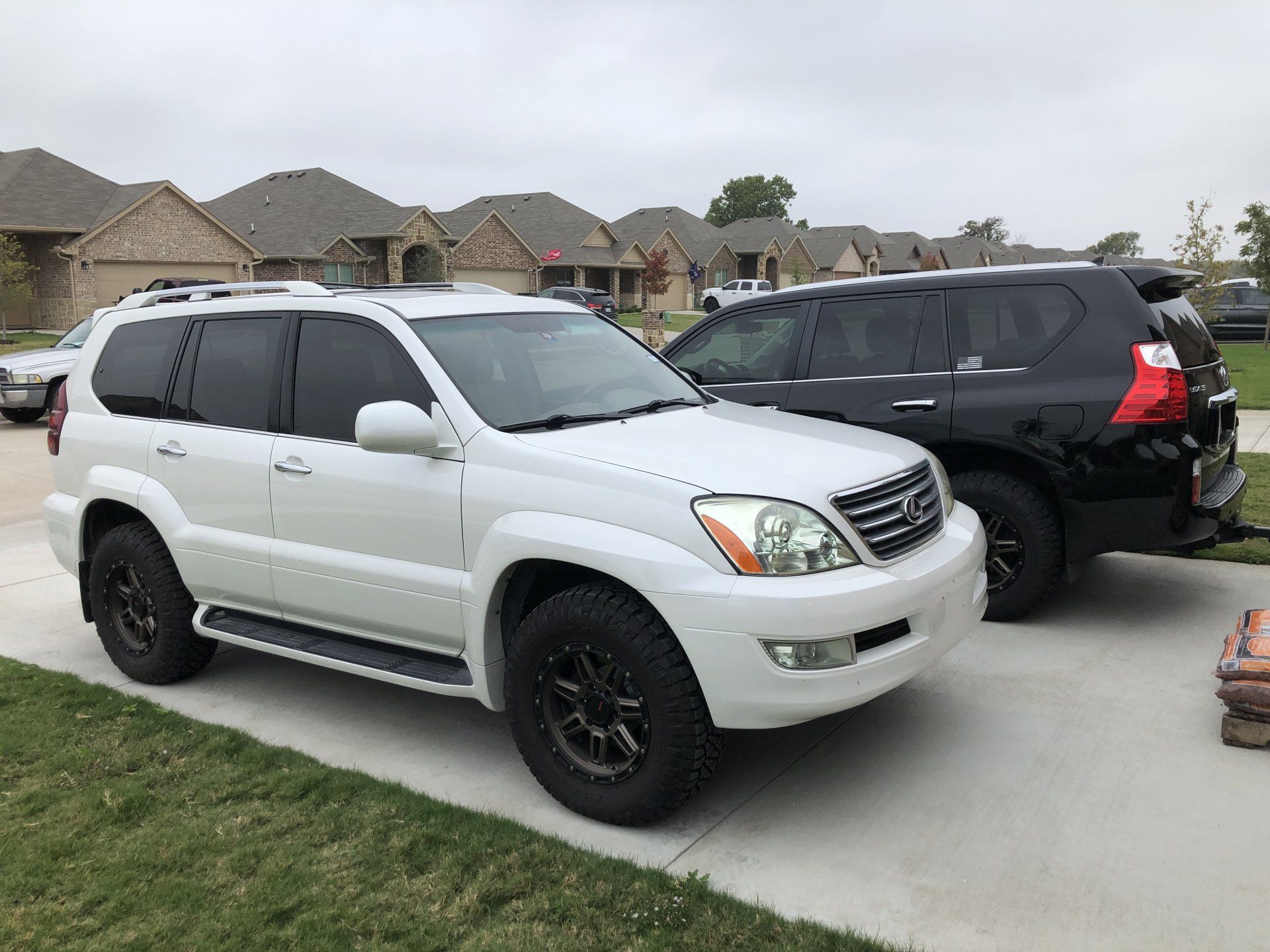

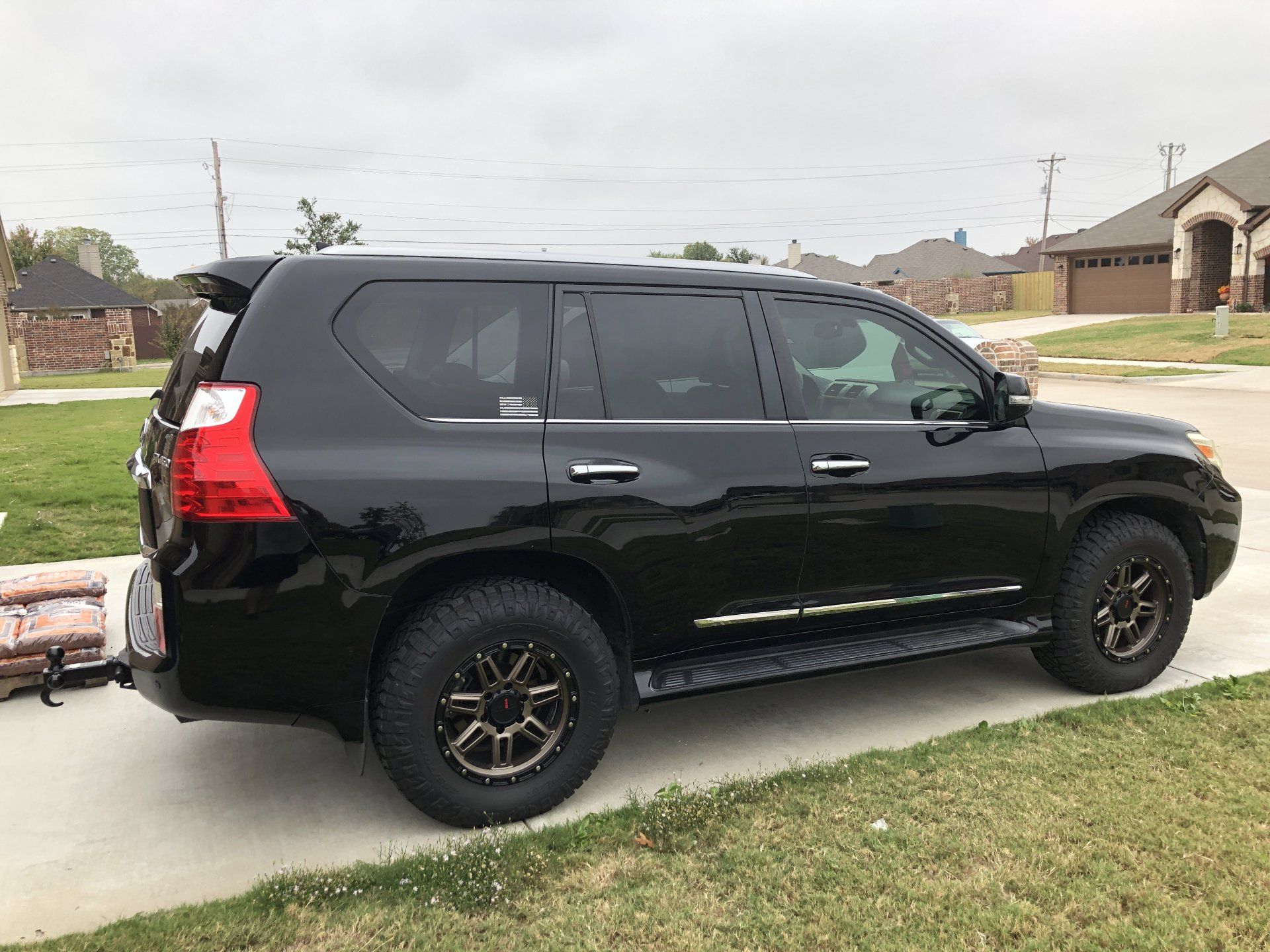

Below the latest pics I just took To answer your Q’s...
Comfort, quite good actually. Still got that wonderfully good Lexus ride.
Mileage, I saw no drop in mileage from my Goodyear Wrangler SR-A street tires versus the Ridge Grapplers.
Grip, is excellent. I took some sharp corners spiritedly and was pleasantly surprised this big ass tank carved ‘em up. I am legit surprised and how well it handles for its size.
Rubbing, sadly I rub but only under nose dive braking/turning and such. I want a lift and maybe a small spacer to solve the problem. Perhaps a 255/75/17 might be a better choice versus the 265/70/17 I chose to stop rubbing? Fun fact, have the exact same wheels and tires on our ‘08 470 and there is ZERO rubbing.
Bonus, braking performance and heavy rain performance are pretty good. Better than I was expecting.
Would be happy to answer any other questions.
Sorry pics added.
