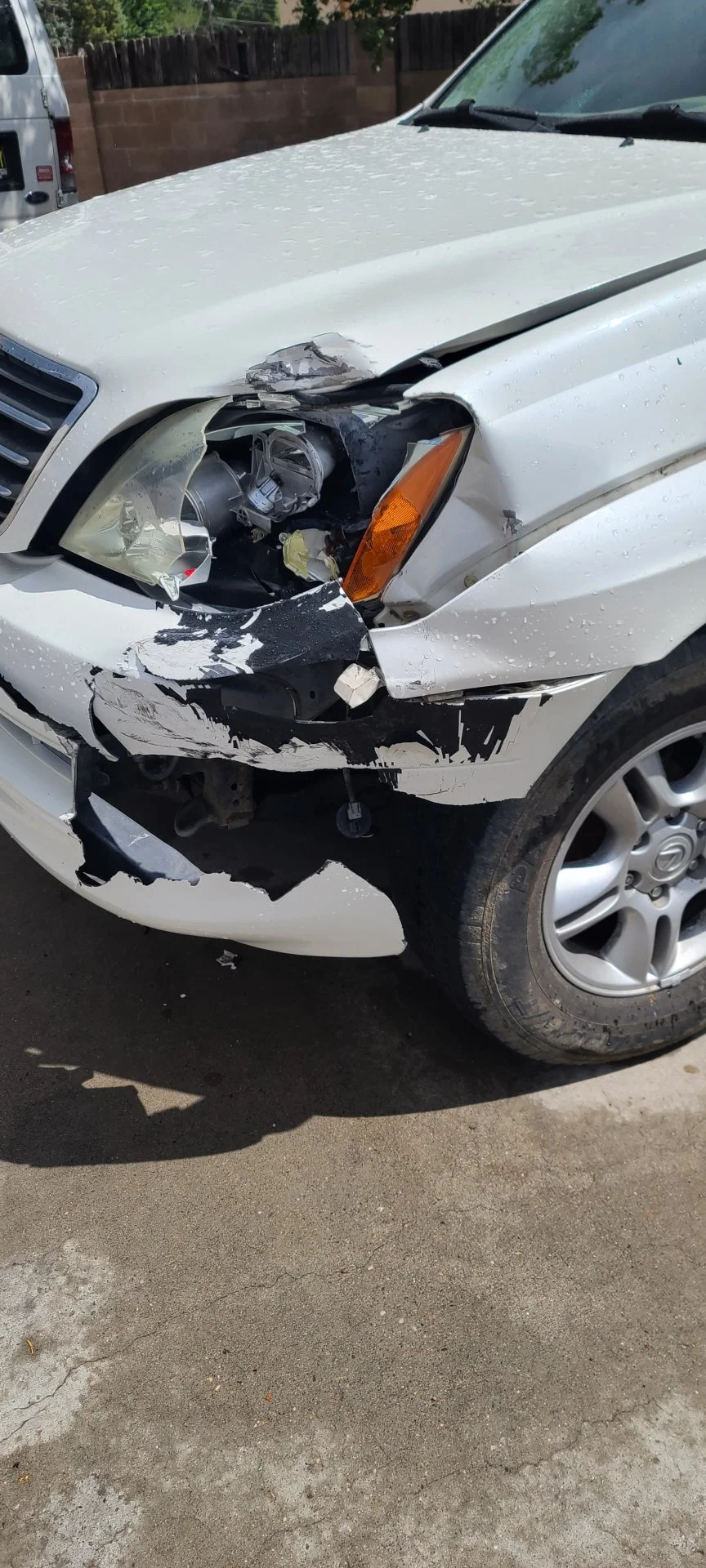

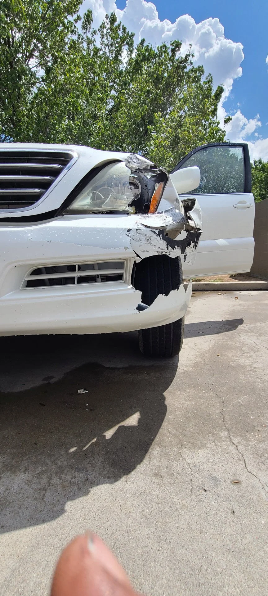

Afternoon! Unfortunately I wrecked my 07 GX, 200K, fresh timing, windshield, and airbags (although with the lift they will be deleted) I'm curious if any of you have replaced the inner fender apron? Looks to be tack welded any tips or tricks I should know before tearing into this? Also any experience with ordering parts with good fitment will be appreciated also! TIA

With the damage being that bad, it's probably something I'd take to a body shop. They are going to need to pull/straighten/rebuild the front core support in order to salvage it, as it looked like the whole front end is tweaked. I would say this is easily $4K+ in work, but it would be done right and you'd have good panel alignment after the fact.
Otherwise, if you have the ability to drill our and re-weld spot welds and get things lined up....which often requires hydraulic jacks and come-a-longs....maybe try to find a white GX in a salvage yard somewhere, as it's a common color, and take all of the parts for yours.

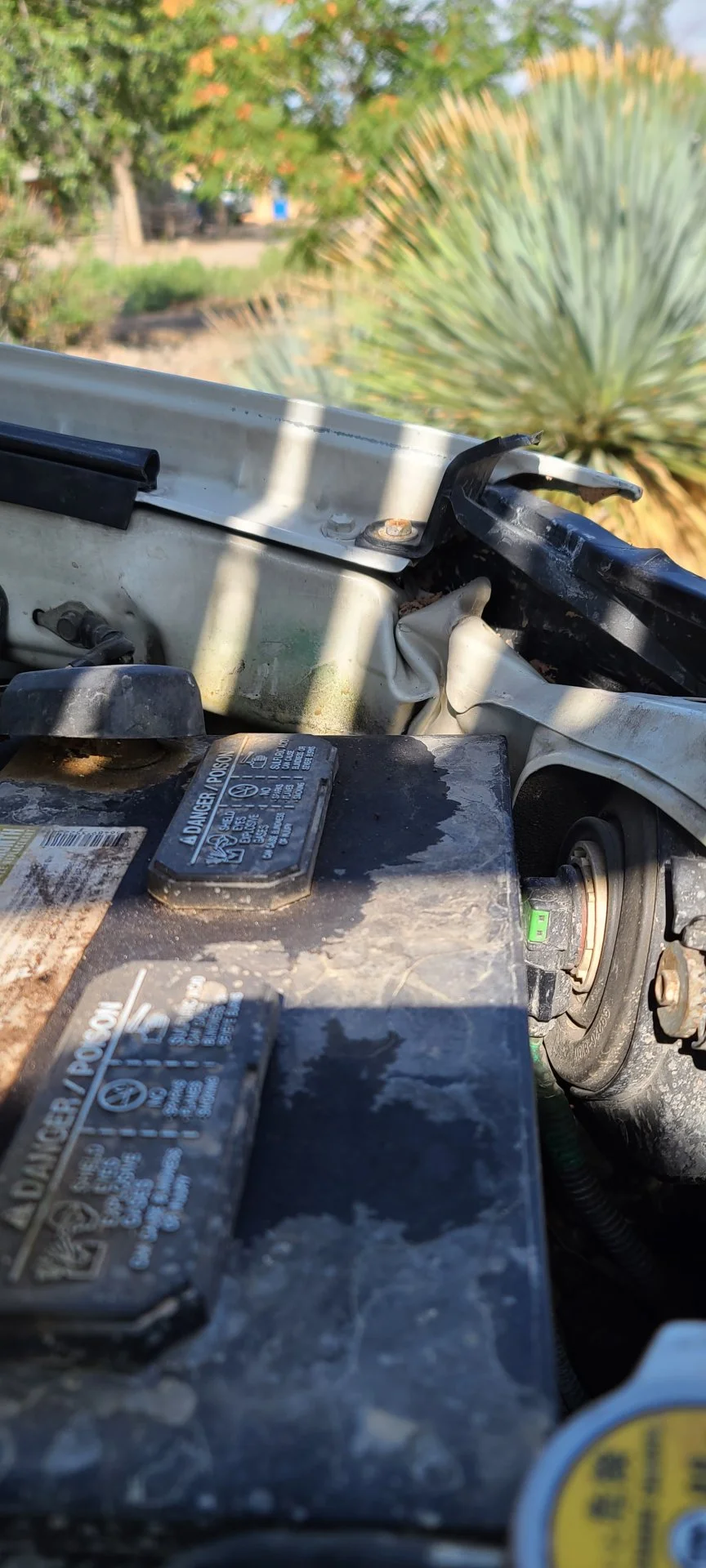

I wanna go aftermarket bumper for sure the issue is insurance totaled it out, and I bought it back so the repairs are up to me, looks like inner apron and core support at minimum, plus exterior stuff shown. No leaking fluids no misalignment at all.

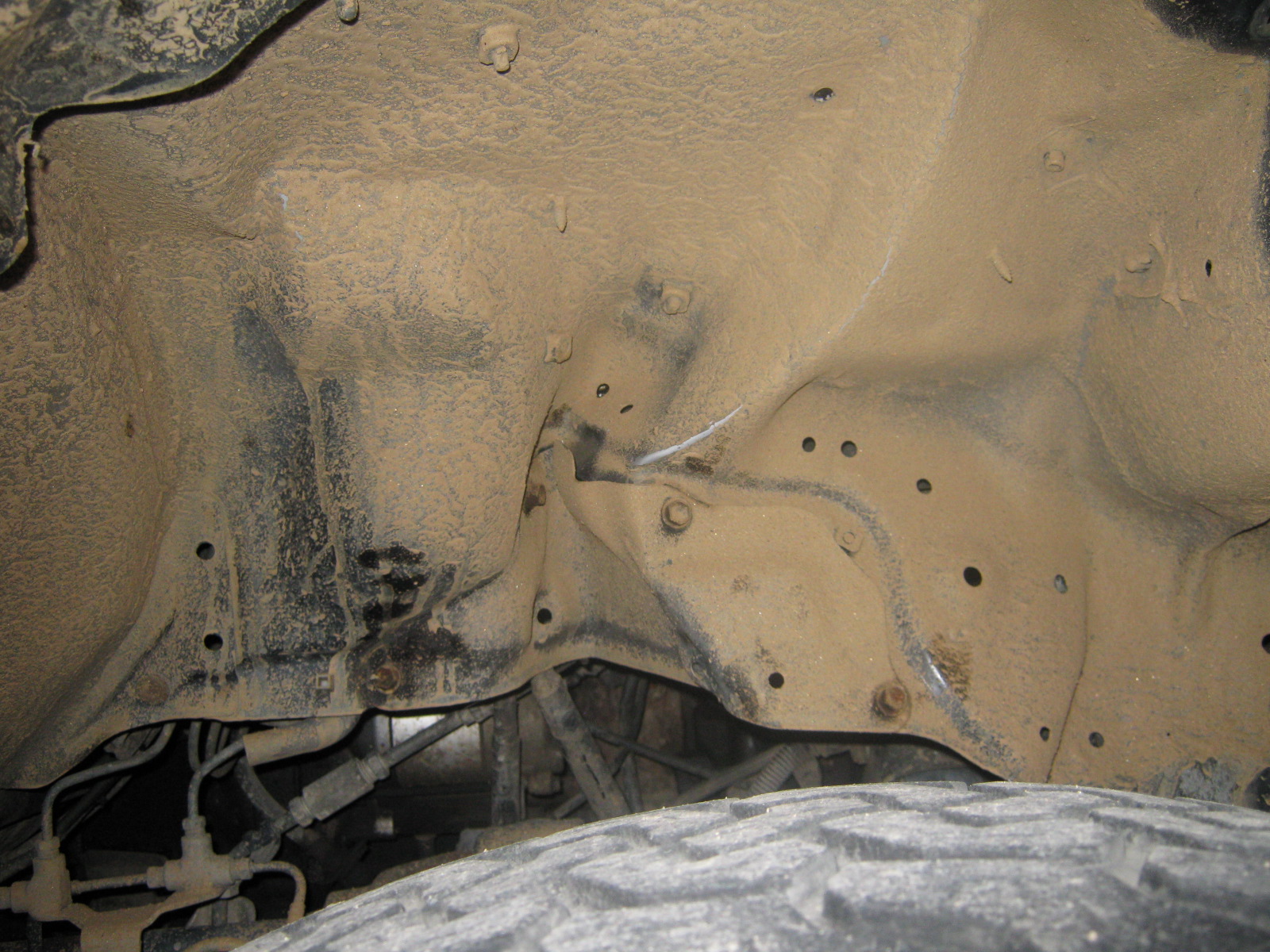

You might try stretching the inner fender/apron back out. You could even leave (some) of the outer fender attached to give it more strength when you pull on it. You have little to lose - chock the wheels, attach a come-along to it, and yank, using your F350 or a power pole as an anchor point. As Rednexus said, a sympathetic body shop might do some of the pulling for you, and leave you the cosmetics.

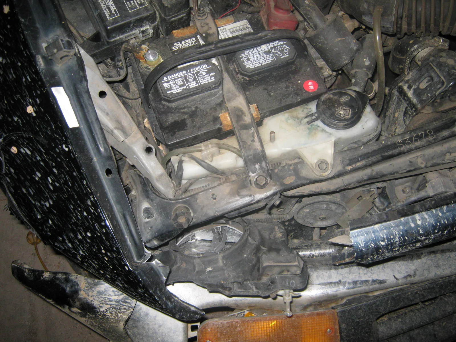

The problem with stretching inner fenders back (as I discovered on a '95 4Runner with a similar hit) is that it's hard to grab the metal and not have it tear when you apply force. There are special purpose clamps made for this, or you can use the old fender, blocks of wood, and other hillbilly methods. When I finished with the 4Runner, the body fit on the outside was flawless and the inner fender, while wrinkled and straightened, was hidden by the battery and did not scream 'redneck fix'. I even found junkyard body-color parts, so the dings and chips matched all over the truck perfectly.
Be VERY careful about cutting through things with a Sawzall - I cut through the top radiator shell cross member on a '99 Camry and then discovered, um.... wiring that Toyota ran inside the area I cut. Fortunately, it wasn't shielded wiring, so I could repair it, but I felt like a dolt.

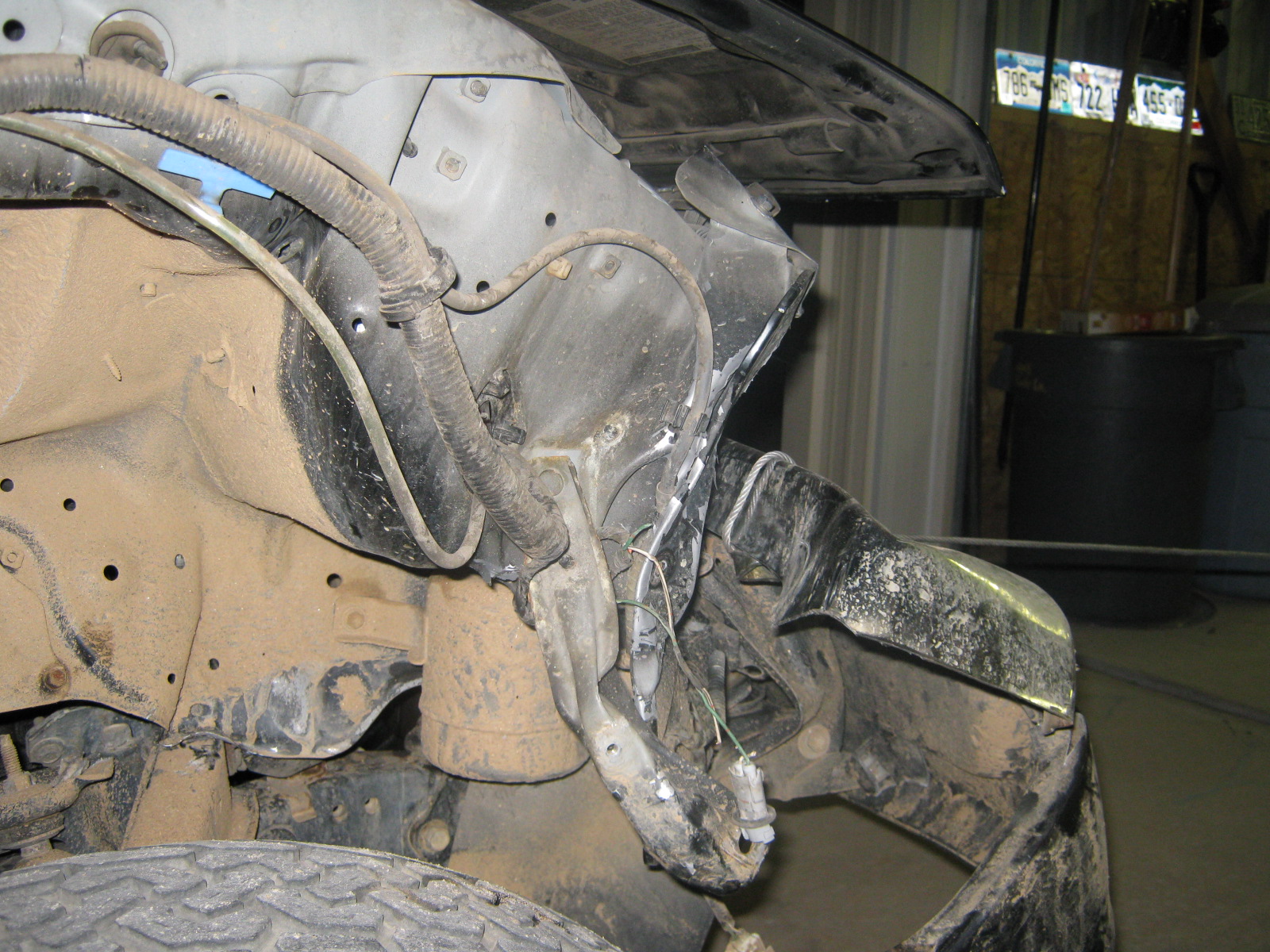

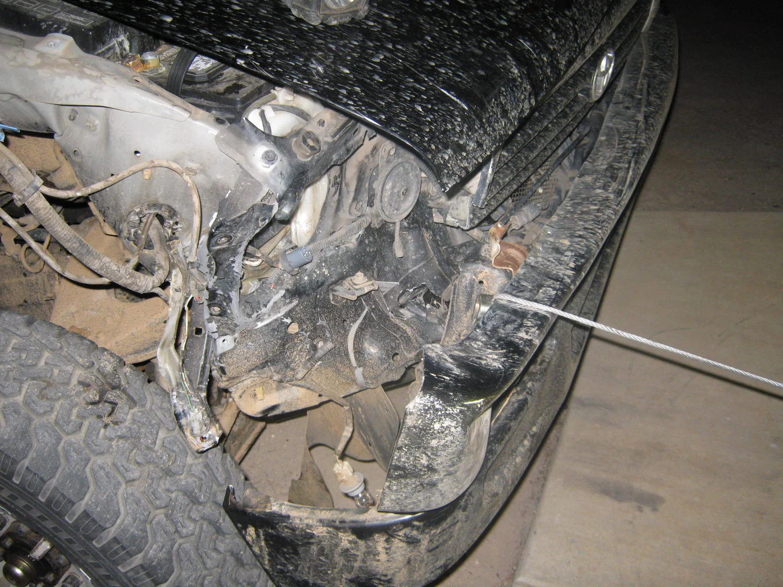

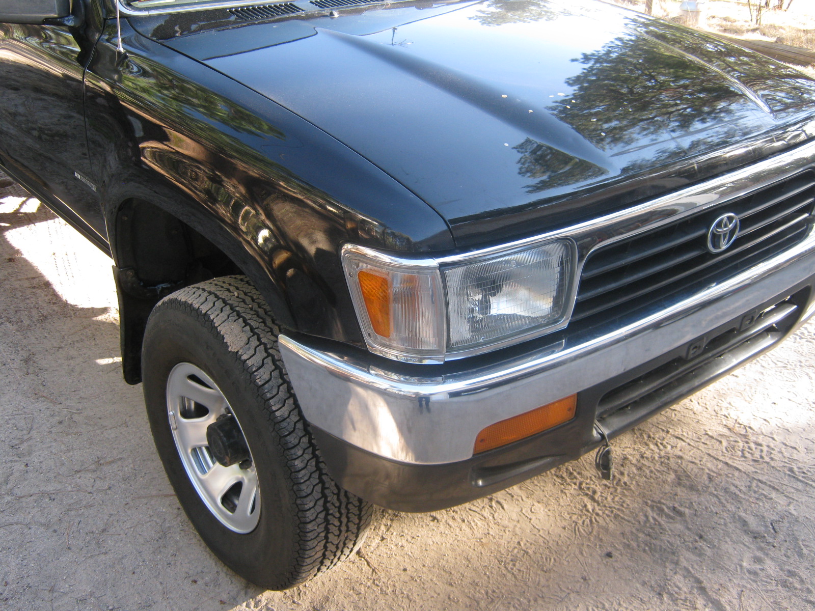

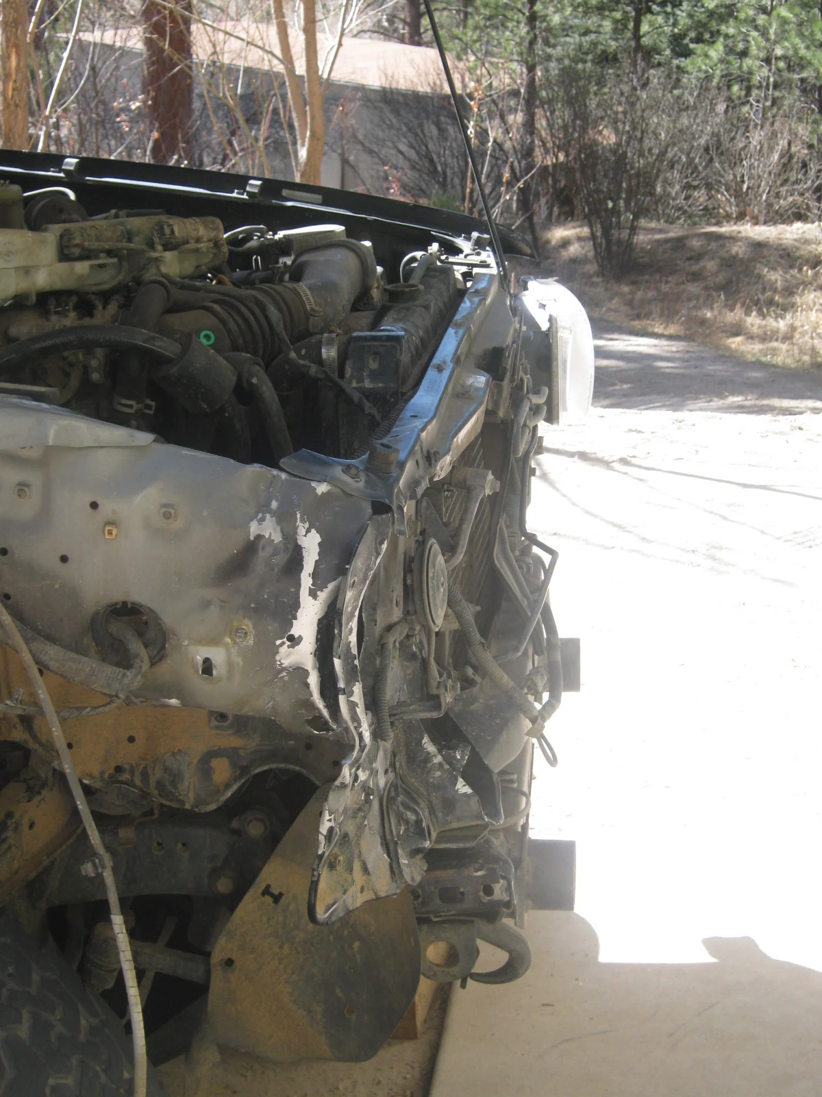

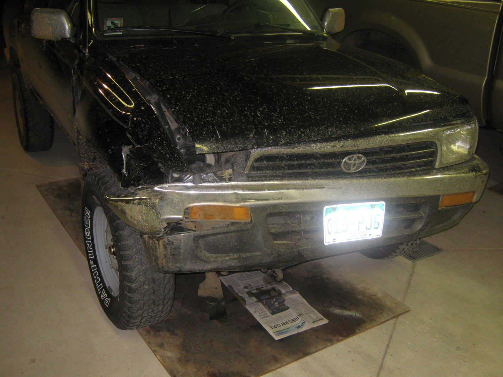

Some inspiration for you. All done in my driveway with a come-along, Toyota bottle jack and blocks of wood, c-clamps, etc. Body parts were sourced from a junkyard.

Well I appreciate the input for sure, however before I posted this straightening wasn't an option I was gonna drill and replace apron, core support. I was looking for oem parts. I've looked deeply into it and yea gonna gonna replace the core support for sure, inner apron probably gonna heat and stretch. I didn't ask the forum for tips on frame work I asked the forum about locating parts.
