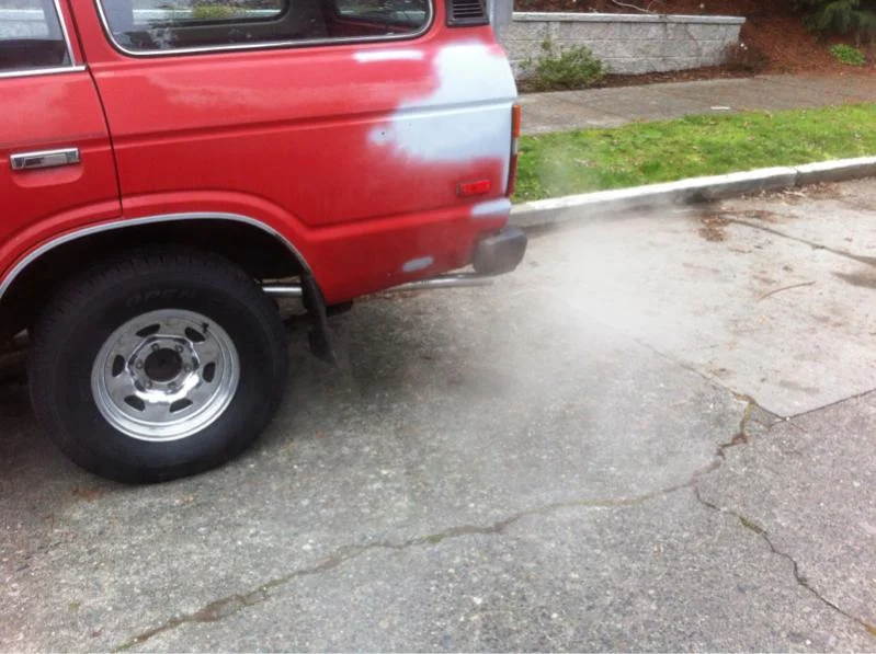

I'm re-repairing a botched bit of bodywork on the rear quarter panel of my 62. Almost all the paint on the truck is original, with a nice rock chip patina on leading edges. A thorough compounding brought out the original red beautifully, and it's now a 10-foot looker, as it should be. No more resto planned.
The only place the paint is not original is in this previously repaired area, which was poorly 2-staged with some crappy clearcoat that is now crazed and flaking. Since I had to chisel away 1/4" of Bondo under the repair, I'm going to respray that whole area.
Question is what to use. I'm more comfortable with single-stage, and I'm not after a concours finish. After removing oxidation from the undamaged panels, the photo spectrometer says it's a 7/10 match to the factory shade. Not bad for 24 years, so I just need a reliable color match to Toyota 3F4 and a good, durable paint I can blend in. I live in Seattle, so sun/heat wear is not an issue. I have HVLP spraying equipment and experience using it with PPG finishes. Only reason not to go with their products is the price I was quoted: $175 for a urethane pint kit.
Any recommendations?
Nope? Nothin'?
You may be better off sanding and painting the entire quarter, rather than trying to blend. You could use the Omni line of PPG paints. The MTK is a decent urethane paint that will outlast your existing finish. I wouldn't want to use a really high quality finish to touch up 24 year old paint.
