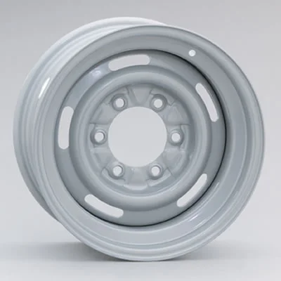

Bored here at my house thanks Tropical Storm Fay... found this steel rim , due to stock steel rims disc type are every day hard to find.... what did you guys think on this one,have the correct backspacing . Opinion will be appreciate :D
Wheel Vintiques 35-5606334 - Wheel Vintiques 35 Series Silver Pre-1971 Pickup Rallye Wheels - summitracing.com
I´m planning to use LTB 34x10.50x15 with 4 " lift.
Those would look great and the price isn't bad; however a 6" wide wheel, while certainly feasible, is a little narrow for a 10.5" wide tire IMHO. I believe late FJ40, FJ60 & 62 wheels are 15x7(correct me if I'm wrong) and have the proper backspacing. Cruiser Solutions sells some nice looking steelies in 15x8 with the correct backspacing but they're a bit steep at $75 a pop. Check out Stockton Wheel, they may have something that will work; Custom Wheels - Stockton Wheel Service
Last night i sent an email asking for price( Stockton's wheels), for the series 20 steel rims...frank that work for them, reply with price $145.00 ea. plus ride. But those on summit you can choose the wide that serve better for your tire option. I have few pictures of members here using the swamper Q78-15 on 40 steel rims, or Ltb 34. My preference still for skinny and tall tires and i dont know much about cruisers,but a 8 inch rim will look good also.
Cruiser hubcap wheels are 5.5" and the wagons are 6". The wagons are not that hard to find cheap and would be ok with the right 10.5" tire. Swampers are narrow. MT TAs would be ok too. AT TAs in 10.5 should go on 7" rims IMO.

Not a bad looking rim, and not a bad price either. I'm with Gus tho: a 7" rim would be a better choice than a 6.
You take a 6 when you're trying to stay with original Toyota. Otherwise, the 7 is a better fit [offset] and will give you more choices for using other tires down the road [when you decide the LTB's are too noisy!]

Sorry for re-opening an old thread, but has anyone looked at the Wheel Vintiques 66 series wheels for a Cruiser?
The backspacing would require a wheel spacer, but comes in 16 and 17 inch sizes. I would like to know if the FJ40 hub caps would fit other than it needs the clips to hold them in place. Anyone know if you can buy those or just have to use them from a stock set of wheels?

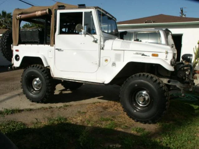

are those LTB's on 15x5.5's ? I was thinking of buyn another set of rims off Ebay an puttn those exact tires on'em ..they look like swamper LTB's..i have 15x5.5 with 33x10.5 BFG Muddrs

What's up, Nick? I just hung with Anwar for a couple of weeks at Benning. YOur 40 looks good. Stay safe...
