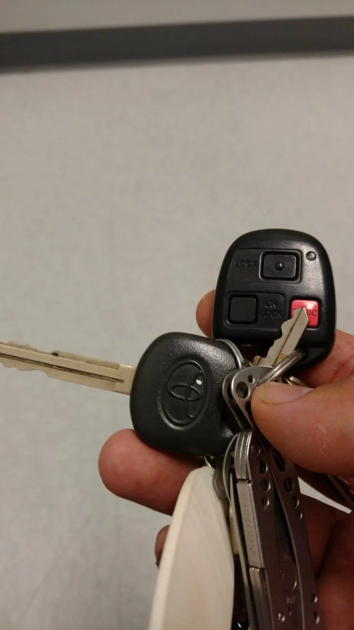

This is what I was talking about.
I currently have a Toyota transponder key and use the broken one as a separate FOB.

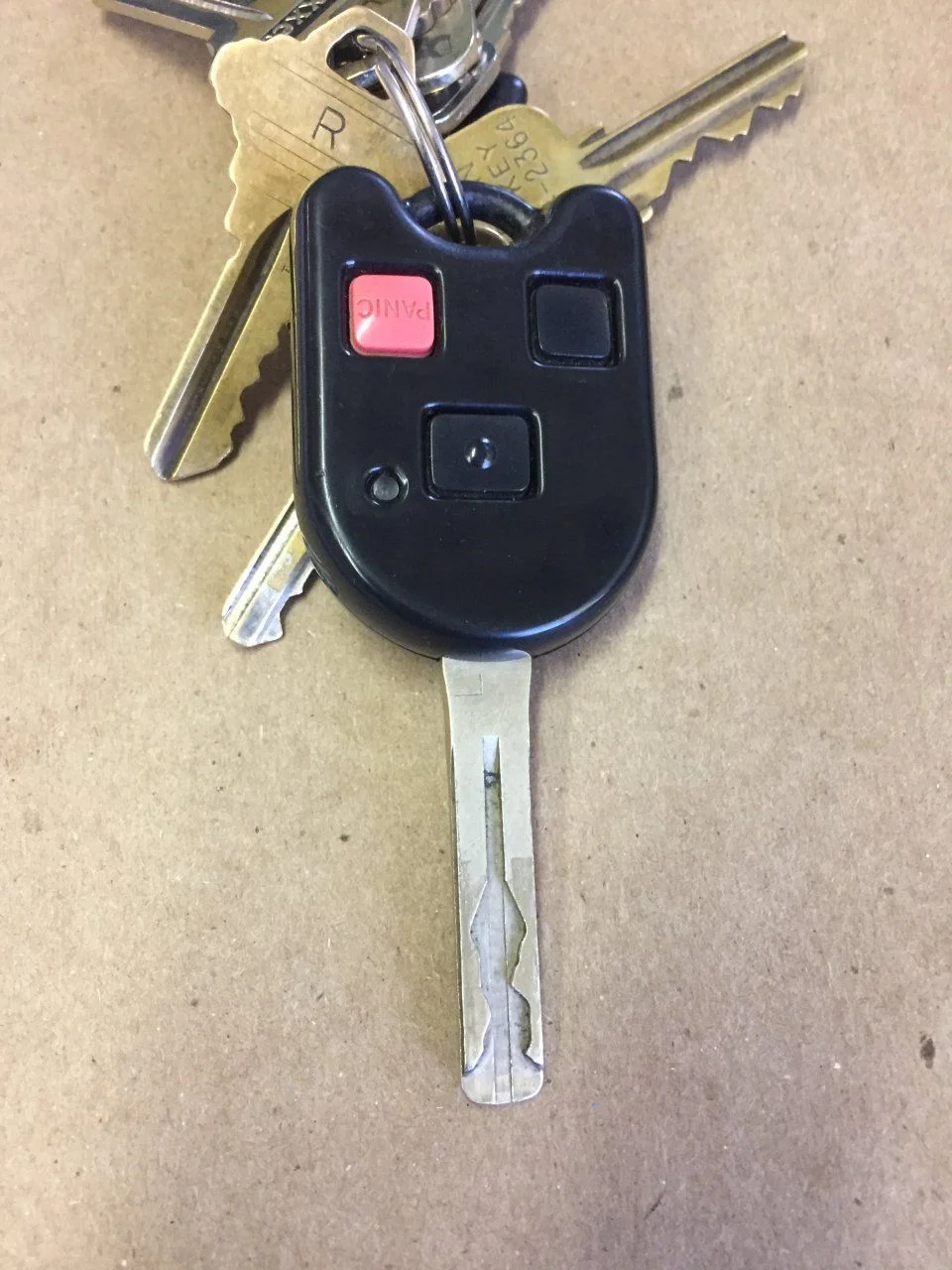

This worked perfectly. No need to cut a new key, because you reuse the key blade from the old key and transfer the transponder. You can find them on Amazon for $10 and it's made by Stauber. You will need the rounded shell.
View attachment 1381597 This worked perfectly. No need to cut a new key, because you reuse the key blade from the old key and transfer the transponder. You can find them on Amazon for $10 and it's made by Stauber. You will need the rounded shell.
I can't find the round shell version. Have you seen one?
