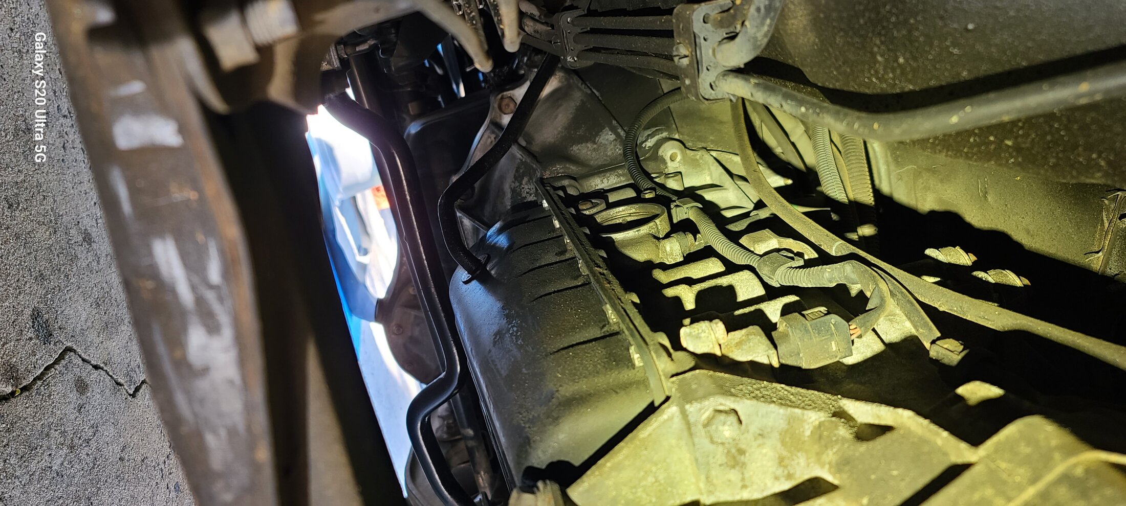

If you have the truck where you can work on it, remove the shift solenoid wire connector and try to shift the transmission into 1st (L) gear. If you can, the problem is with the ECM/TCM control. If you can't, the problem is in the transmission.
Without knowing which it is, I can't give you any more help.
I apologize, my camera has a mind of its own. This is the driver's side of the transmission. The connector ^ is the only one on this side.
Skill take a Pic and post it
