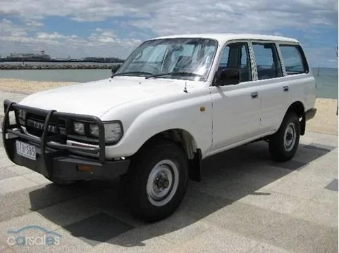

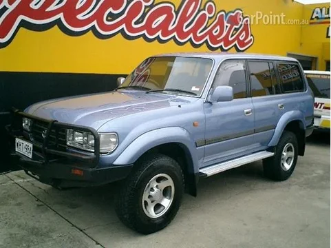

I've got a 92 FJ80, I really want the HDJ80 headlights in it. I'm trying to find a way to get a pair, but I'm not sure what you pros call them. I have a friend that goes to Japan once a month and is willing to hunt down what I want, if I know what to ask for. Any part numbers or tips will help. Thanks.
What exactly do you mean by HDJ headlights? I have the original JDM lights in my truck and they look exactly the same as the North American ones, just with a different beam pattern.
Do you mean the quad style headlights with four separate square reflectors and lenses?
Marlin aussie edition with the lights he's talking about

I mean the ones like the picture, with four separate lights.
Trucks shown are from AU. Don't know if Japan has them.
Sent from my hawn finga using IH8MUD
JDM 80's have an H4 low/hi beam and an H1 fog light (inside) with a yellow bulb cover. Of course they are a RHD beam pattern. Those quad lights are from other markets, such as Australia, Africa, and more.
They called quad lights. They never where offered in Japan. Pm Me if you want a set. I can get you a full brand new set.
