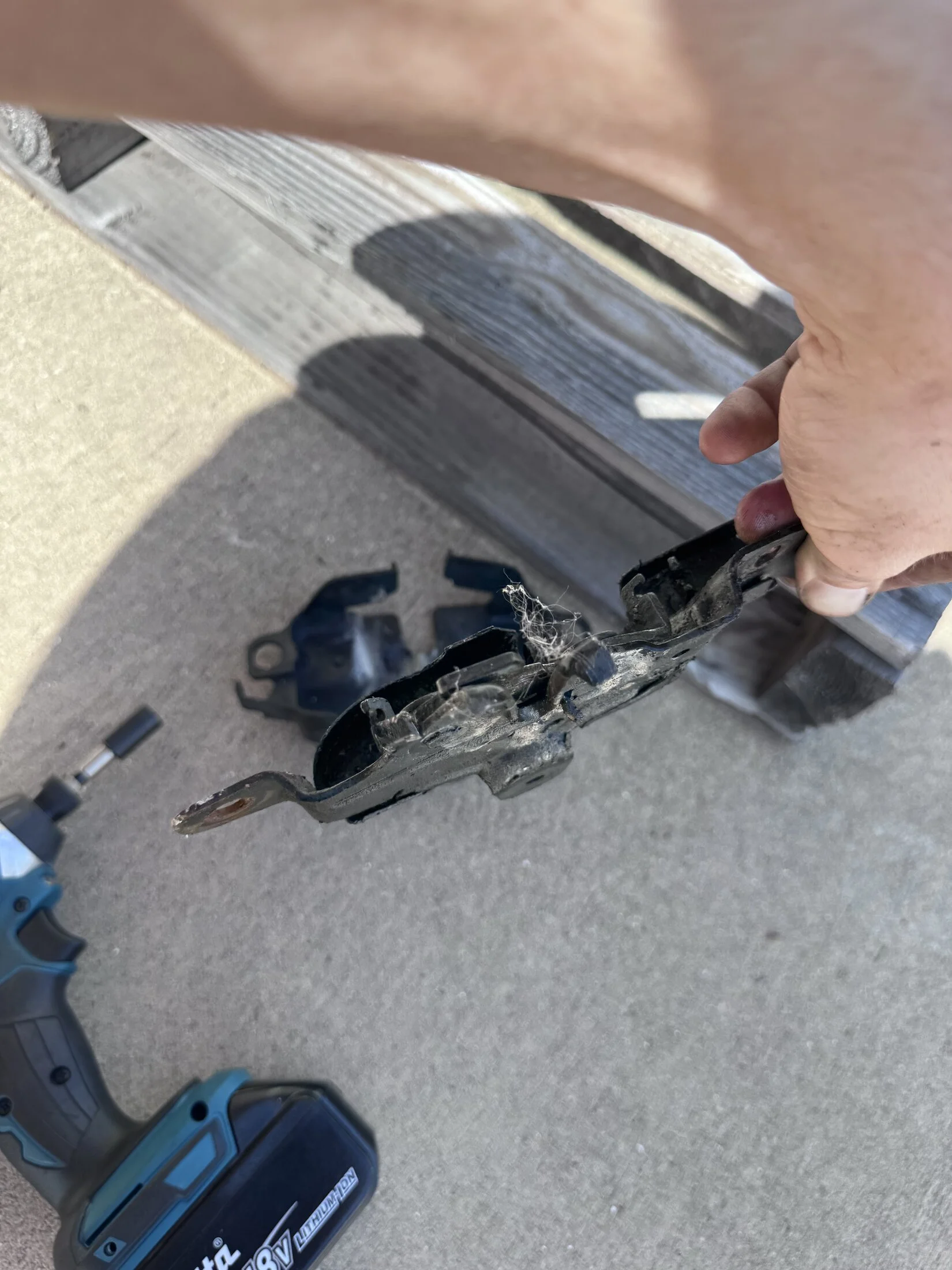

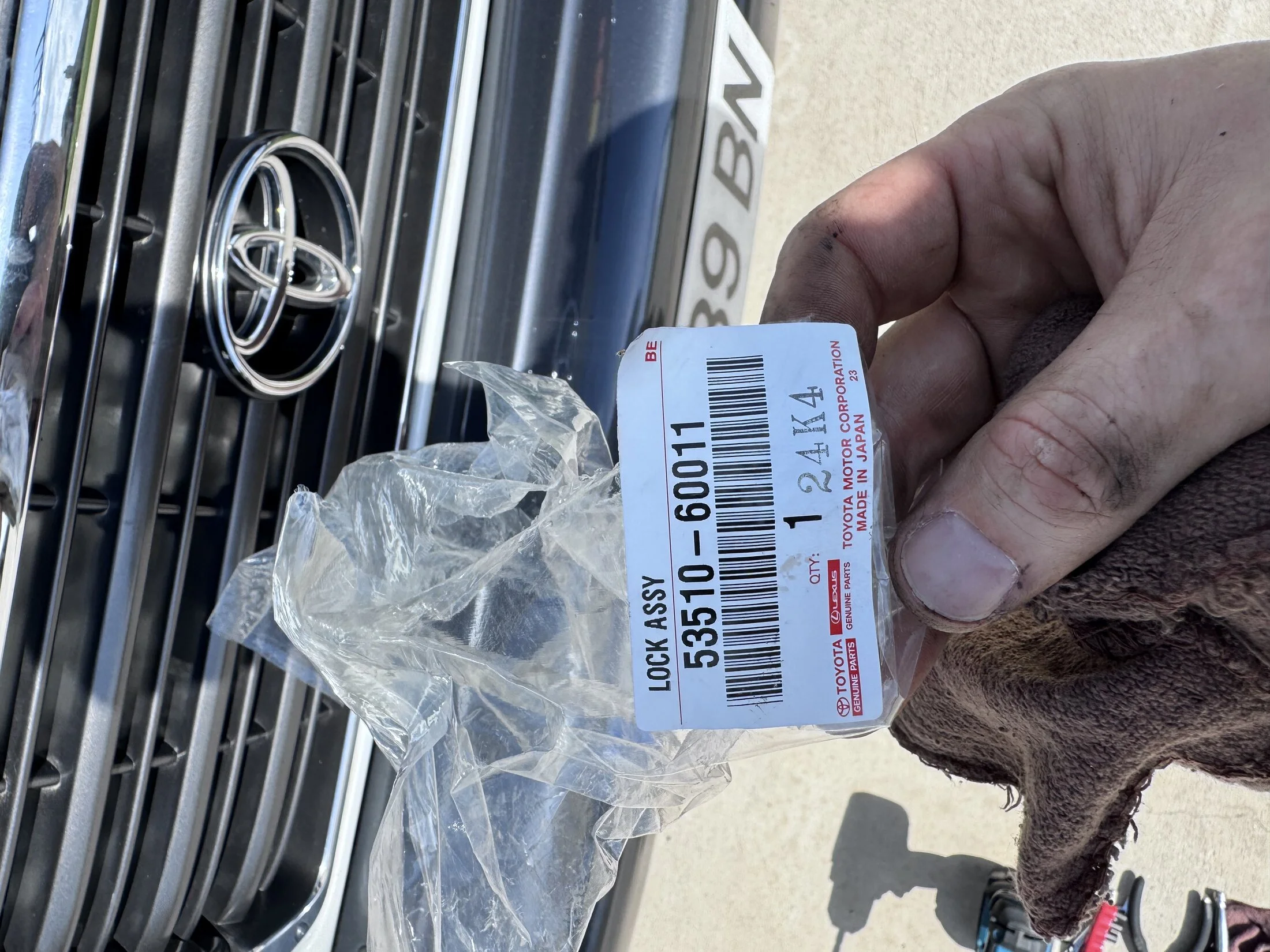

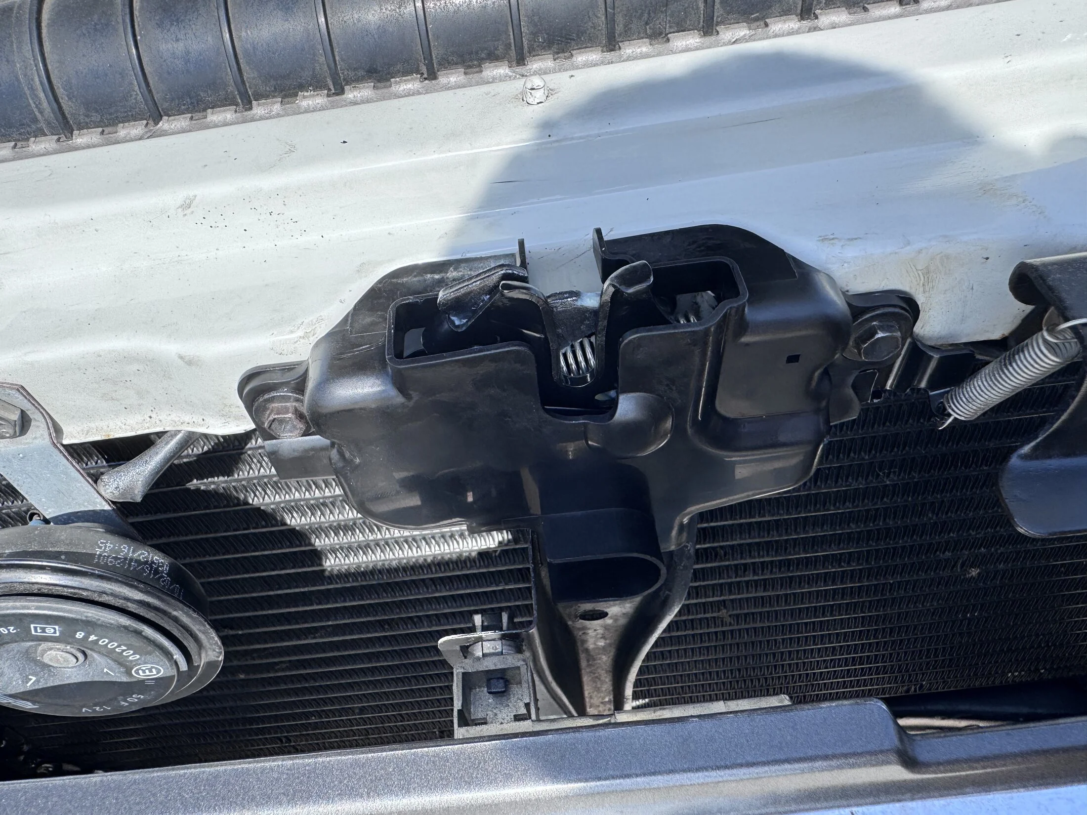

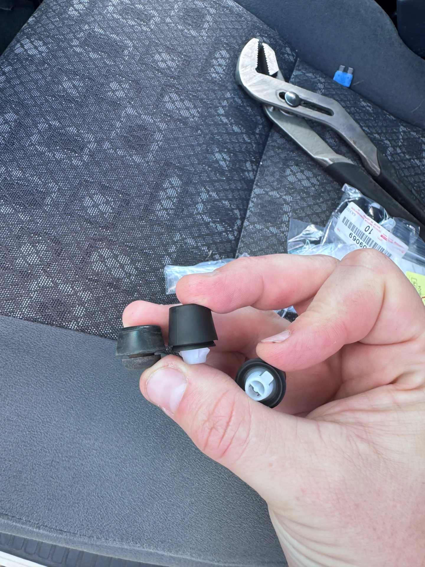

Ended up changing out the hood latch mechanism. When I received the truck it wasn’t staying latched so I cleaned the hell out of it but when I did I noticed it was tweaked and must have been hammered on at some point. I added to the hammering trying to bend it back into position and it held for a few days until I got the new unit
Unfortunately there were a few cross threaded fasteners that were so bad I had to go up a size for the new fasteners. Everything is installed correctly now and holding together well

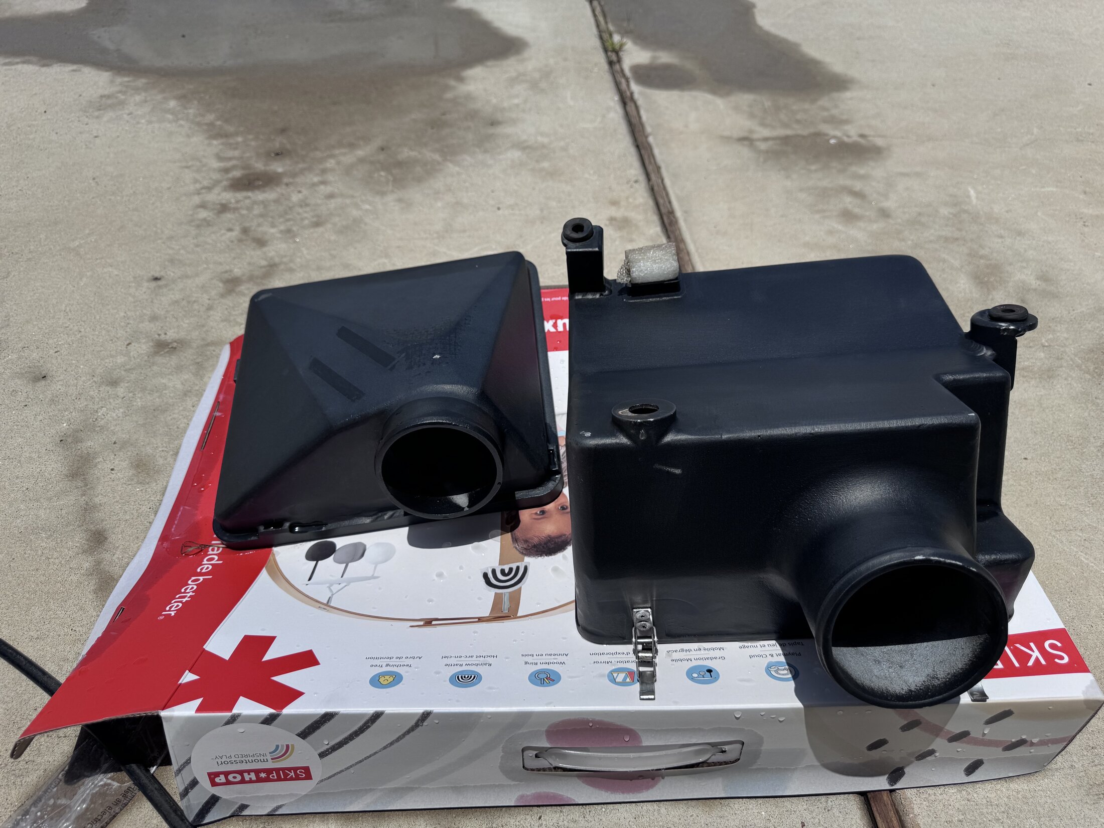

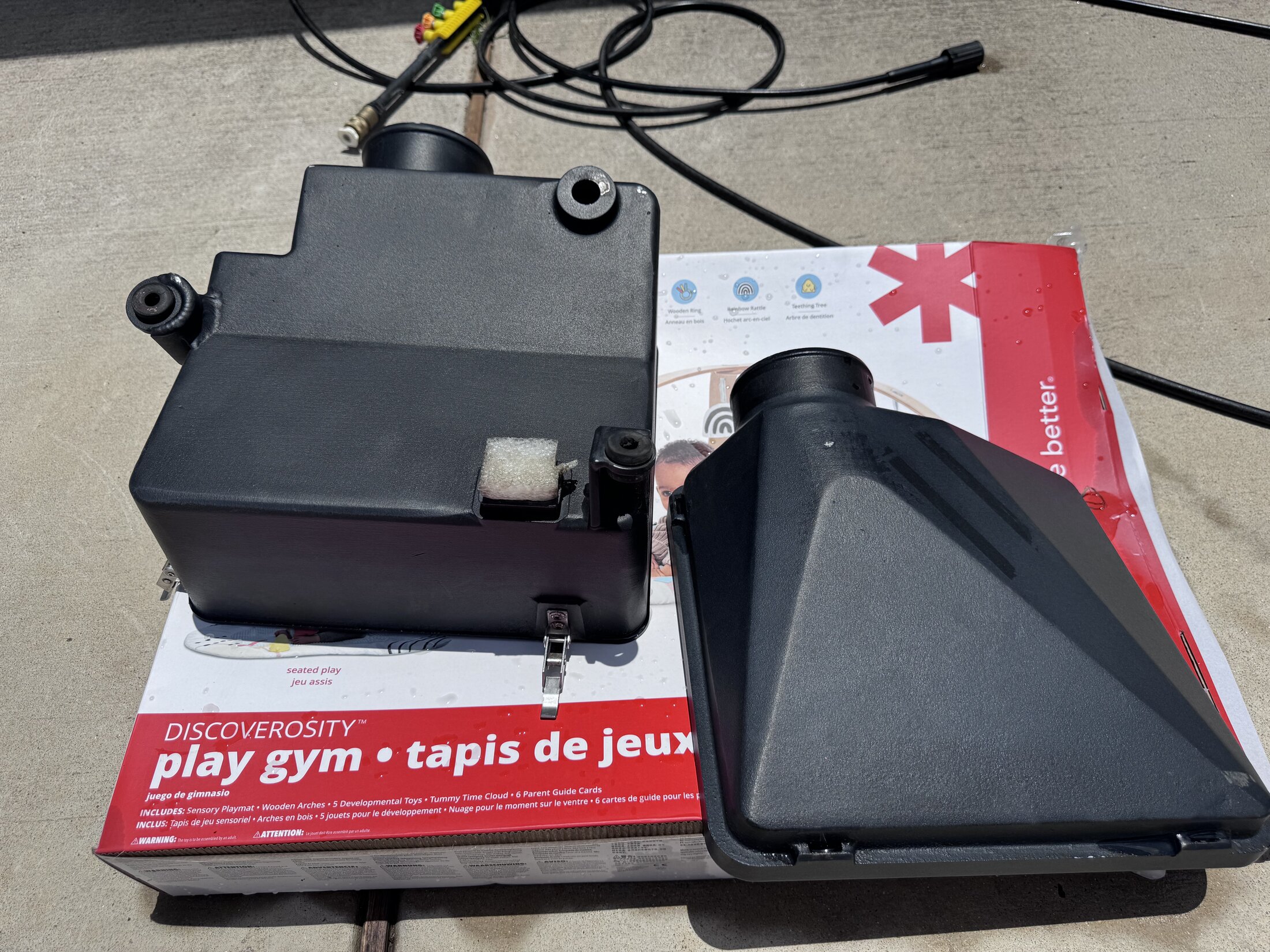

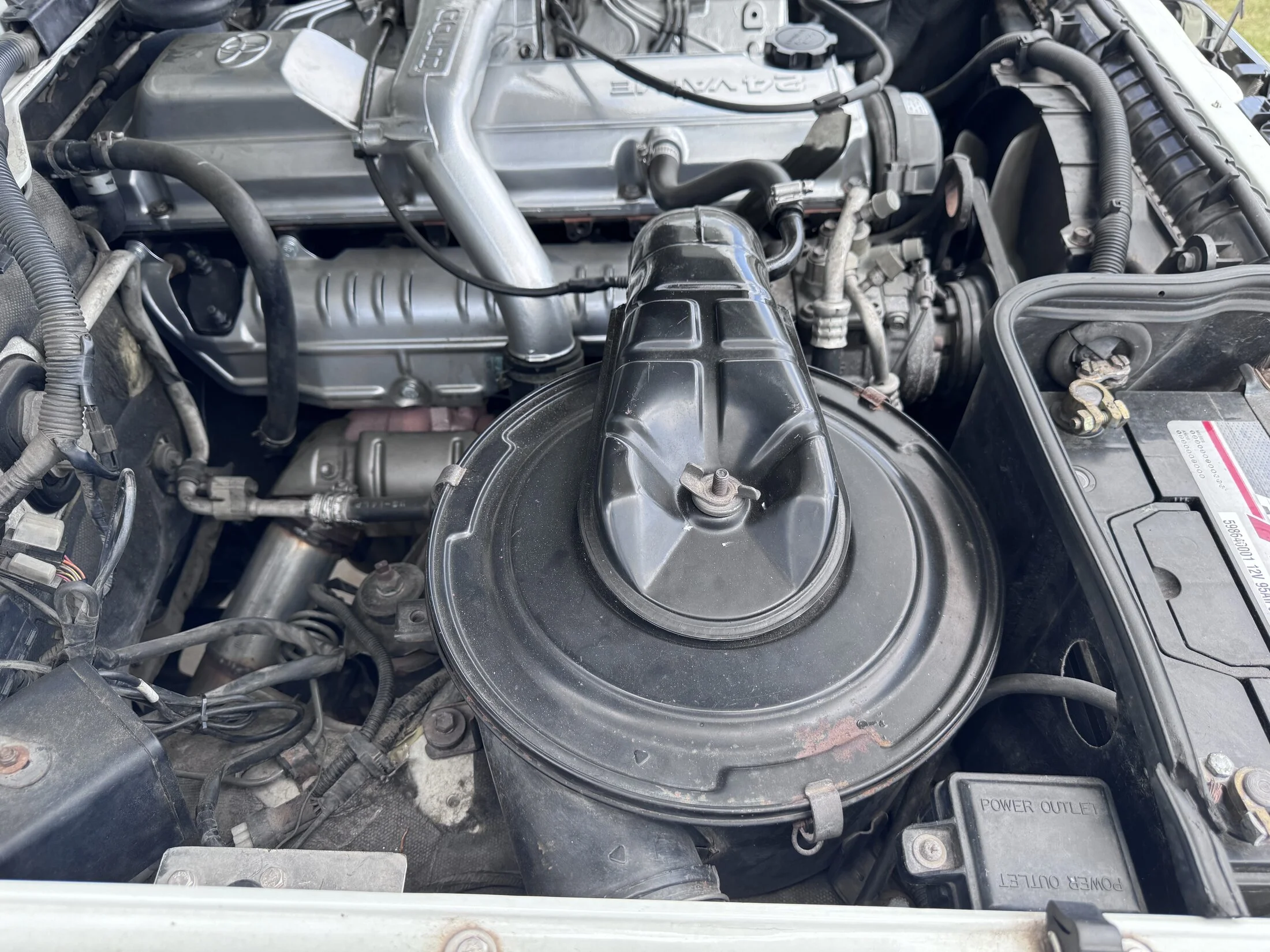

Only had less than an hour today so did some prep work on the PDI air box, the paint they use is pretty damn tough but it’s not visually appealing and my engine compartment is… so a coat or 3 of new paint is incoming
Prepped with maroon scotch brite and a good pressure washing. Will let dry overnight because it’s humid as hell in TX right now then paint tomorrow

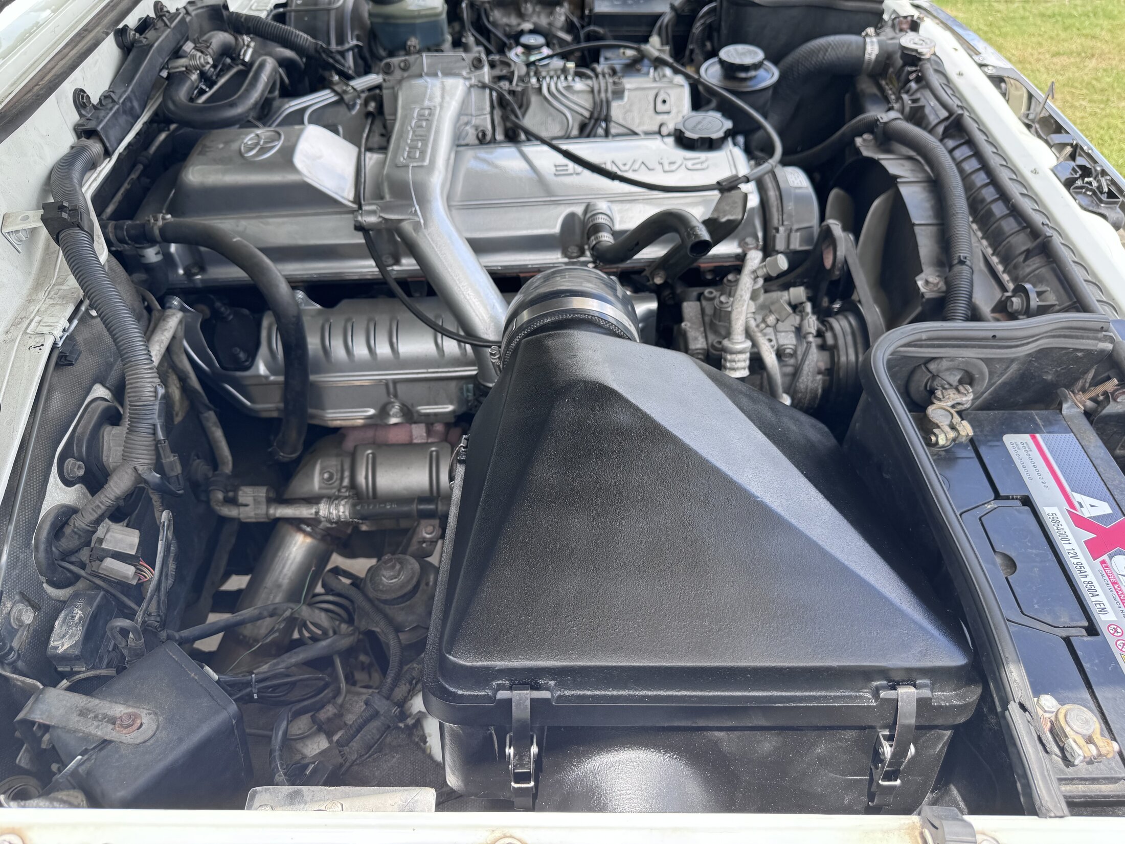

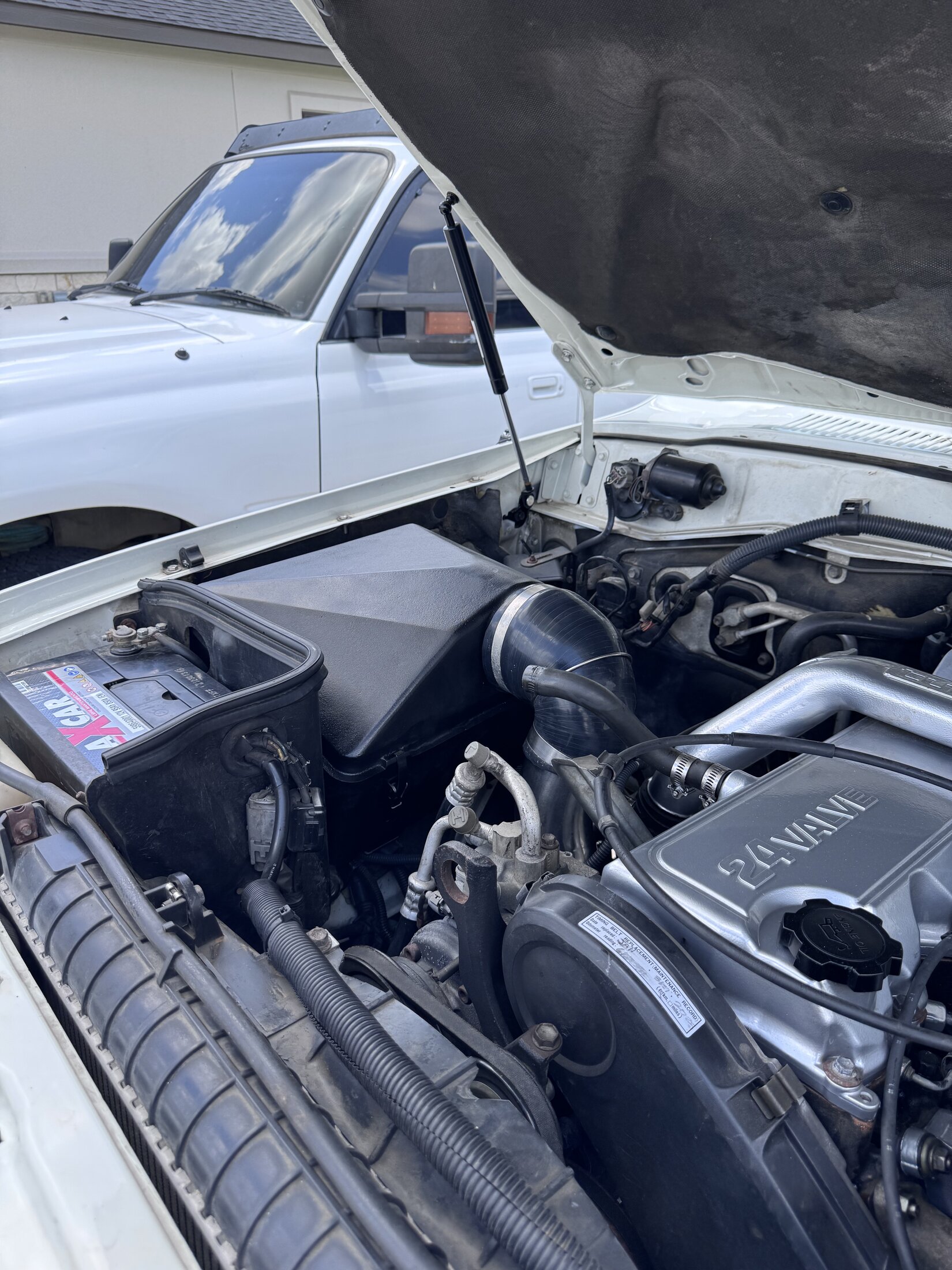

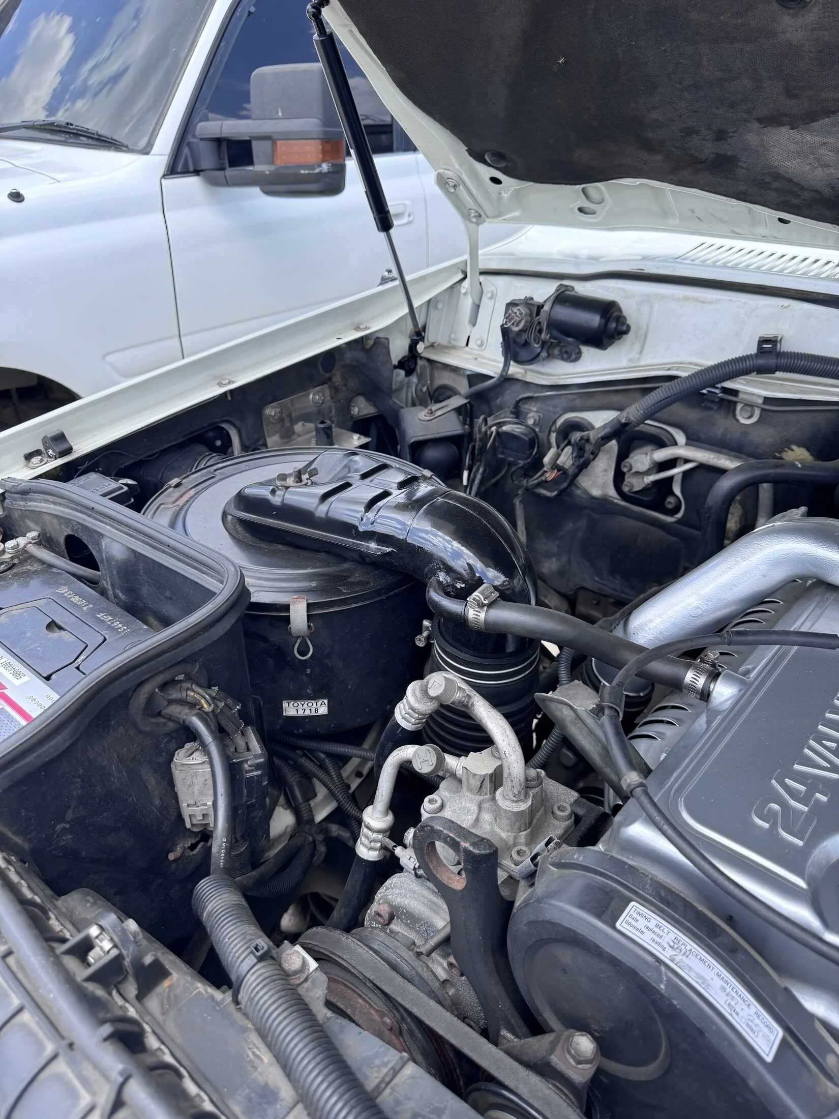

Finished painting the air box and started install

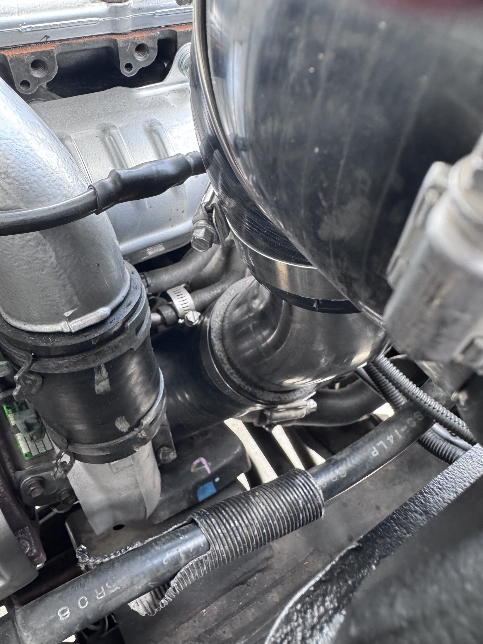

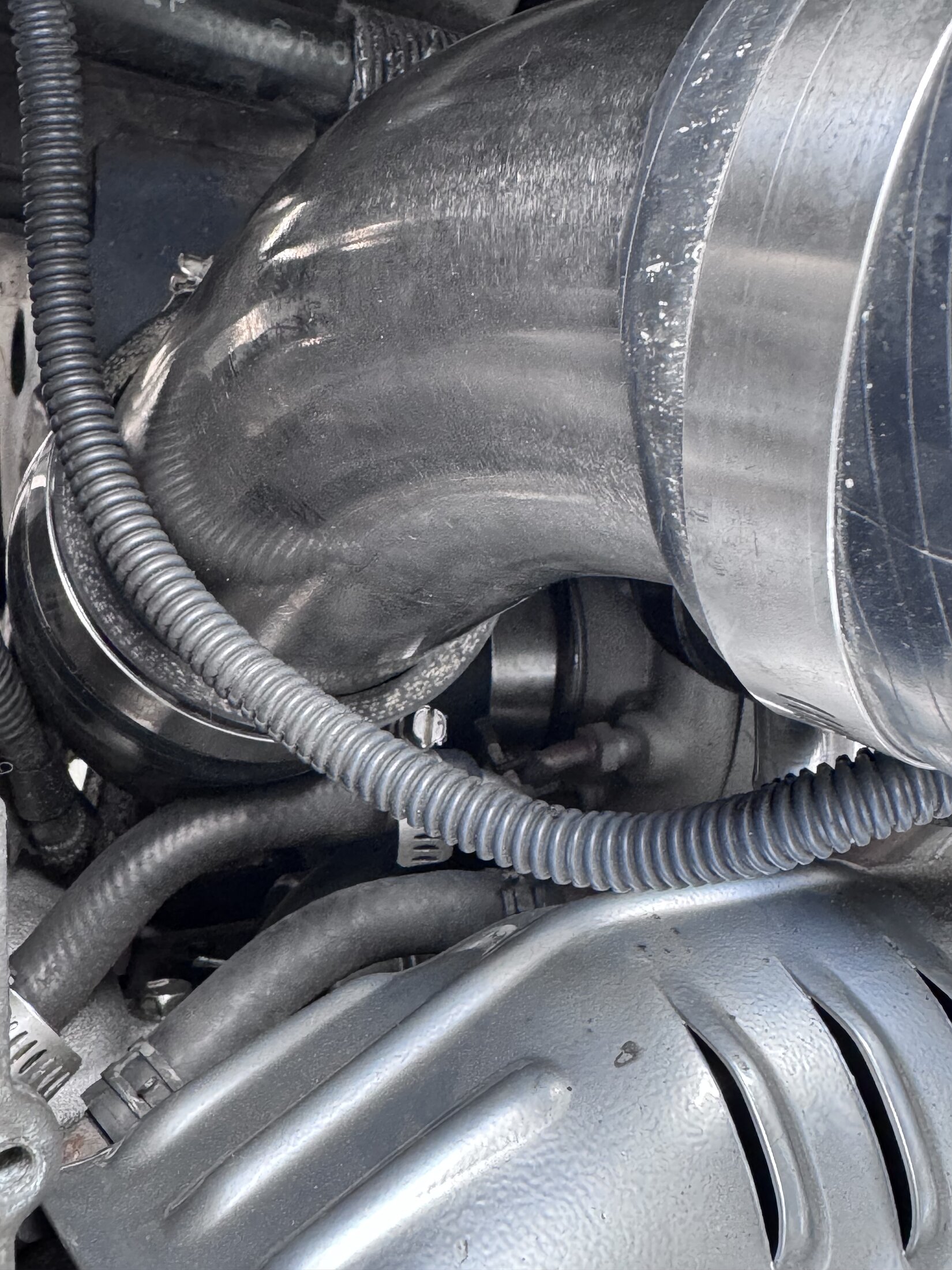

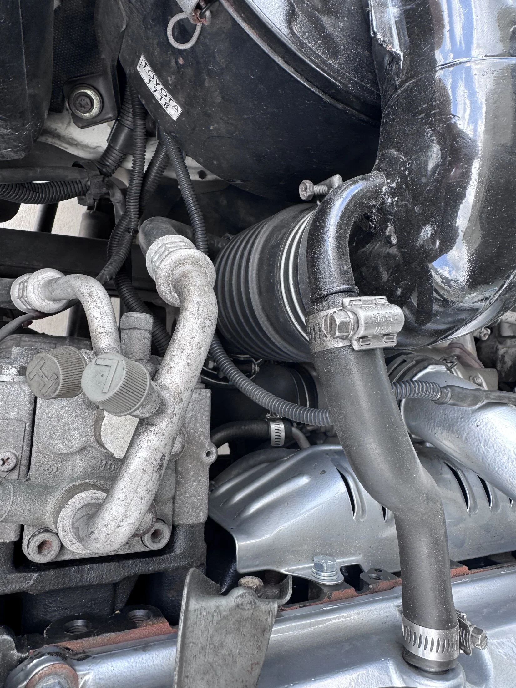

I don’t really have the proper hoses to go to a stock turbo and also don’t really like that the current one isn’t sitting flush. I don’t need to drive it so will either swap the aftermarket turbo from my 1HDT or get new hoses, still up for debate there
Also need to install the catch can I have on my 81 but because the valve cover outlet is in a different location from one truck to another I’ll also need to make hoses for that. No big deal and hoses are cheap but out of time for today
The turbo I have is described below, since this is custom will need to have it looked at before considering putting it on the FT, but I’ll need to also add an EGT probe and an AFR sensor. If I’m taking it down that far I might even just say F-it and put arp studs in… it’s a slippery slope

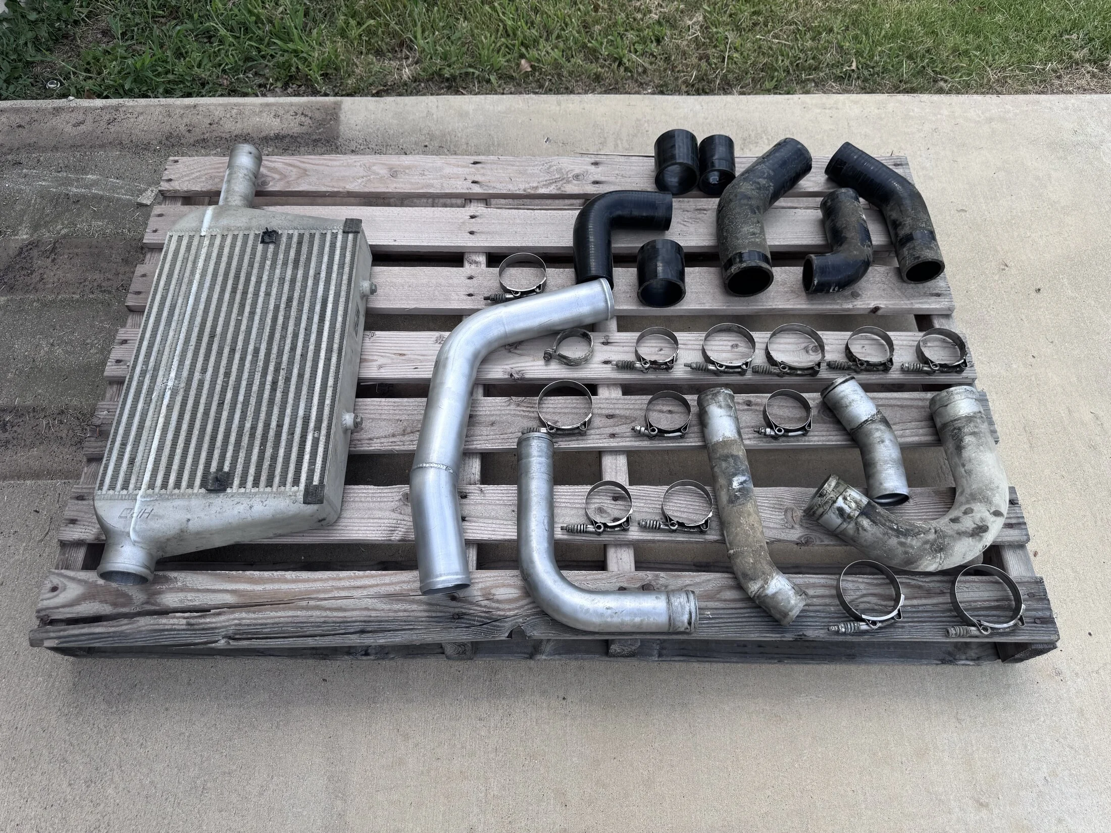

Pulled out the rest of the intercooler/hoses, all pretty dirty with a layer of corrosion. I plan on polishing the aluminum tubes to get them looking nice before installing into the 80
The intercooler itself looks like it was installed when the truck was painted and has a bunch of white paint around it so definitely going to want to get that cleaned as well. May paint it, a ~3% loss in cooling efficiency might be acceptable but we will see after I clean it up

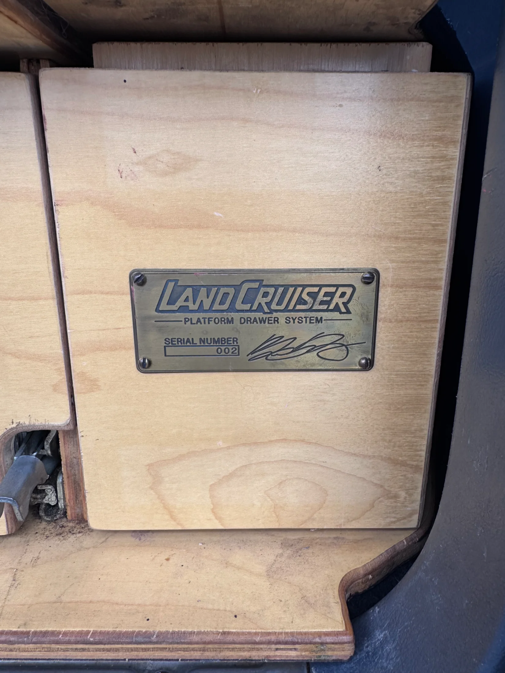

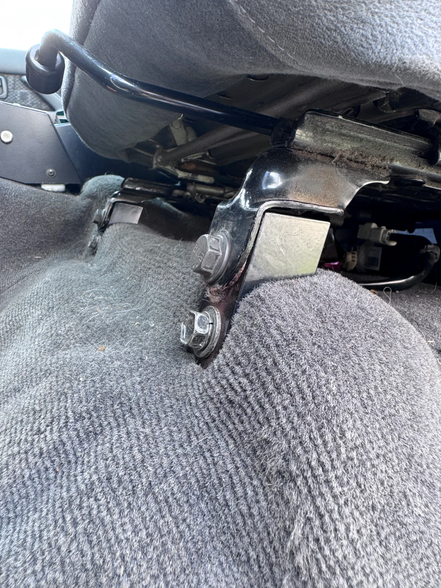

i did move over the drawer system I bought from @bryce0225 a couple of years ago. The thing is stout and was more than a little challenging to move myself haha

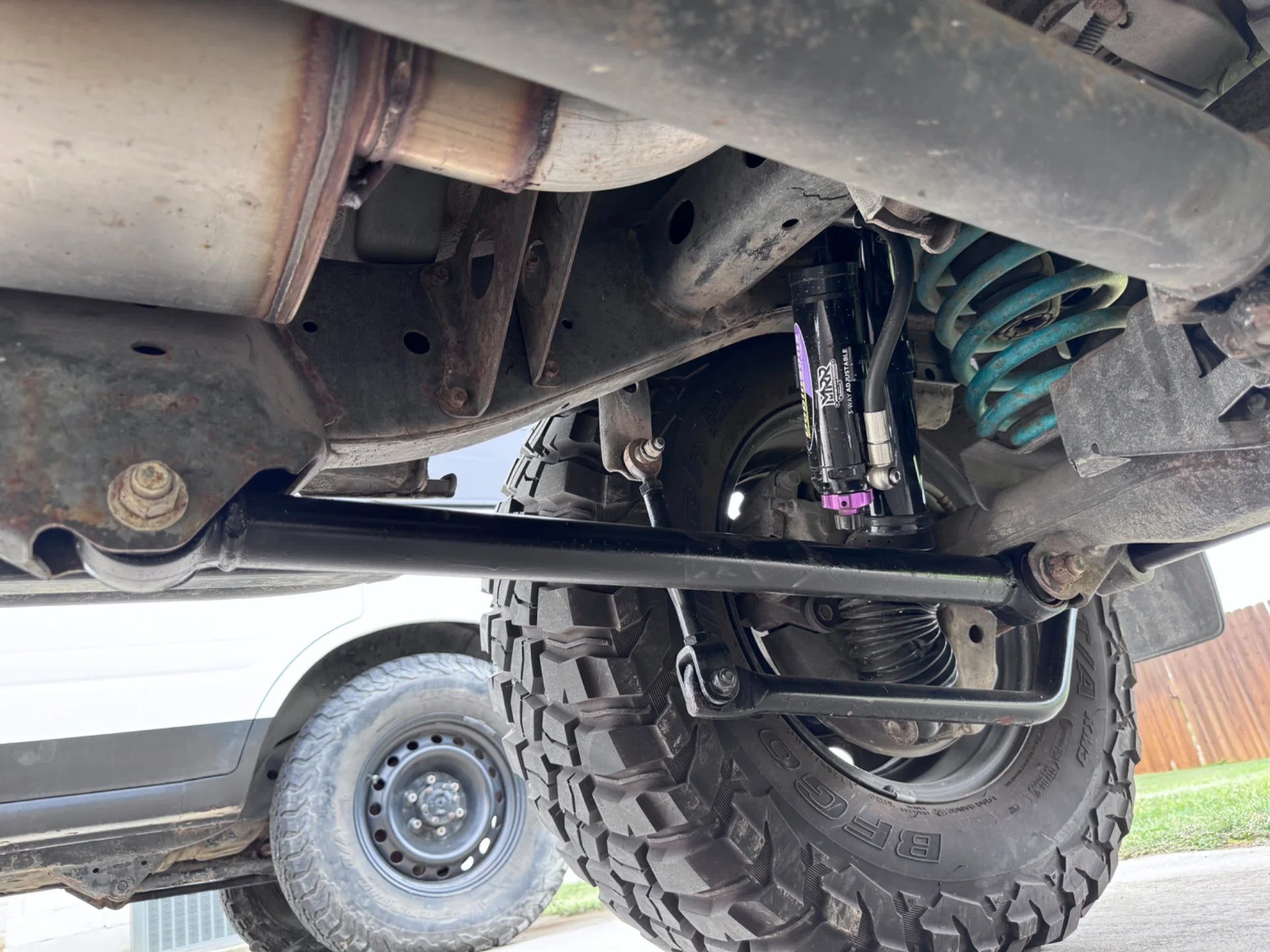

-Swapped to the beefier tie rod, was unable to get one of the ends to break free, we torched it, soaked it in PB, broke out the biggest breaker bars and cheater bars I had, no dice but since the rod ends and the length was good enough to get a proper inwards toe I left it as is but will likely replace the bar in the future.

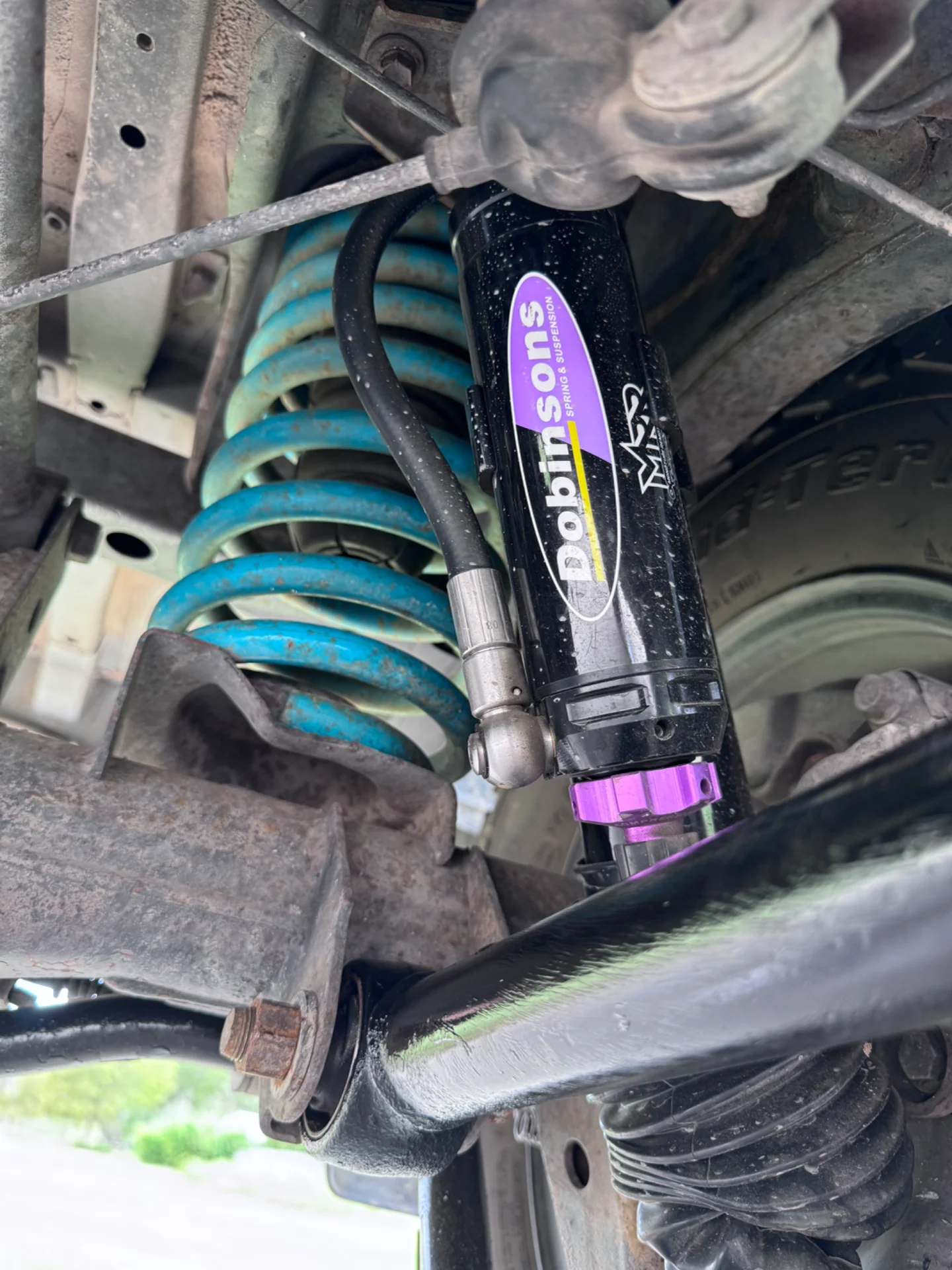

Added dobinson remote reservoir shocks along with their dampner
Swapped out the delta arms to get the corrected caster after the lift, the bushings were in great shape too and didn’t need replacement yer
Swapped out the front and rear sway bars and drop brackets

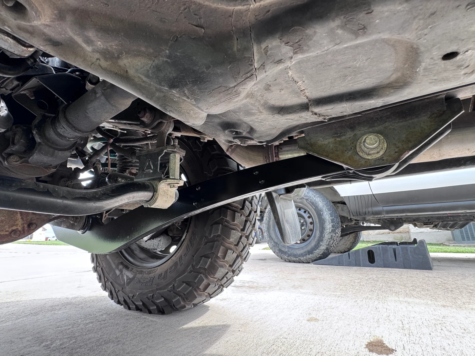

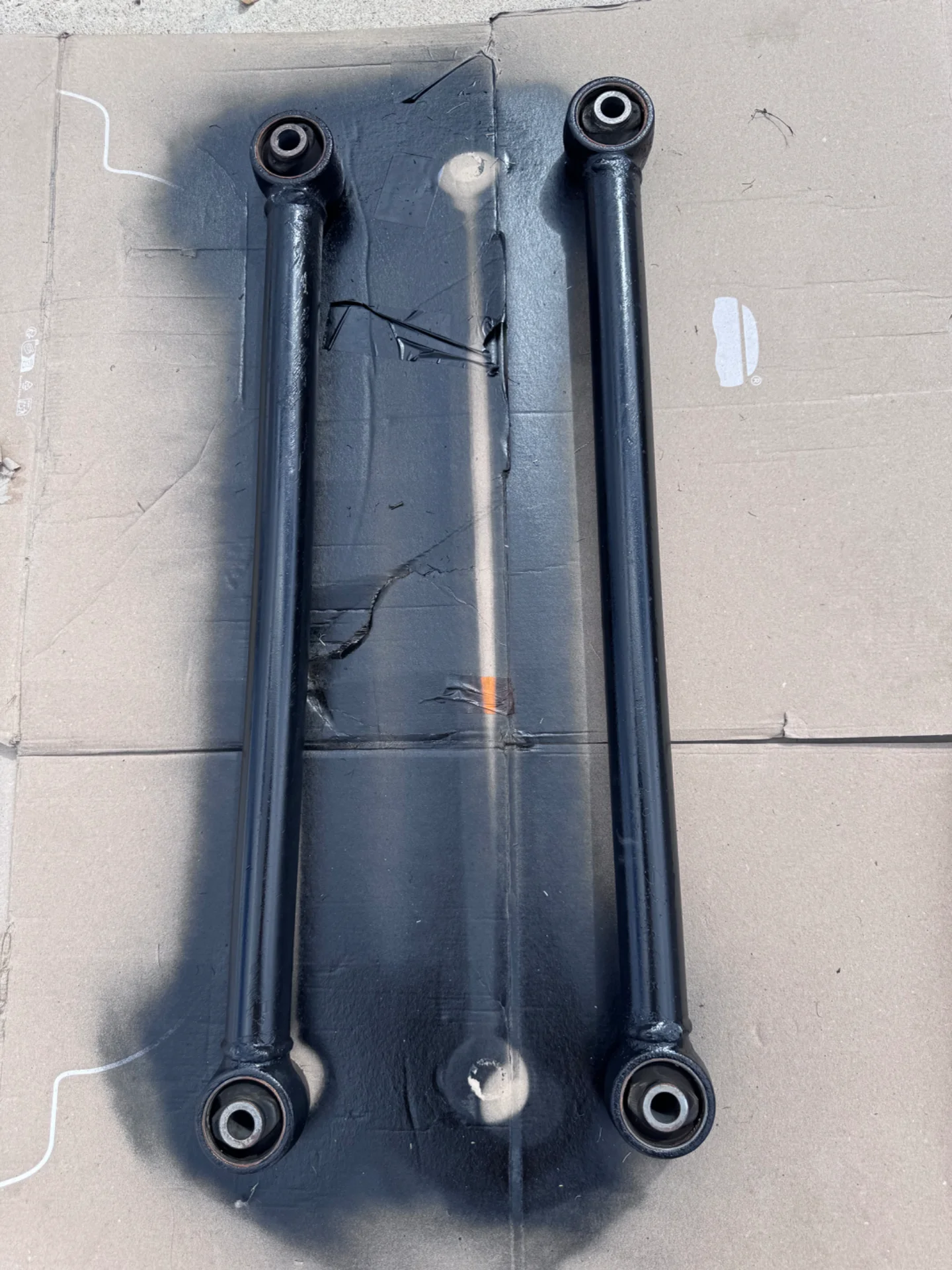

Swapped out the beefier trailing arms also with good bushings.
Since the original gear had seemingly original rubber that was hardened and cracked the rig is overall smoother than quieter. I also repainted everything I had with engine enamel… not because I researched the paint but because I had it laying around and I had previously painted my bumper with it and that things taken a beating and the paint has held up well over the years
