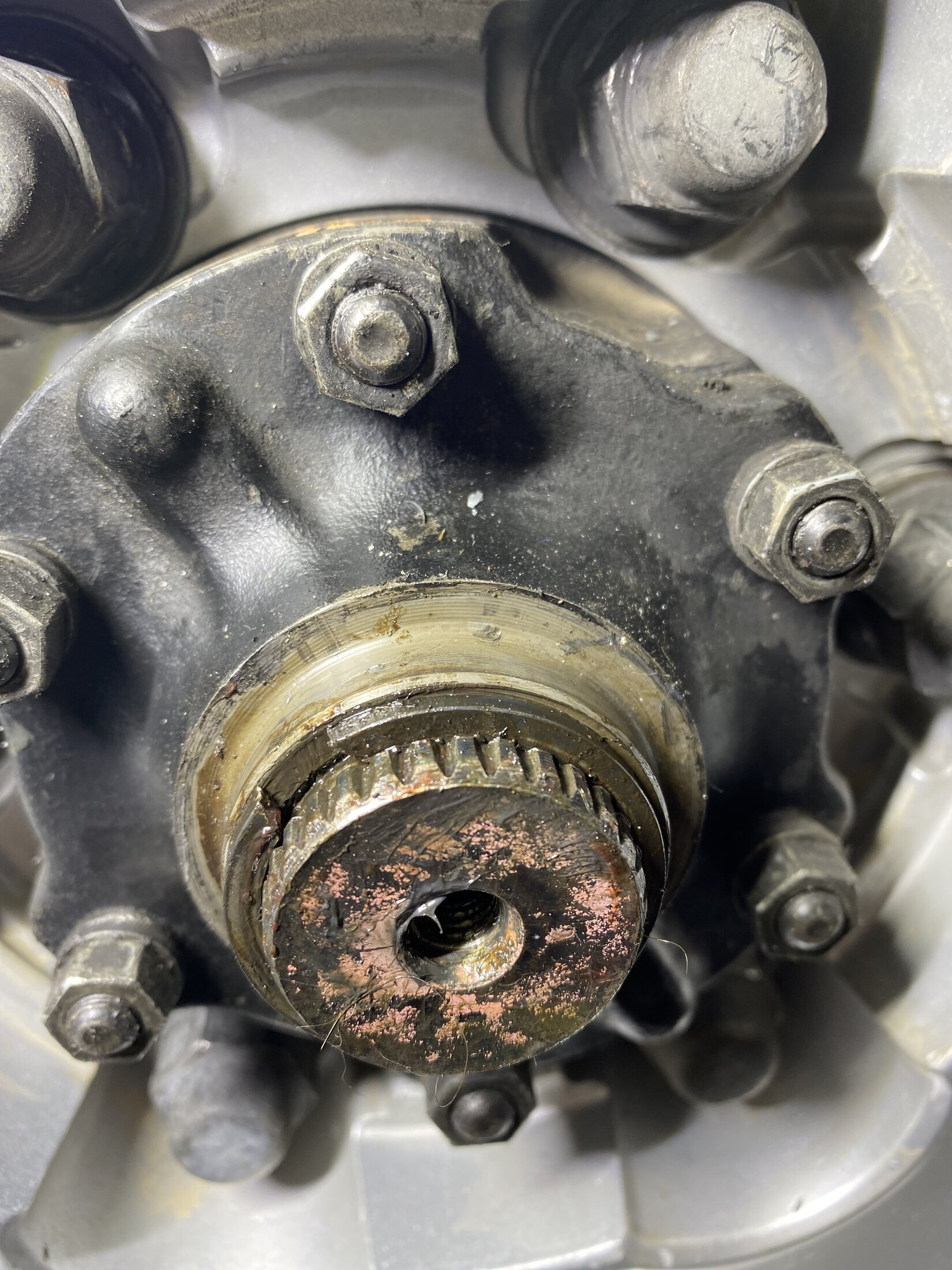

You could pop the dust cap off the end of the hub, and watch how much slop there is in the Birf/drive flange splines.
Splines should have nice sharp shoulders on the edges of teeth, not vague rounded peaks ( red lines) You should see a well defined edge ( orange lines)
Shape of the splines at the exposed/ unworn end of the Birf should be consistent right along the length of the splines. If these or flange splines have rounded peaks, its probably time to change them.
