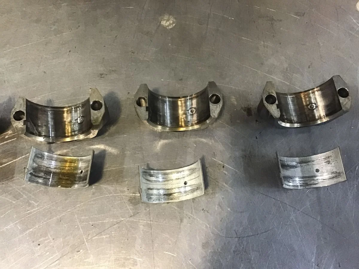

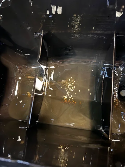

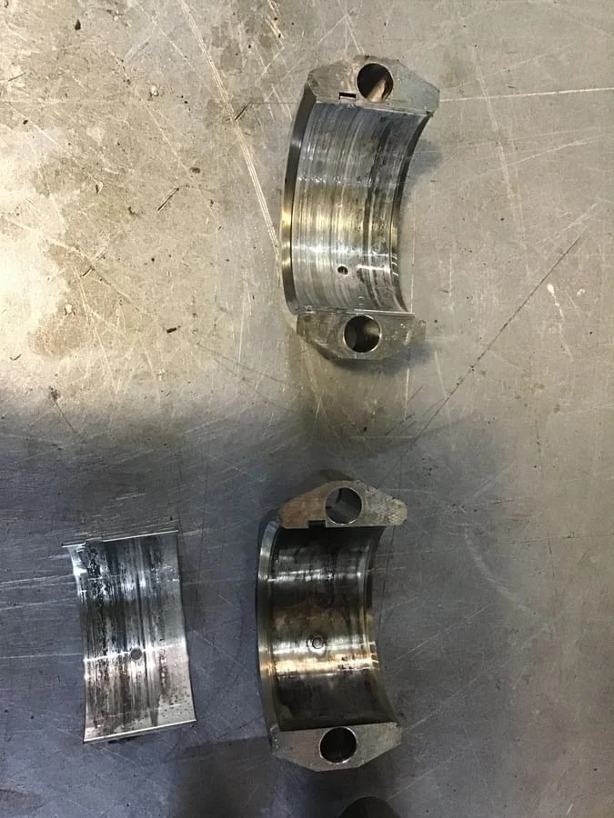

I need some advice here. I have a 86 fj60 I bought for 6k a couple of months ago. Body is in decent shape, little rust, 248k miles. Runs good, no smoking or burning oil. Compression numbers 170, 170, 170,180, 175, 180. Several minor leaks. I took it to the shop because of a minor rattle at low rpm beginning of each shift to 3rd gear. Rattle goes away in 4th gear. No rattle cruising and idle. They took oil pan off and said there was a lot a metal. Took off bearings and said they were worn. They recommend new rebuilt engine. They said they can do a bottom end rebuild but want me to sign a waiver to release liability. Should I take that chance and have them do the bottom end or just drive it and plan on rebuild? I really appreciate the help. Thanks

Easy enoigh to do just the big ends with motor still in. I'd do that, shouldn't. Cost more than about $100 in bearings plus labor.
Any risk of loose metal plugging up something and causing failure?
Oil pickup tube has a strainer, filter must have caught whatever else was in the oil. One can never know, but I say this, them JDM HDJ81 trucks with the 1HD engine, had delaminating big end bearings, so in most cases they are swapped with the motor still in. Consider yourself in the same boat. I'd say go for it.

Those bearings look terrible.
As stated, get new CORRECT SIZE quality Japanese-made bearings (sorry, I don't know your level of experience), clean the crank very well (there are plenty of Youtube vids on how to do this without removing metal or scratching the CS. Torque the caps down properly. CLEAN the oil pan well, fill with Rotella T4 15w40 or a Non-Syn 20w50 like Valvoline, and she how she goes.
