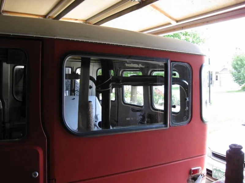

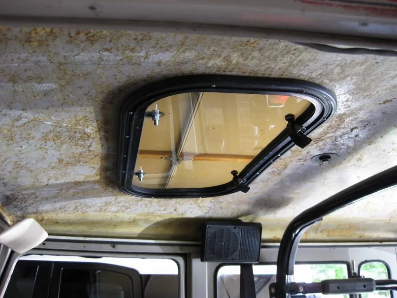

I recently bought a non running 78 fj40 .
I am working on getting it running to see if anything in the drive train needs attention.
The good points of this 40 :
1 very good interior. Dash, steering column, floor mats, jump seats, front/rear heater ect. are all in great shape.
2 the top, hood, bib, windshield/frame, are in good shape.
3 drive train all original no mods to deal with. 140,000k
The bad:
The BODY. rust on everything not mentioned above.
I am able to buy a 70 with a great body, new frame and new lift kit- (no drive train) for a reasonable price. (Cheaper than a new 3/4 tub.)
The question.
Can I transfer the drive train and top to the 70 body and frame?
I want to keep the ambulance doors if possible.
What problems will I have and what areas other than body issues will I have?
Thanks for any info you can provide.

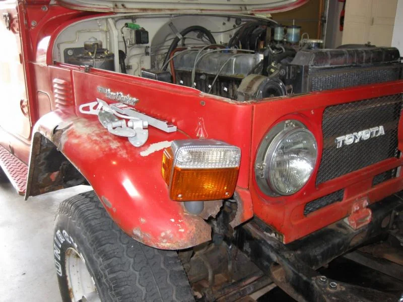

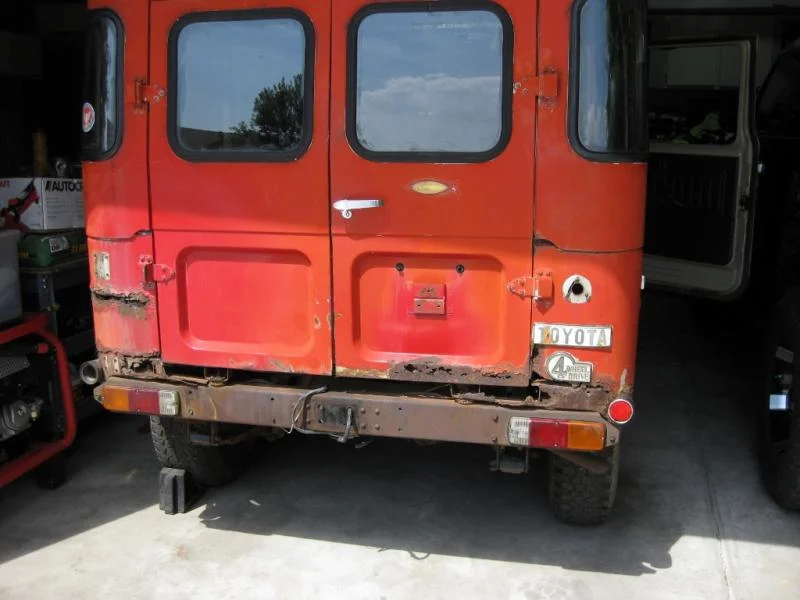

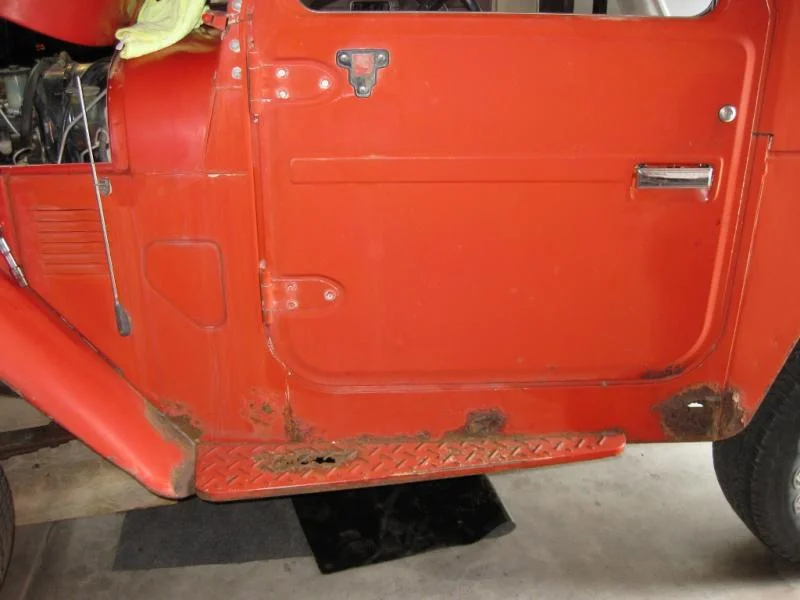

Thanks for the reply,

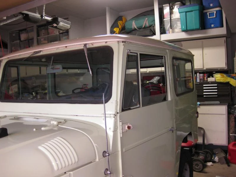

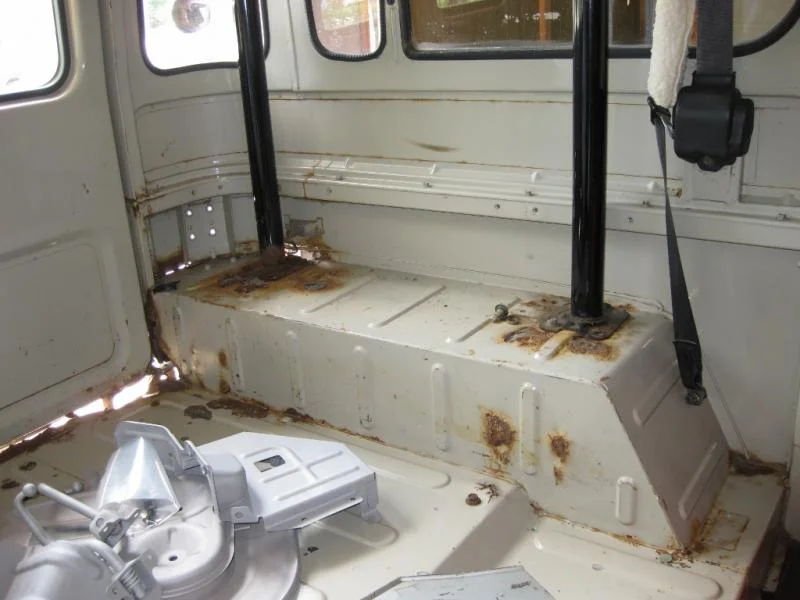

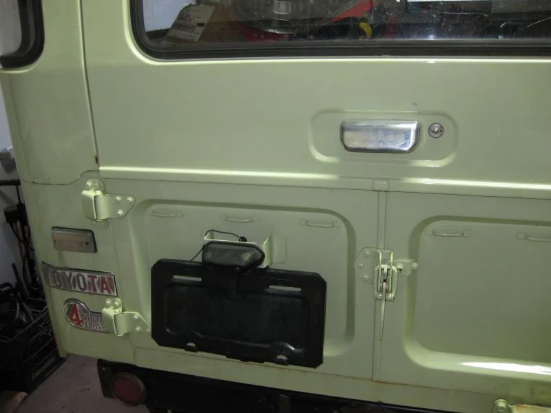

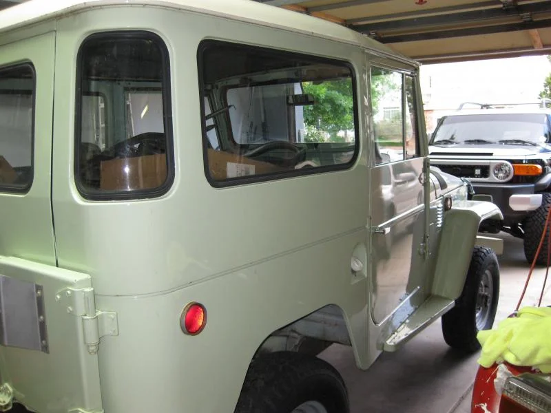

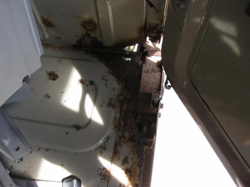

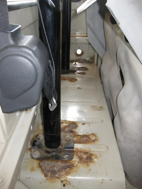

I am attaching some pics to show the condition of the 78
I haven't done the swap you are talking about but the 40's didn't see SIGNIFICANT frame and dimensional changes throughout their legendary run... I would think you could make it work relatively easy.
Figure how much time and money it should cost, then double it, and you'll be in the ballpark.
I like that 78 and it really is the best year. :) Did you mention what's up with the 2F (other than not running) and the frame - are they good? You don't say if you would do some metal work yourself or pay someone to get it done? If the toasted sheet metal is the main problem with the 78 and you determine it's fixable I would focus on the 78 and pour the $ in there. That is if you care about having an original 40 (I would take it back to the original white).
Of course you may have some creative fun with the Frankenstein approach and all those parts everywhere and that's cool too.
That's some bad rust but at least it's not all covered up with bondo. :D

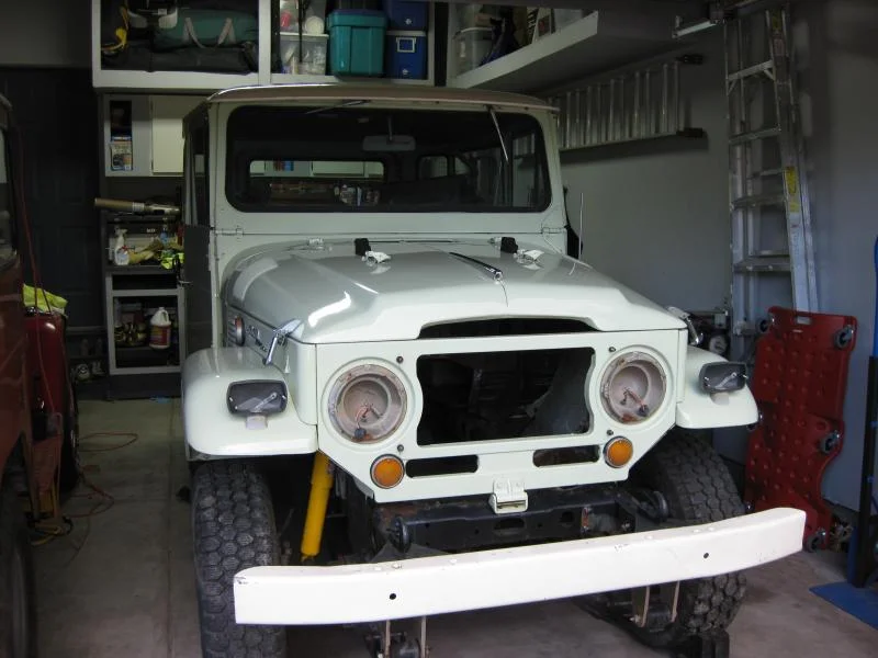

Oh, I almost forgot the best part! see pic:crybaby:
Funny - my son is looking at a more or less cherry old 78 Ford pickup and the one big bump in the road is an after-market moon roof in the cab :crybaby: x2 - nice view of your garage door.

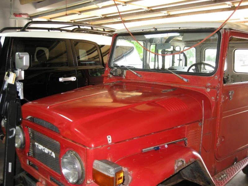

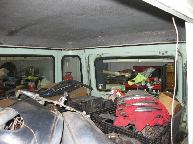

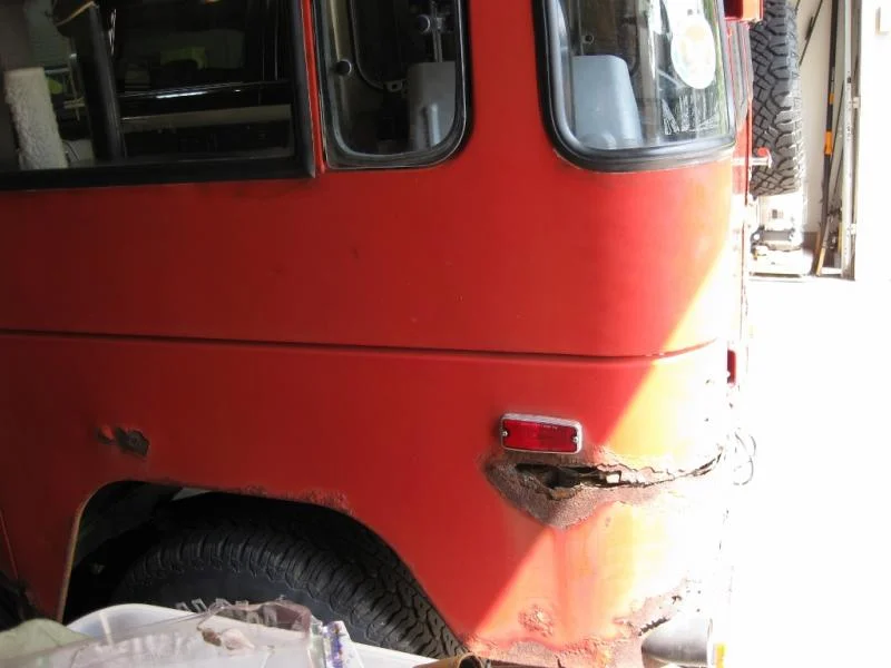

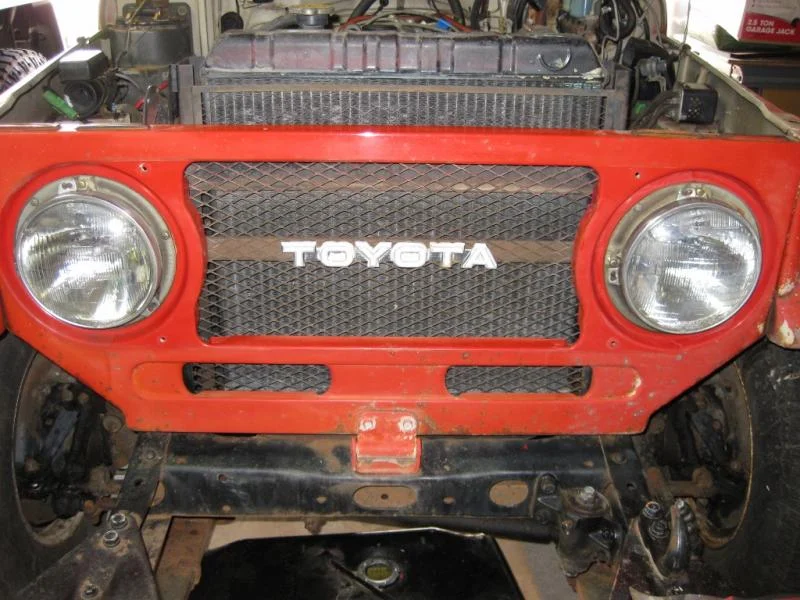

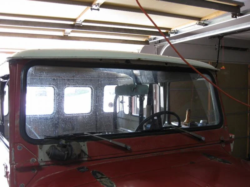

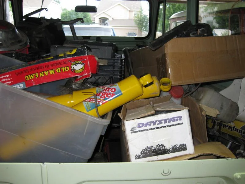

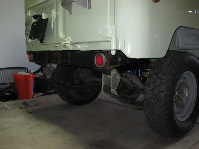

Well I got the 70 in my garage today.
Here are some pics of its current state.
