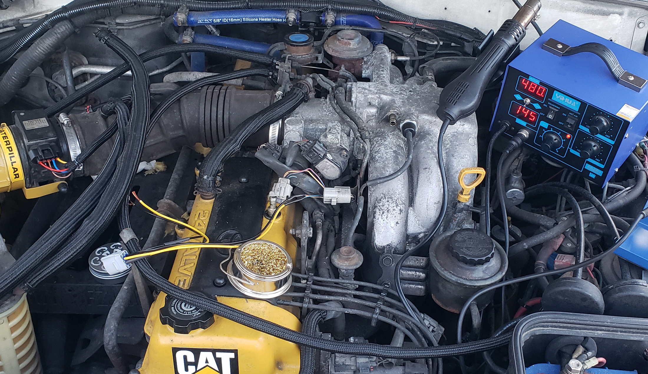

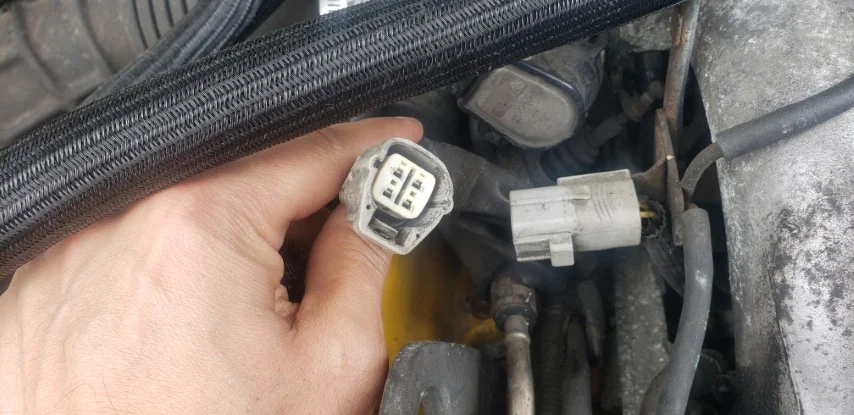

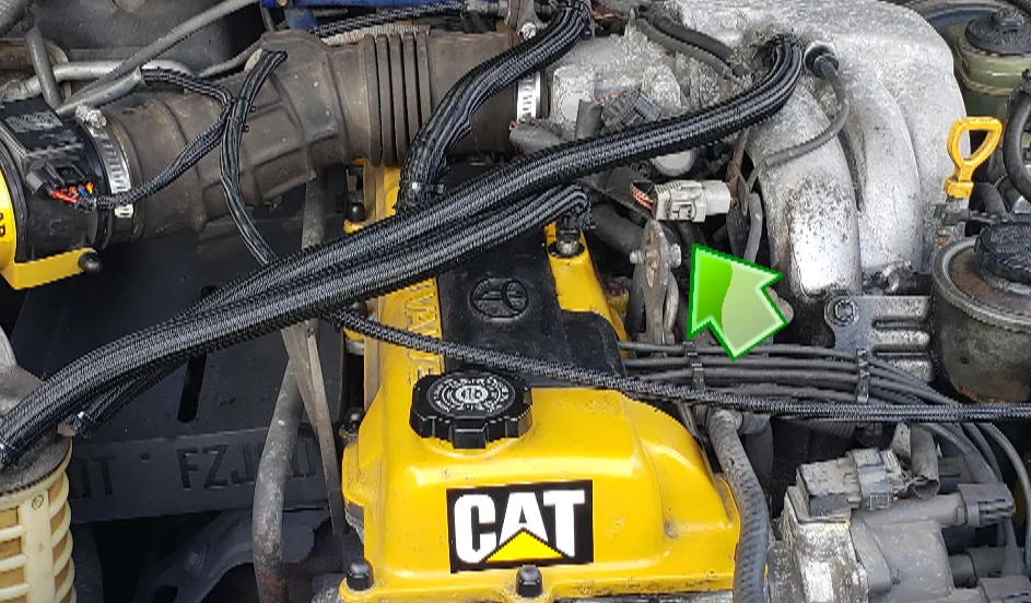

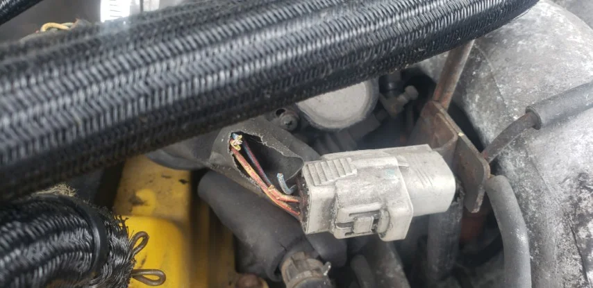

Appears to be a a plug leading to the idle control valve (or sumthin)
Wires are frayed and I want to get a replacement pigtail rather than depinning
Didn't see any numbers/markings on the plug itself

That feeds your vacuum switching valves under the intake, the two yellow wires or the one vacuum valve for the egr, you can clip into both the yellows and 12v and should here the switch clicking.

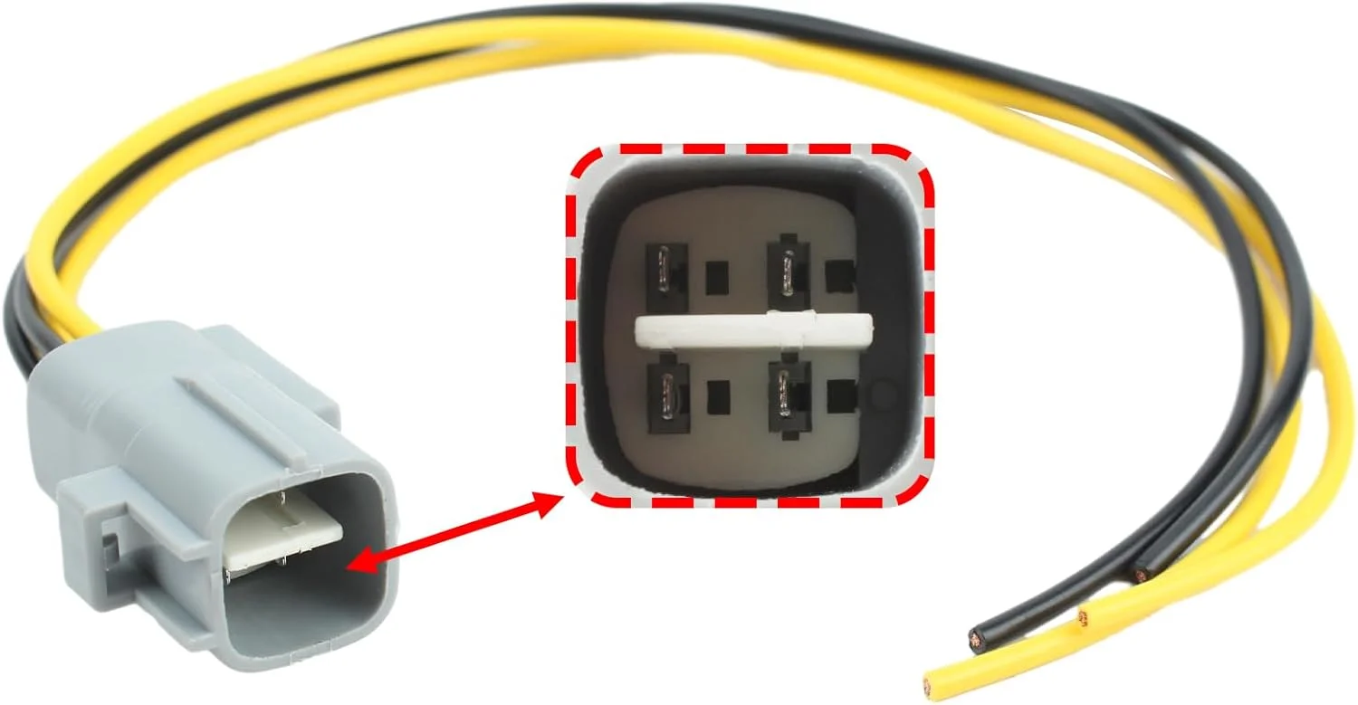

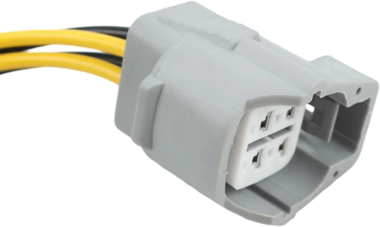

I believe it is a Sumitomo MT090 4-pin connector (6180-4771).
@98 SNAKE EATER : Can you post the source and part number of the connector?
Was it a Sumitomo MT090 4-pin connector (6180-4771)?

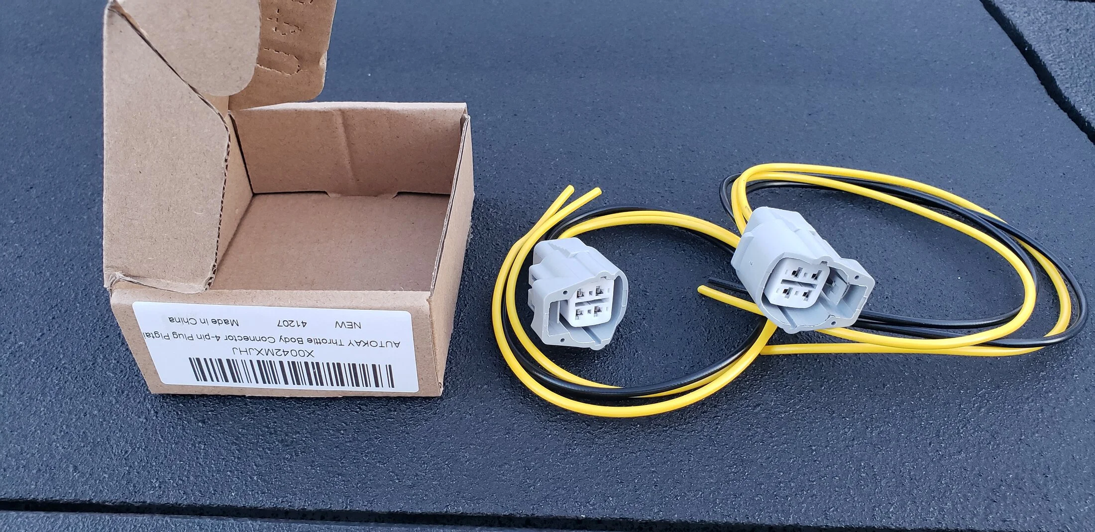

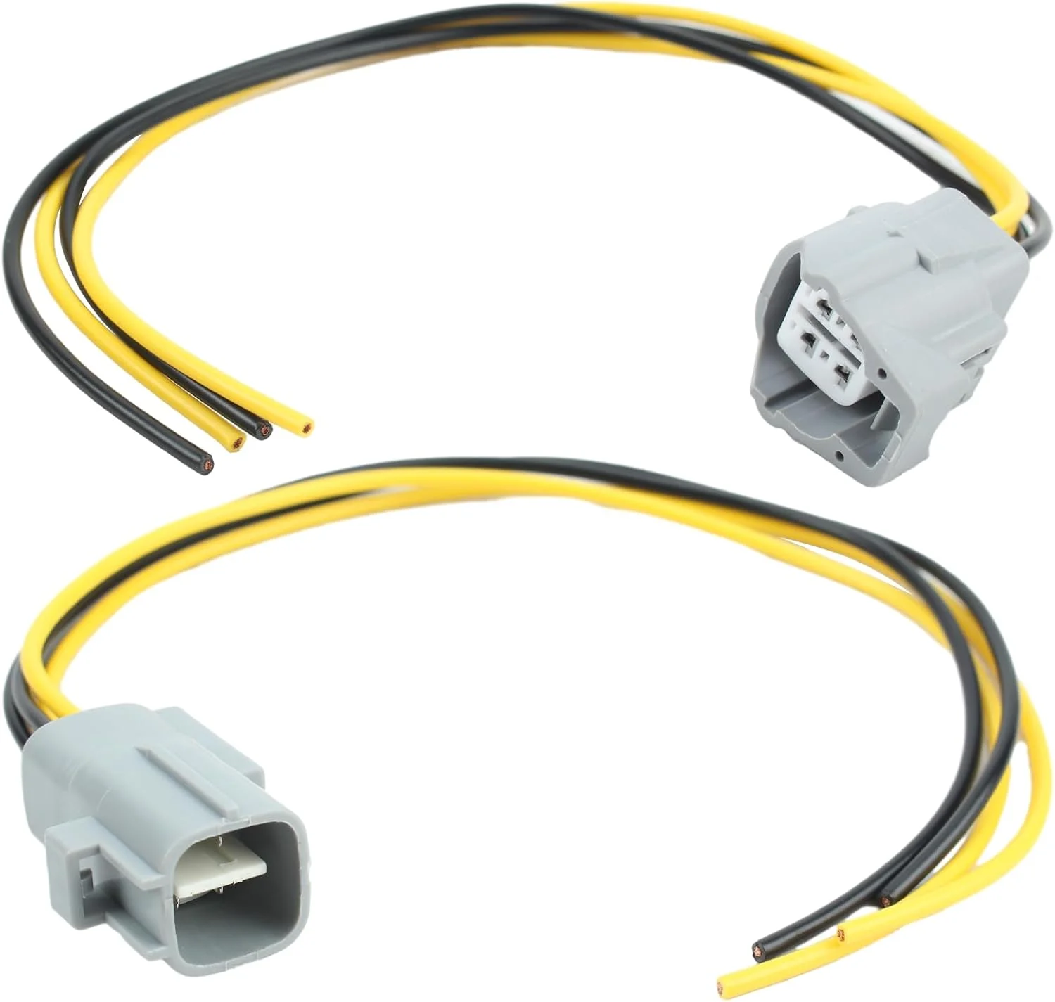

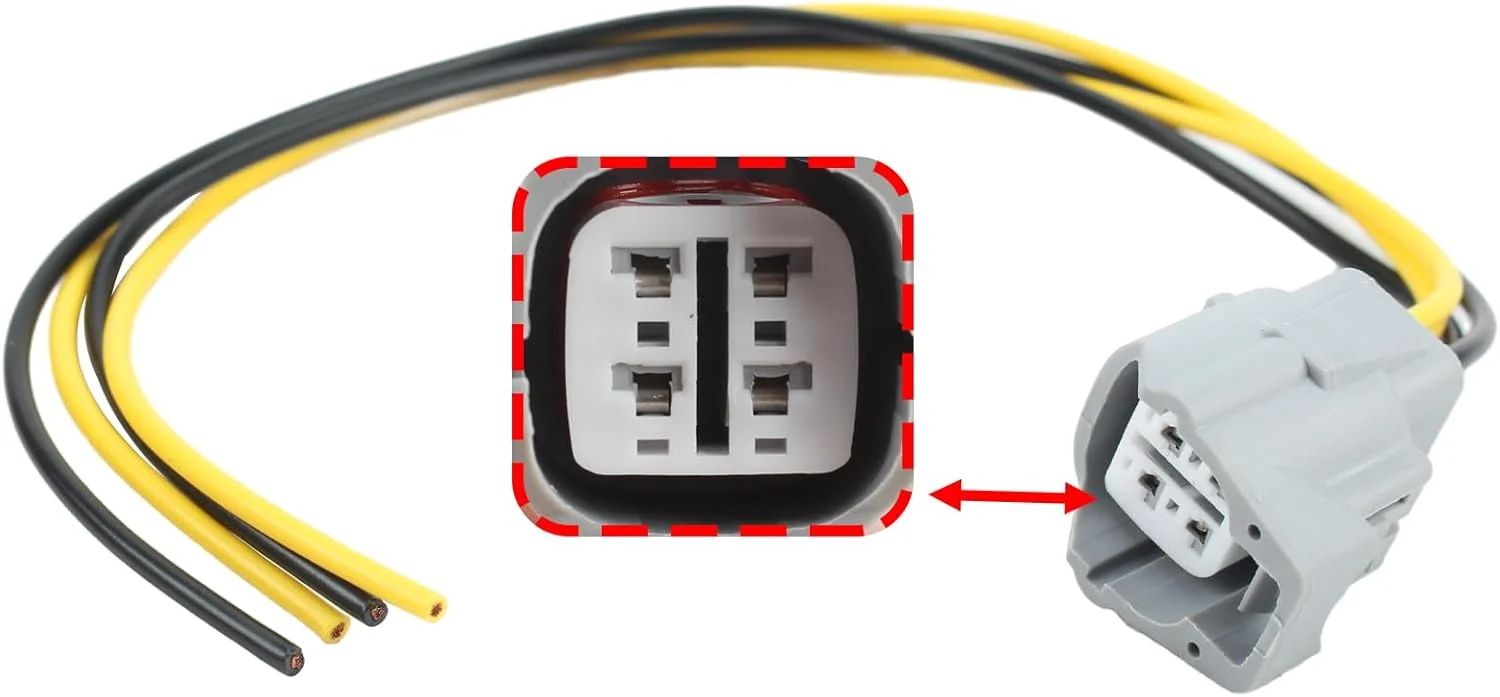

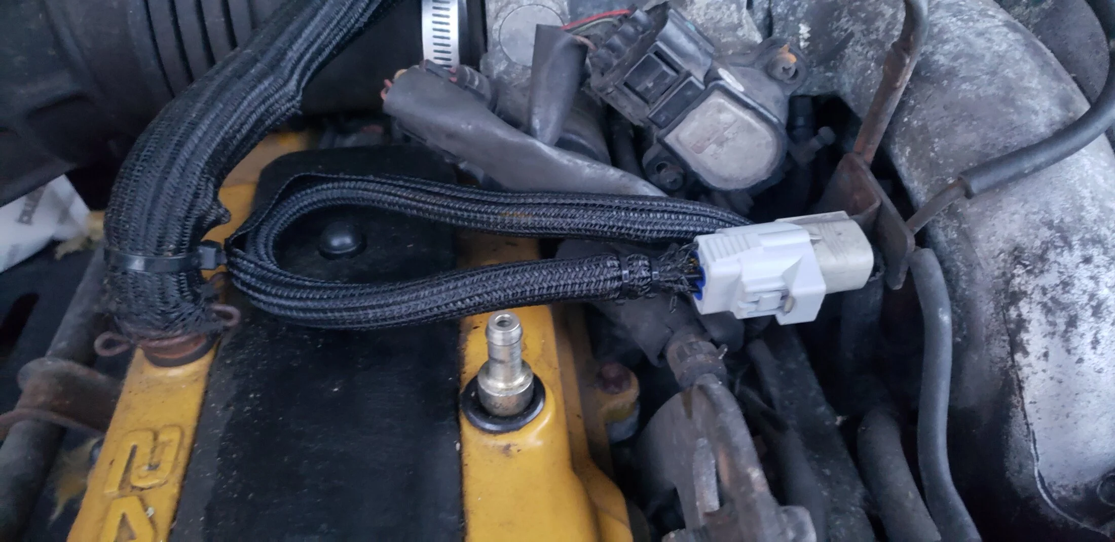

That was the number I used in my initial search, but it only came up with the bare connector ends.
Then I did a search for Toyota Throttle Body Connector Pigtail and just chose the one that looked the same.
The one I got actually says it fits Lexus IS300 2001-2005 and that it does not fit my 97 Land Cruiser (weird)
