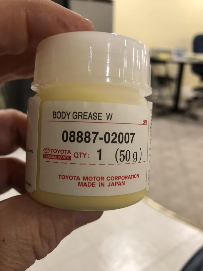

There is a small 50gm tub of Toyota yellow "Body Grease" which costs around $60-70 retail. It's apparently the same as one of the Dupont Krytox greases. YM-103 from memory.

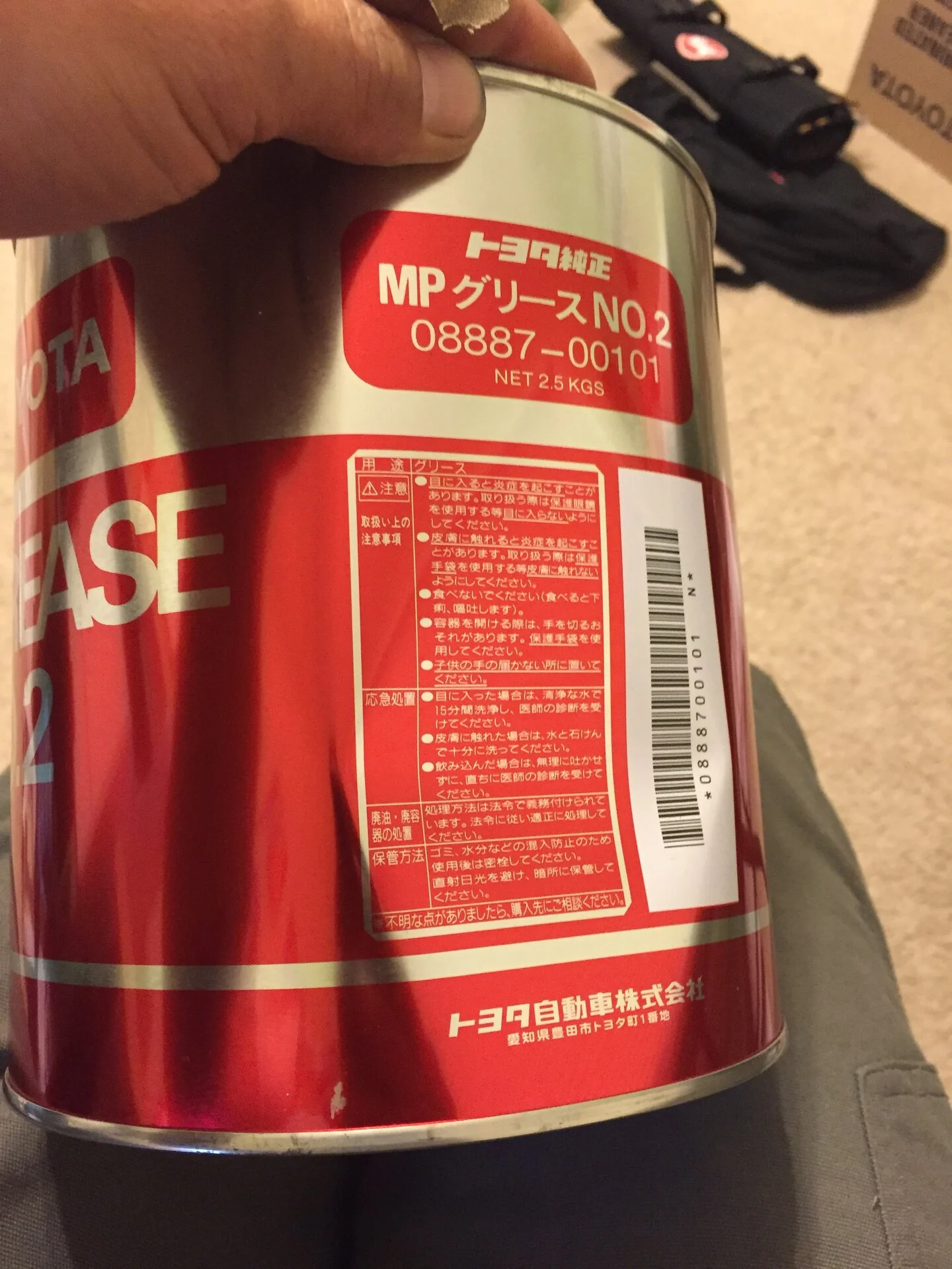

Looks like supermarket sample
I don't know which is funnier.
The yellow Body Grease appears to be the same grease that new window regulators come with. It could be used about anywhere, except for the cost.
IIRC the original grease used for the plastic gears in the window lift motors was light green in color which after 25 years was still smooth with zero petroleum odor, so either silicone or PTFE is my guess?? The grease that comes applied to a new Toyota window regulator is yellow and appears to be same/similar to the Toyota Body Grease.
