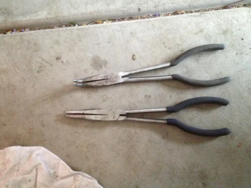

2- next I used what was probably the best 8 dollar HF investment I have ever done! I attached a pic of them. These pliers were vital in every single step! I work off a budget so I was not going to go out and buy anything specialized and I don't own a die grinder. I reached in with the angled pair and hooked the old style clamp and just bent it around for a minute until it finally snapped. Then I was able to reach in with the straight pair and remove the clamp that was closest to the block. Then with the straight pair I shoved them under the rubber to break the metal away from the rubber.
