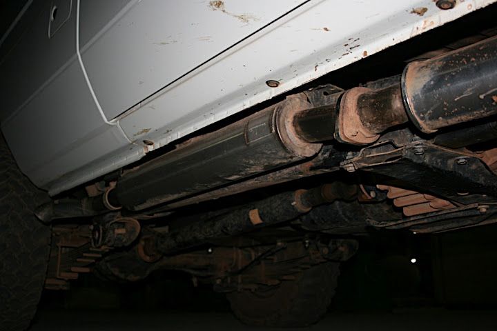

I had a home rigged straight through exiting in front of the rear wheel on my 78. No muffler. It was too much (1HZ-T) noise, way too much! Finally went to one the same length but with a big muffler. Perfect. Just the right turbo noise but not overboard.
Gil
SS side exit
Tourfactory (German 75/78?79 specialists) SS side exit
