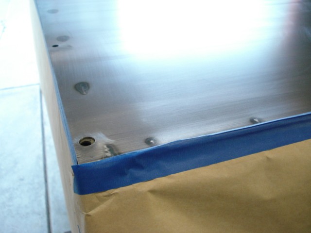

I chose to use a 3M rubberized undercoating that cannot be top-coated. It is great stuff and sprays on a nice texture. I used 3 cans total, about 3/4 of a can on the little box and another 2 1/4 cans on the big box. I sanded the bottom of both boxes with 220 grit and wiped everything down with acetone before spraying. Here is a close up of the prepped metal.
I did use one of those little spray gun attachments to spray the rubberized undercoating from the can... it works great, cheesy, but they work great.

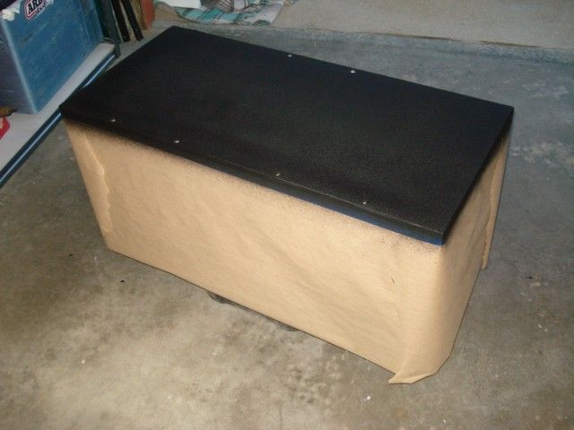

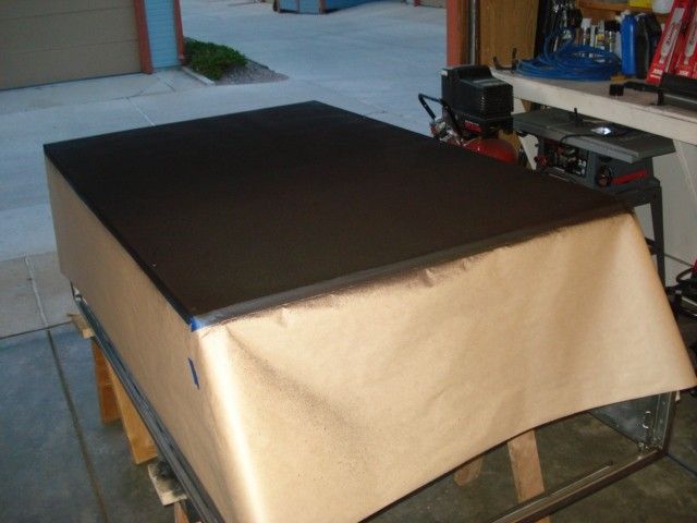

I put on about 4 coats onto each box.
Came out looking nice and rubbery! :bounce:
Here is the final result, not too shabby.

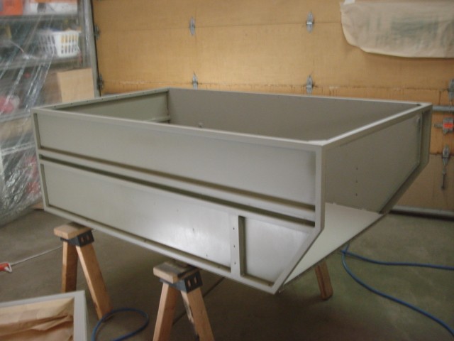

Well, I am taking a break letting the primer flash... man I am high on fumes! ;) so I thought I would bump a quick post, here is a breakdown of my day.
First up, wet down the floor and shop vac it clean and shiny... and dust free (mostly).
Next up is covering all I can with plastic sheet to avoid the over spray from taking over the whole garage. I used a few drop cloths from Home Depot and it made short work of masking off the rest of the junk in the garage...
Then I made sure to have everything in place before getting started, here is my handy dandy workspace... it was nice considering I spilled a good bit of primer when I first got going, I will be nice to just scrap it and lay down new sheets when the time comes.
more, more, more... kind of a cool color for just primer, I have always loved flat paints :D
Now I have to go fill all the gaps with an acrylic sealer to make sure this thing is water tight (more for rust prevention than anything else and then I am calling it a day! I will have to wait for the weather to cooperate to paint it blue, maybe Friday or Saturday. :(
