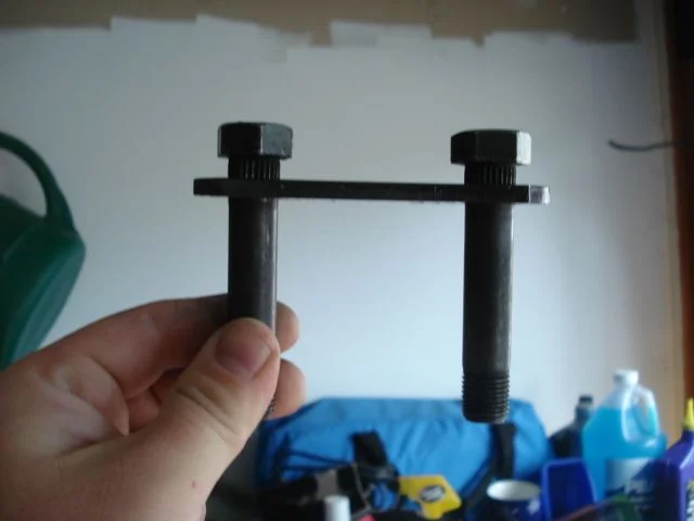

Here is some progress shots though. One big issue was pressing the shackle bolts into the shackles... I don't own a press so that presents a problem. However, a friend and fellow mudder does, THANKS lfd270BEN!
Sorry, no after pics, they just sit nice and flush now! :D
