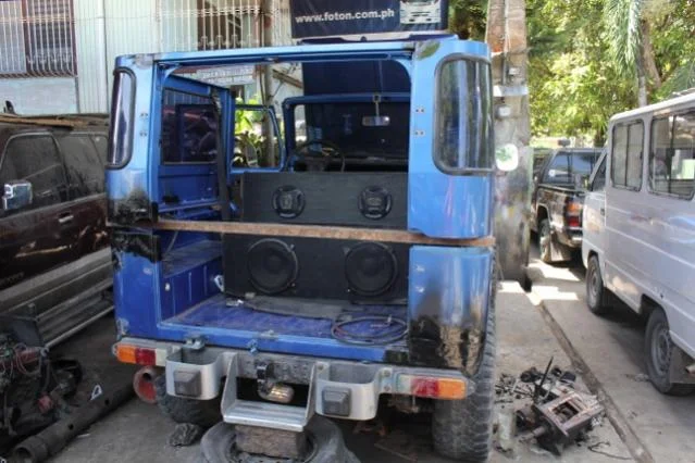

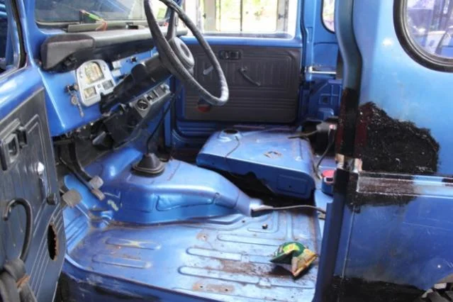

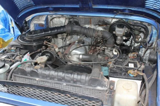

A few months ago I found a BJ40 and purchased it. These are some of the before pictures. The restoration is started and I will post more as I get time. This is the third time I've tried to get the pictures posted so after resizing them I hope you can see them this time. If this doesn't go try Facebook where I will try to post them under my BJ 40. This was basically a barn find that I got for cheap. The date of manufacture can not be determined, have asked every source I could think of but because we think it was for the Japanese market and converted here, nobody knows...The LTO papers from the Philippines say only that it was imported in 1997. I guess it doesn't make much difference, it's a good truck.

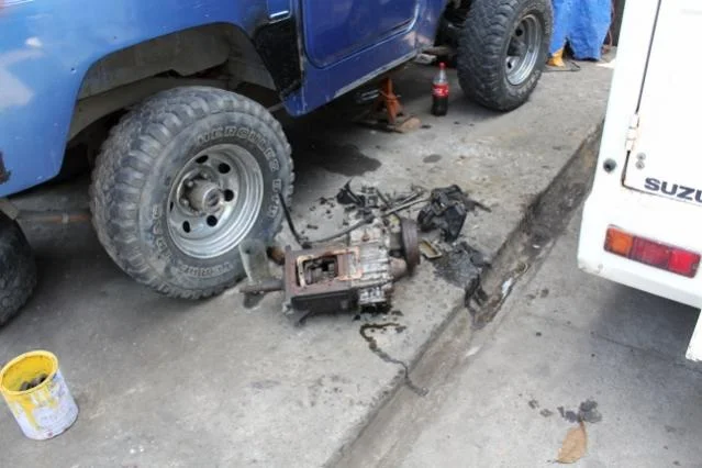

Just some pictures showing the rebuild, we have the top loose which we are going to take off and started treating rust. The transmission is pulled to convert from vacuum to manual, the block on the shifter plate is removed to allow me to be able to get a 2wd low, the springs have been sent off to get re arched, poly bushings have been ordered. As you can tell there is still a bunch to do...still have to fab doors and tailgate as I'm going to remove stock doors and top and go with a cloth top and don't want to cut on the stock doors and hardtop...looking for a pto winch and some other stuff.

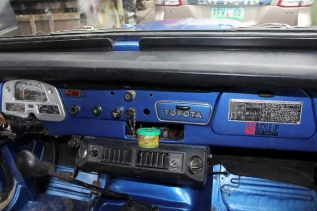

Welcome to the Insanity Coleman. Nice rig to begin with. I have a 74 Fj40 here in the Pinas and there are several members from Manila, Bulacan, etc. I live in Pasig. Your truck has no data plate on the passenger side firewall where the heater motor would go? Mine is a Japan import but still has the data plate.

strange that have a square bezel but the fuel tank still inside the tub,not below floor like the correct models ..if that means something
Good luck bud, I'm up in Olongapo. I'll be picking up a MWB unknown bj when I get back. To bad we're so far apart.
Yeah.
Looks like almost everything is late-model except for the tub and fuel tank ... which are early-model.

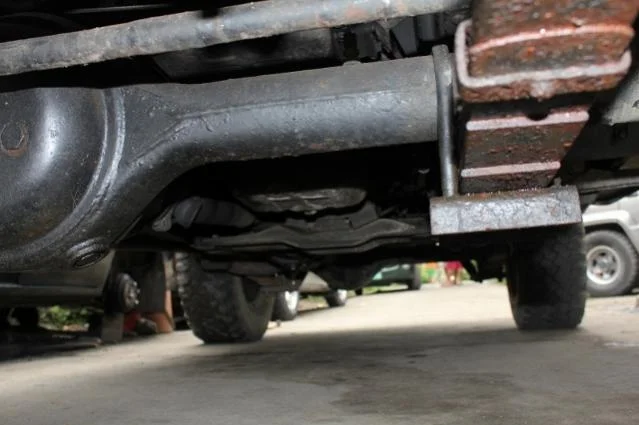

Went out for a beer with Michael, my partner in crime and the one who's shop I'm using for the rebuild, I think we decided to replace the engine with a stronger one, probably Isuzu turbo as I like them for reliability (a thousand jeepneys can't be wrong) we will preserve the "B" for posterity in keeping with saving the old parts. We still can't find a PTO winch so may put a Warn in. In the pictures the black spots are an Epoxy that we are using for the patch's that we are welding in after cutting out the rust. I find it works better in the long run to prevent the rust from coming back. Just some thoughts from where this thing came from, notice that the snorkel was on the left side, the wrong side for a diesel, could have been put there for looks? Suspension has small bushings instead of the large one of a later BJ, B engine is early, PWR and A/C is late. 24volt system? No wing windows in door I think that is later. Actually, in the end it doesn't matter. Oh, I almost forgot, the Eng. number is 0171654 and the Frame number is BJ40014114....more shall be reviled in time....:steer: Lee

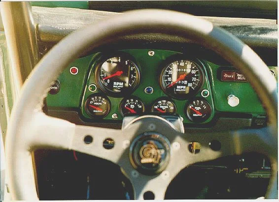

The dash we are going to copy
found this on the web (or maybe here) we are going to copy this for the dash by making a new panel (saving the old gauge's) Going to pull body this afternoon and start on frame..Semper Fi

Looks like a diesel transplant, if you have power steering it's 1983 if none the rad is an 83, body looks like a gaser. The motor will have markings of B or 3B.

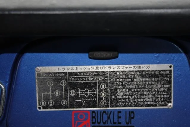

I have never seen a BJ that had a three speed. Thought those were all four or five speeds The data plate on the pocket door shows a four speed but transmission next to the vehicle looks like a three speed to me. I also thought the input shaft on the transmissions mated to the B engines was longer besides just havin a different spline count. Either way it looks like a pretty clean cruiser your starting with.

I know about the three speeds being used for many years later then the US in some markets. It's just that the B engine needed a different import shaft on the transmission. Just never the diesels with a three speed. Plus the shift pattern on this one shows a four speed.
Agreed, I never knew a diesel to have 3 speed and I believe you are correct the input shaft is different.:cheers:
4 speed

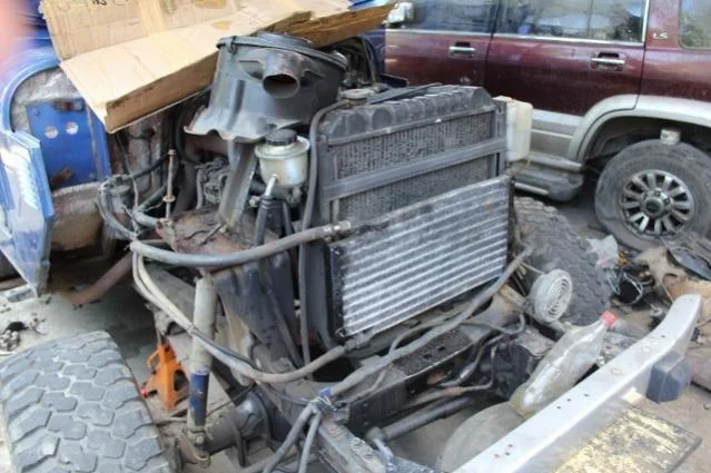

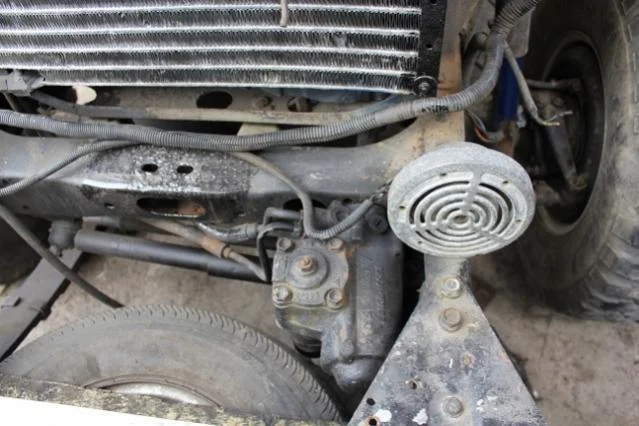

It's a 4 speed, stock, will get more pictures today, the pwr. steering is definitely a add on as is the AC, we were discussing it last night and one of the reasons the turning radius is so large is it needs a longer Pittman arm. We feel sure we can scroung one of those. The body comes off the frame today, the poly bushings are here but we are not going to install them until after paint. The springs are arched and give me about 3" more clearance. We were going to put 35's on but may go with 33's in order for the overall final ratio to stay lower. If I stay with the "B" engine it will matter, if I go with the Isuzu it won"t. I really appreciate you guys chiming in, you have helped with the identification tremendously. Stuff I have little knowledge on. Got to go the frame is waiting, will try to upload the pictures tonight or tomorrow, I have to re-size all of them, I'm using a Cannon 60D for the shots...Thanks Lee..PS Rob I'll pm u on the shops in Manila

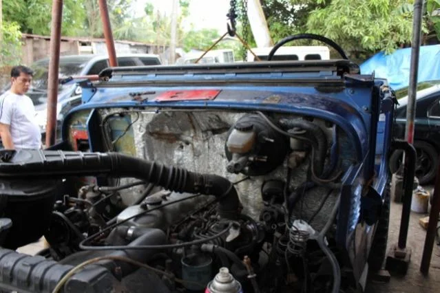

Just got back from working on the BJ, got body jacked up off the frame and started wire brushing the frame. Took some pictures of the pwr. steering, the direct shift linkage that we swapped without the blocking plate. Notice the red panel up on the cowl, thats the original color, when I found that it cemented the decision for the color. I found a pic on the internet of what the front of the truck will be similar to when we get finished. I like the round turn signals and the round grill (bezel?) I think it ties the front together. (been watching too much Chip Foose). Also give me your opinion on putting a 2H 6cyl. in it. I found a really good deal on one complete with transfer case and 5speed trans. out of a 60 series I think. If I'm not wrong I will have to shorten the drive shaft to accomplish this but thats not too much trouble in the scope of things.
