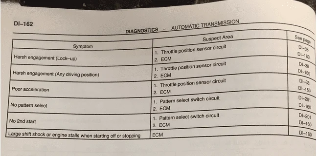

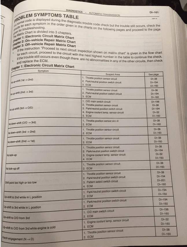

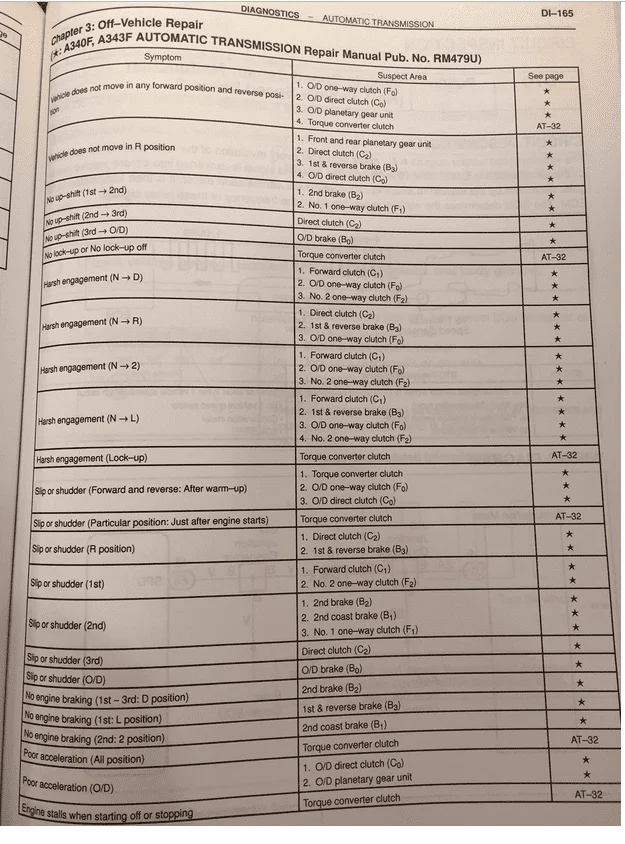

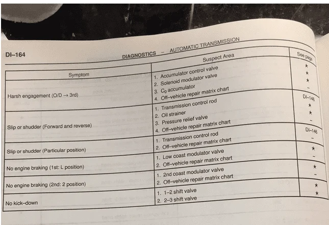

From a 2000 TLC FSM (USA spec)
No reverse means low on fluid or clogged filter.
No upshift means low on fluid or clogged filter.
Working reverse but no upshift means solenoid or clutch issue.
