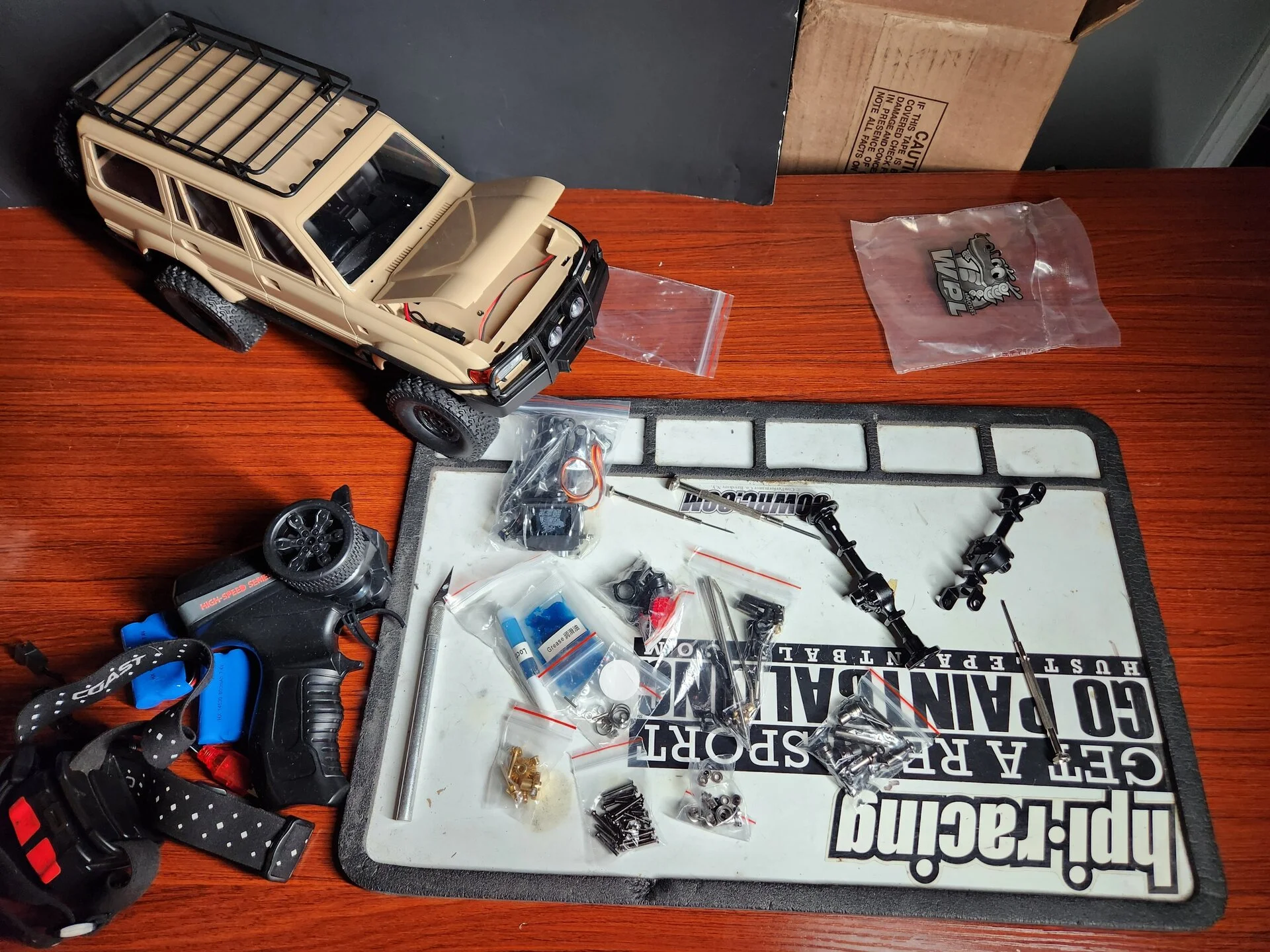

Given how garbage the original driveline components felt, I opted to immediately order some spares and the metal parts upgrade kit, as well as the metal gear servo they offer on their site. The package shipped directly from the manufacturer to my mailbox in a bit over a week.
Silly me for thinking the axles would be machined, they're cast of the finest ???. I will say that the castings are quite good for the cost, as I assembled the upgrades I found that everything fit correctly without any struggles. Those with larger or less dexterous hands may struggle with the tiny parts, and once again the instructions lacked in detail. All that was included for documentation was exploded diagrams, not a step by step guide. That said, there is a video on their website that I didn't watch, but I'm sure it would be helpful. The included grease and threadlocker was a nice touch, and there was way more hardware included than what was needed to complete assembly.
The metal axles and servo combined have made the WPL C-54 feel like a much more substantial model. There is far less slop and I have greater confidence in the durability of the vehicle. The turning radius also noticeably improved, as the throw on the new servo arm is a bit longer.

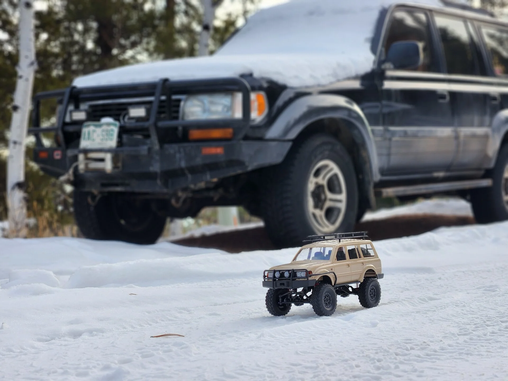

Upgrades installed, I took it outside for some poser shots:

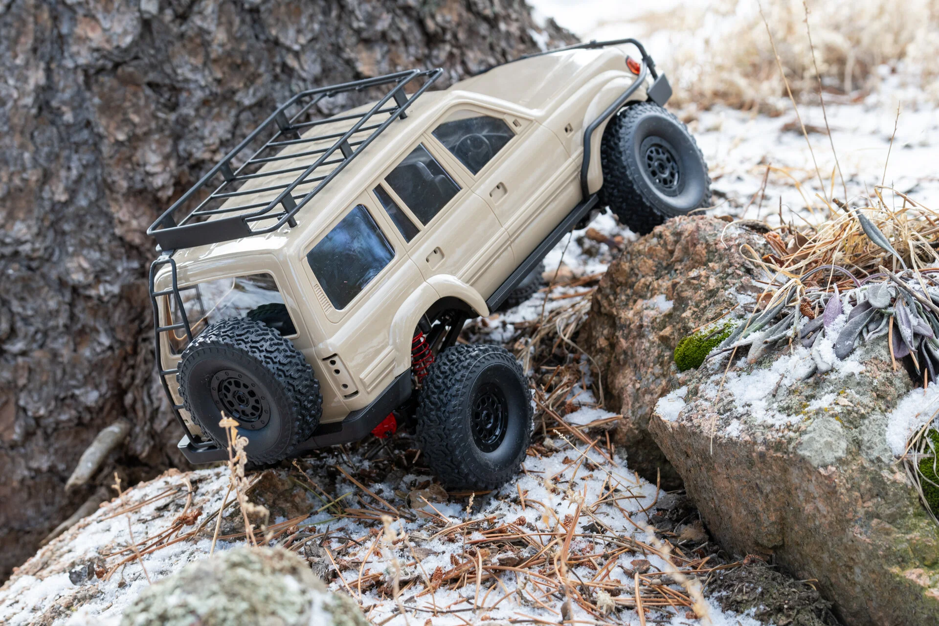

Can't wait to get this thing onto the rocks and see how it performs in its intended environment.
