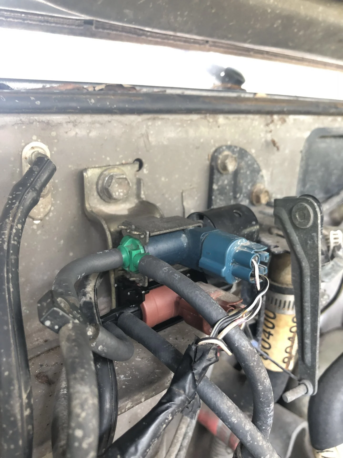

Replaced the solenoid with another Toyota one from another thread. I’ll get the part number when I’m back at a desktop. No change in behavior and no lucky green 4x4 light. I’m thinking either that wire into the red VSV is dead or the switch at the dash ain’t doing jack.
View attachment 2727159Replaced the solenoid with another Toyota one from another thread. I’ll get the part number when I’m back at a desktop. No change in behavior and no lucky green 4x4 light. I’m thinking either that wire into the red VSV is dead or the switch at the dash ain’t doing jack.
Does that new VSV pull vacuum now when the switch is pushed?

Something is preventing the vacuum diaphragm on the transfer case from actuating four-wheel drive.

It doesn’t send a vacuum feed out but it’s getting the same feed in, so I think the switch isn’t happening electronically.
If you switch the vacuum lines the switch doesnt do anything. Even the light is controlled by the vacuum actuator in the transfer case.

So if the red vacuum switch never sends a signal and switching the lines also doesn't engage the switch, what's the next point of failure to investigate?

The diaphragm on the tcase, if i'm following this thread correctly.

Again, it doesn't matter, because when you switch the at the correct VSV, constant vacuum is sent to the diaphragm on the case, which should cause it to engage 4wd.
