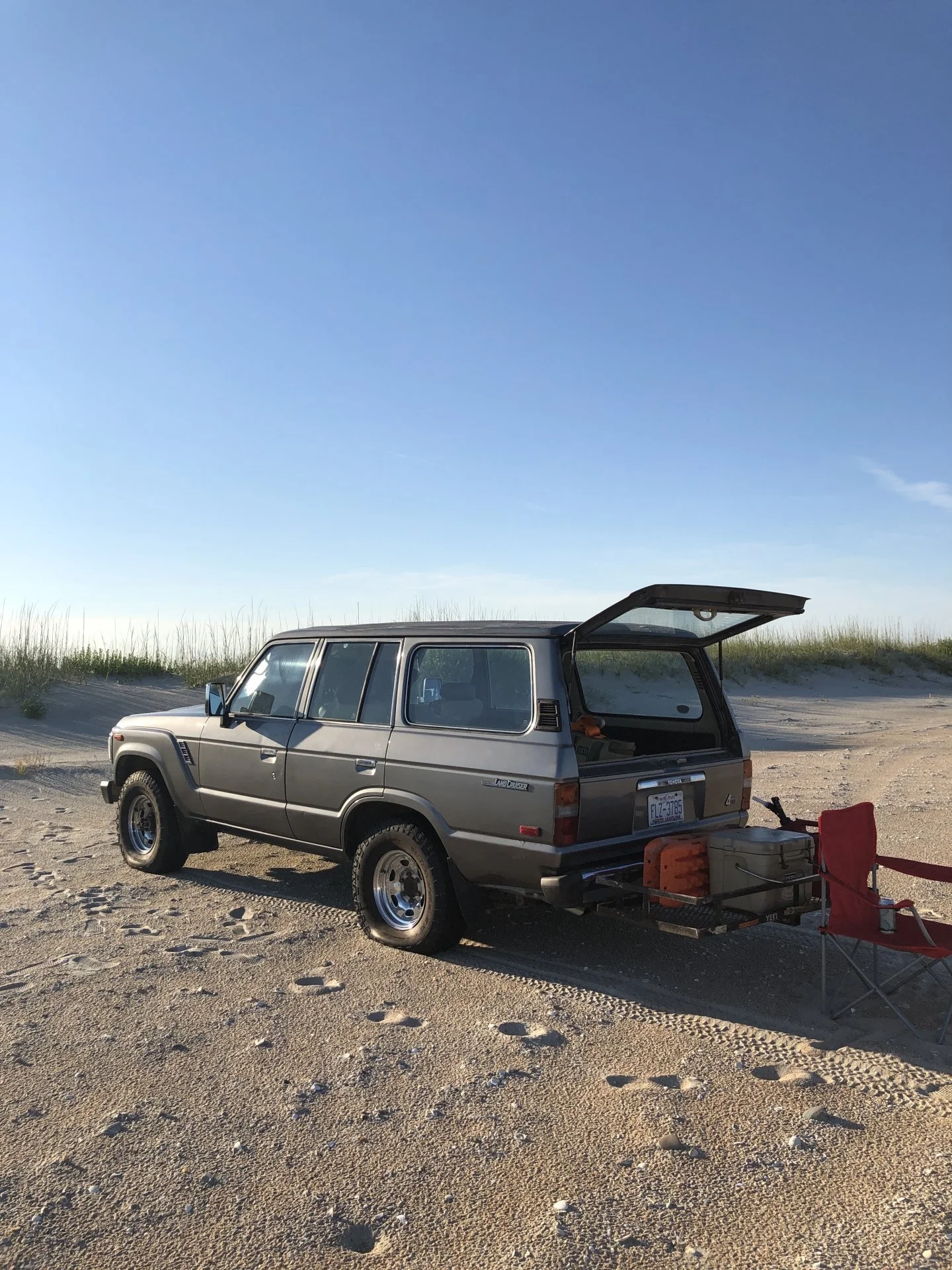

My FJ62 feels likes it’s 1 wheel drive out at Cape Lookout

Nearly lost the truck to the ocean today, I’m not sure my front axel is engaging at all and when the rears lose it they instantly bury the truck to the axel. I think the original design is open diff and I’m struggling so hard for traction everywhere even with 10psi each tire.
Is front drive engagement a common fail point on these trucks?
