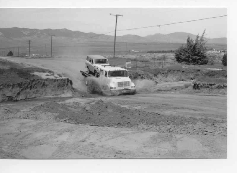

No, this little piggie hasn't been up for sale for a long time. Second owner bought this one from an Exec. at Toyota of Hollywood who drove it for a couple months...He then parked it on the Tejon Ranch in '80 or '81...got driven about twice a year until about ten years ago when the mice that inhabited it decided to go all out and eat a whole lot of anything important. This guy restores his old wagoneer and replaces the Fj55 with it as his hunting truck. He then GIVES the Landcruiser to a friend of mine for FREE!! Even claimed he tried to give it away to some of the ranch hands and nobody wanted it!! I went with my buddy to go pull the thing off of the ranch,and the guy even put the thing on his towing service and had it towed like 90 miles for free!! I then later bought the truck for $$$$$ considering it was coming from a good friend(who paid zero for it), But I Had TO have it...
Here's a pic of the 55 on it's way off the ranch...
Very cool story - get us pics when you can...
