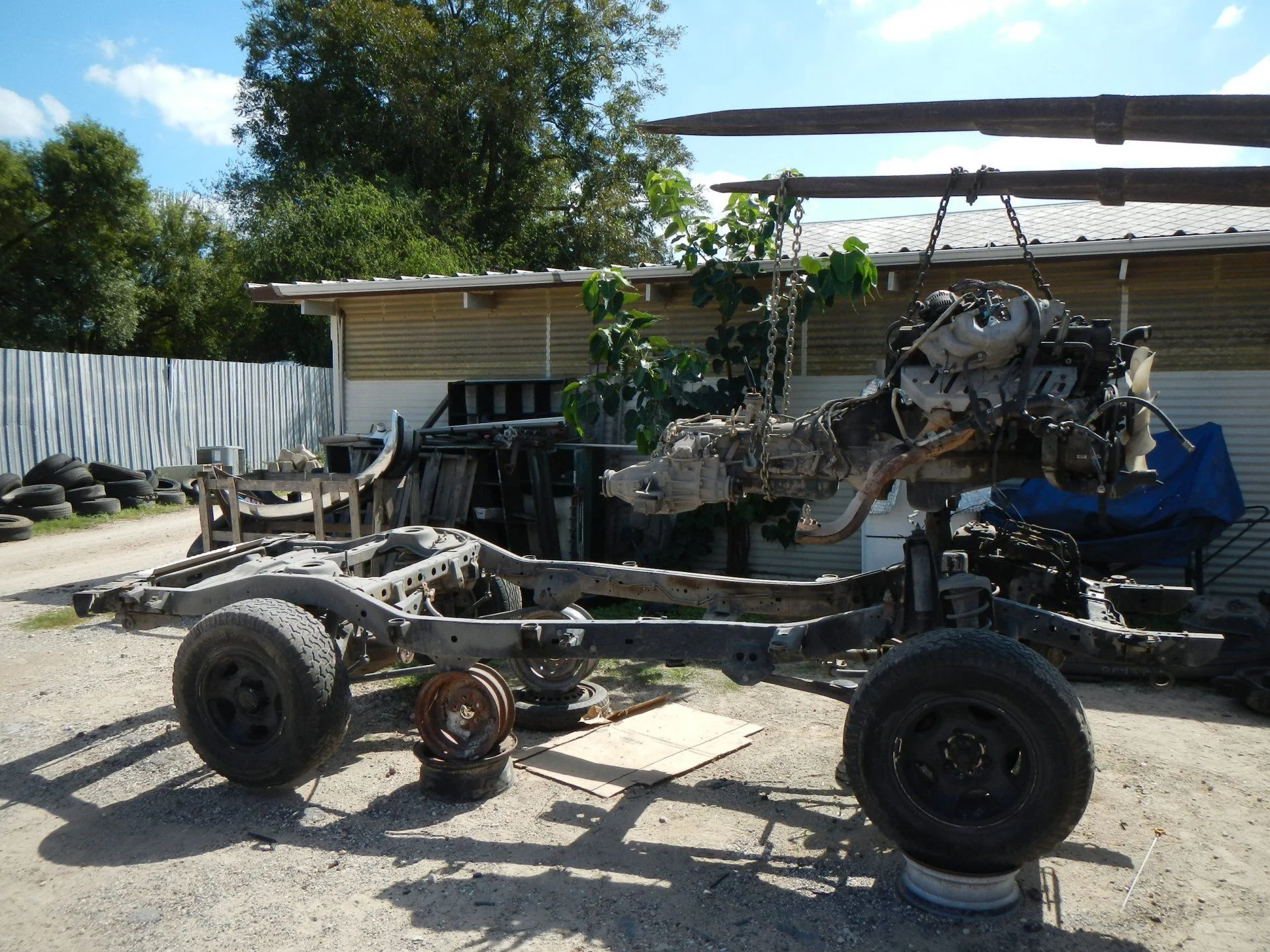

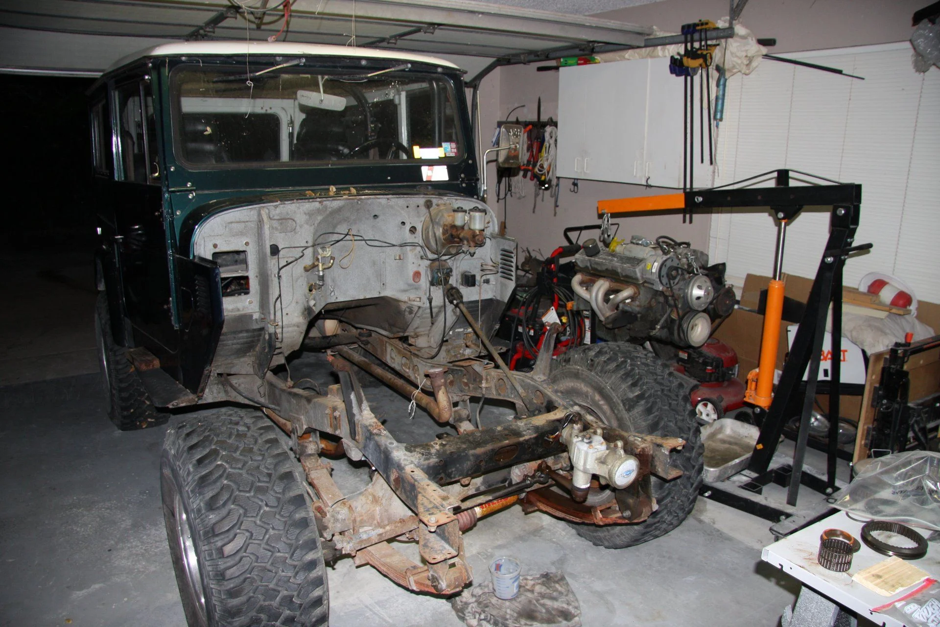

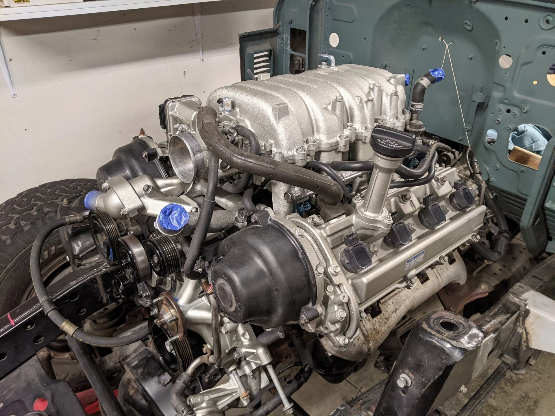

Here's a picture of my 2UZ-FE from a 2005 Landcruiser (non VVT-i) I've got a rough idea of where to place the 2UZ in the FZJ-80 frame from reading @2fpower's VERA build, so a big shout-out to him for laying the groundwork of figuring out the engine placement. If any of you have a stock 80 series Landcruiser, would you mind verifying the angle of the transfer case's rear output flange for me? I'll be shooting for @2fpower's final angle of approximately 2.8 degrees, but want to ensure that I orient the engine/transmission/transfer case parallel to the rear pinion flange. My rear pinion flange is at 3.6 degrees with no weight on the vehicle.

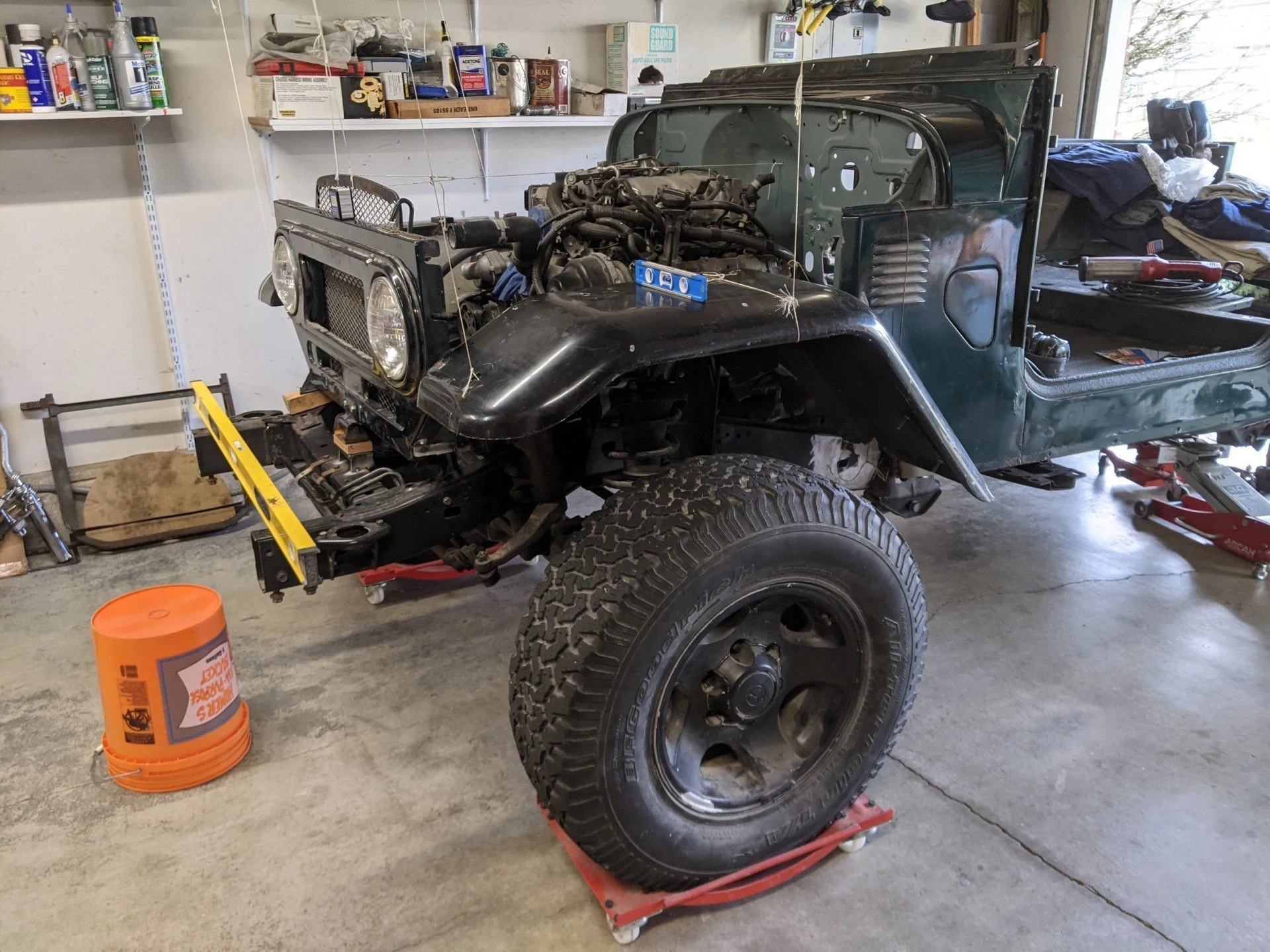

Slowly making some progress. Here's how I have everything lined-up at the moment, with the front half of the body temporarily mounted to the FZJ-80 frame.
Boots, I am highly offended at your suggestion to name my rig Pinocchio, as he is best known for his propensity for lying. :) Although I must admit that I do like the Geico commercial where Pinocchio is a "motivational speaker". I think I'll keep my rig named the FJ42UZ for now, seeing as how my plans for it include almost a 2-foot extension (the FJ42 comes from 40 + 2), plus the fact that it'll be powered by a 2UZ. I haven't purchased the Dakota Digital gauges or ARB lockers yet, so luckily haven't had to "stretch the truth" as to the cost of anything on my project quite yet.
Getting the fenders to line up on the FZJ-80 frame was one of the biggest hurdles I've had thus far, especially when it came to trimming the driver's side fender to clear the power steering box, coil bucket, and shock tower. The strings definitely helped as an extra set of hands to hold everything in place while I was getting everything mocked up.
Nothing major, other than getting a stand-alone wiring harness made for the 2UZ-FE motor. The wiring harness was completed by Tim from Lextreme. Tim's website can be found at LexusV8.com, and I highly recommend his work and attention to detail. Other than that, I'm in the middle of a kitchen remodel and my garage is full of sawdust at the moment.
