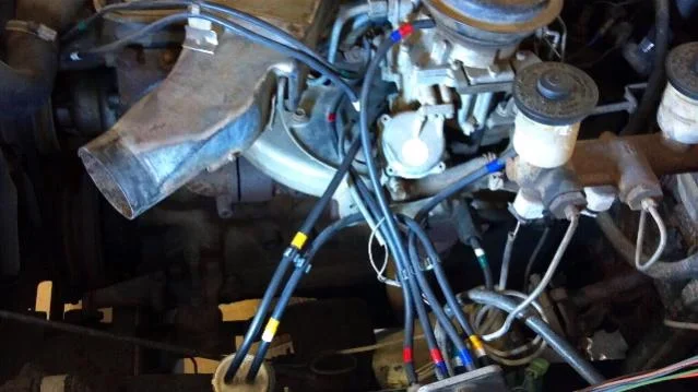

I have been the proud new owner of a 4/75 FJ40 for just over a year. I am in the process of replacing the wiring harness and would like to remove the emissions control computer as well as the vacuum switching valve if possible. From what I can decipher from the photos, isometrics, and schematics is that this FJ40 has been desmog'd. But not knowing its complete history I am unsure if it was desmog'd properly. I have attached a photo, color coding all vacume lines, to facilitate communication. Also for clarification, the VSV is coded as follows; 1 is the white/green vacume line, 3 is the blue, 5 is the red, 6 is plugged, 7 is plugged, 10 is the white/yellow, and XX the charcoal canister. I hope the combination of description and photos make this process much simpler and thank you all for past, current, and future experience and knowledge.
Somewhere in the middle of South Dakota
Bug,
This thread is primarily directed at the 79-newer 2F w/ catalyst. There is little in common with the simpler 78-older truck.
FWIW, a 75 carb needs 3 vac fittings (AAP, PV, CB) connected to manifold vacuum. There is also a ported vac fitting, that will be capped off for now. Someday, when the stock vac retard dissy is upgraded to vac advance, it can be connected.
