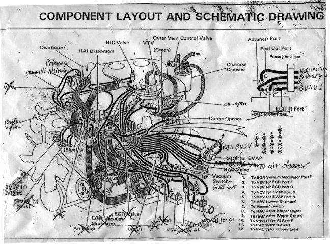

Rad the from of the emissions manual where there is a list of all the parts. Learn what the letters like HAC or HIC or BVSV or VTV or VCV mean. This helps like all these things together to make alittle more sense.

Don't forget JimC's document for the desmog this was the key for me.
This one?
attachment.php
Yes but there is also the entire desmog document that JimC and a couple other forum members put together as a walkthrough on how to do it... It is in my sign in the FSM link, How To Desmog an FJ60. That thing was a lifesaver for me and gave me all the steps necessary.
This one (attached).
