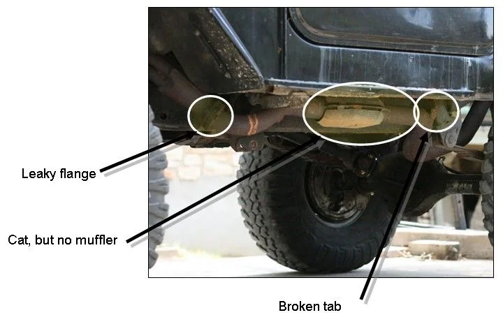

I took the 40 to my local Sticker Stop to get inspected. I did not pass, but it won't be difficult to correct the issues since I'm getting a new muffler installed.
Issues:
  • Driver's side turn signal does not flash. It flashed before, but I guess the 30 year old flasher decided to not work.
  • Exhaust system has leak at flange.
  • Cracked mounting tab and missing muffler
  • Parking brake almost meets 1000 rpm spec. I didn't know there was a spec like this. It holds, but under light throttle in 1st gear, it fails.

Got a new muffler installed over the weekend and also fixed the blinkers. I took it to get reinspected and it passed!
