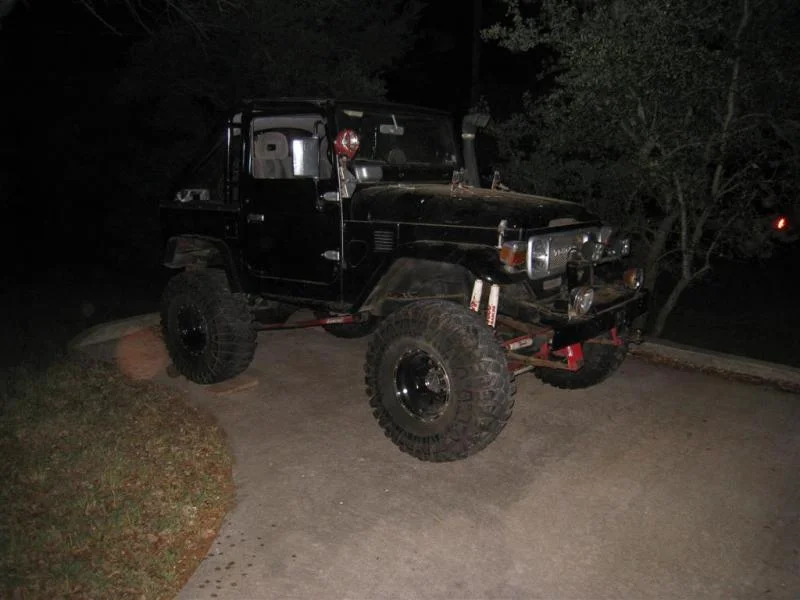

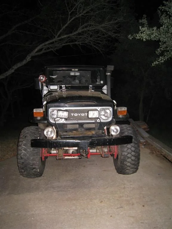

Well, I thought I'd start a build up thread on my new-to-me FJ40 that I picked up a couple of weeks ago.
It's a 1979 originally from South America. Came with 37" Maxxis tires and Pro Comp rims, Safari snorkel SOA, disk brakes up front with rear drums, and a bunch of other booty-fab'ed South American touches. The engine had apparently thrown a rod which was self evident from looking at the big hole in the oil pan.
My goal is to get it on the road (new engine) and to make it half way decent looking.
The pictures below show how she looked the night I got it. I've since removed some lights and the buggered up winch mount.

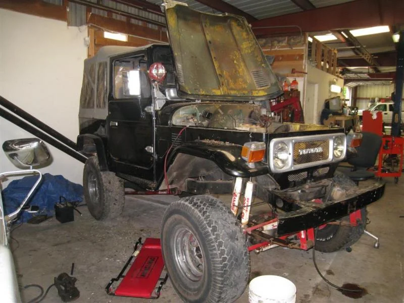

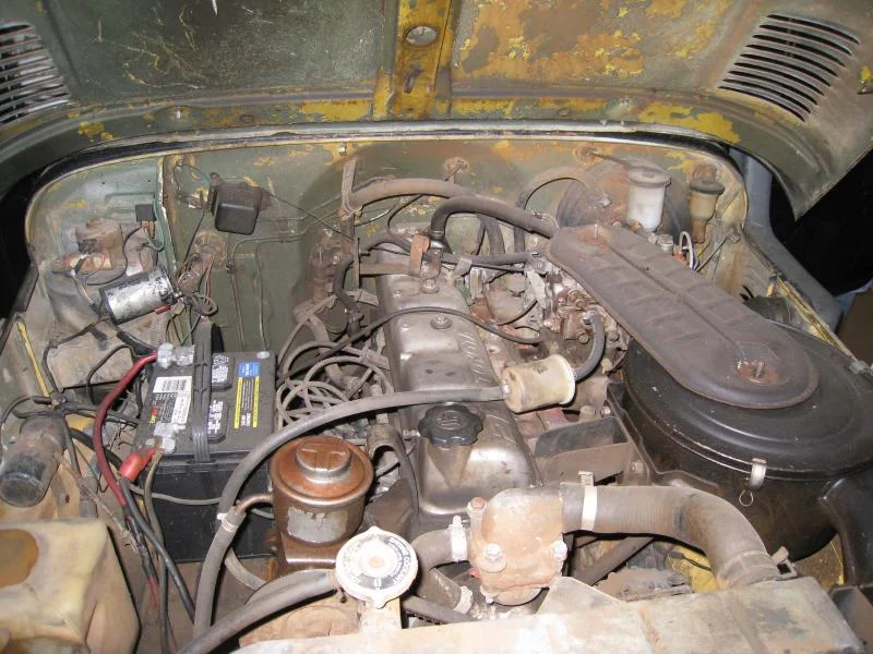

A buddy of mine had a 60 he was parting out in his shop with a strong running 2F. I bought it and did some horse-trading with him for installation of the engine. He got the gigantic 37's in exchange.

My friend that is doing the engine swap is going to install a new rear main seal, water pump and seal, side cover gaskets, and new clutch.

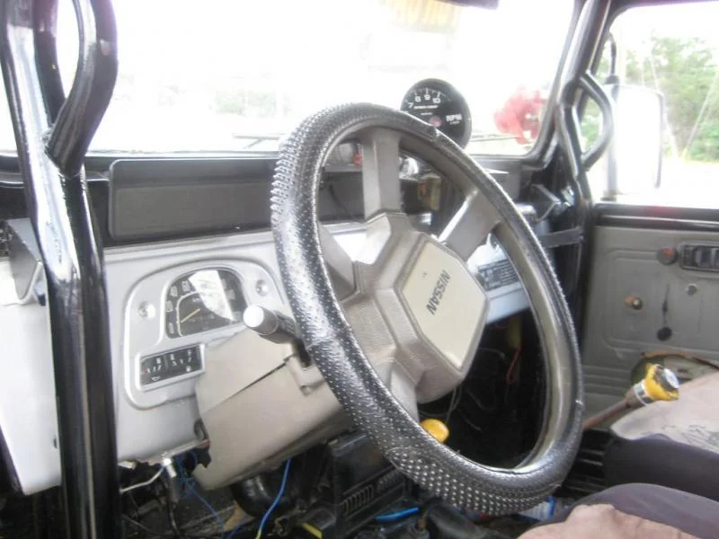

Here are some pics of the interior. It's lined with a plastic diamond plate looking carpet/liner. Under it is felt and some minor surface rust. I plan on removing the liner and spraying some bedliner.
You think the splines would be the same (Nissan=Toyota)? I think Tucker has an extra one in his man cave.
you could probably put an FJ60 steering wheel right on that column...

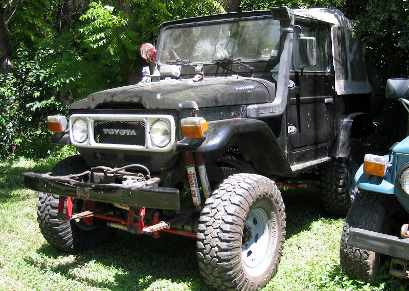

Just a quick update on what's been done so far. My buddy, Edwin, has finished installing the 2F and is now running. She needs a new carb (ordered one from Trollhole) and need to install the 4x4Labs high steer setup.
Here's a pic with the 35" Maxxis Bighorns.
