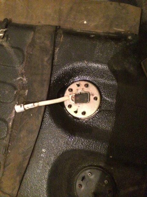

Ok so my other package arrived and finally got to switching my old aux tank sender unit to the needed and correct petrol / gasoline one [ 83320-69215 ] with 3 pins.
I did spray the screws with some liquid wrench and the old screws came off without a struggle
View attachment 1043930View attachment 1043931
Time to drop the new one in. I must add that the 5 screws does have a preference on how they line up
View attachment 1043932View attachment 1043933View attachment 1043934View attachment 1043935View attachment 1043936View attachment 1043937

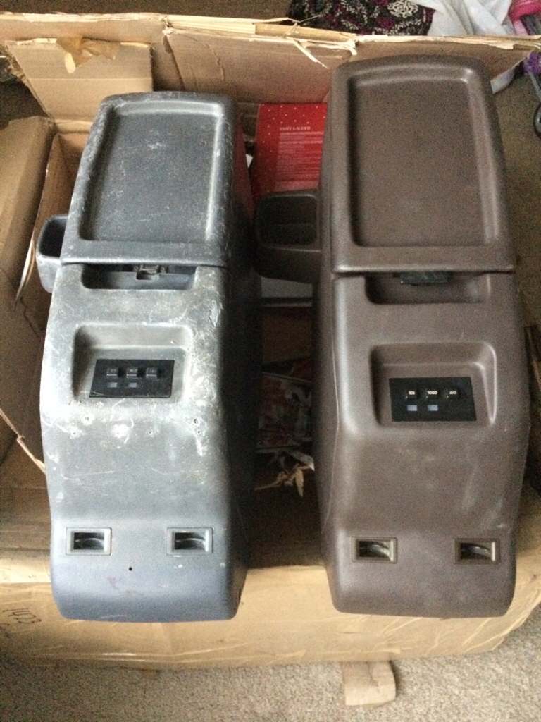

Also came the other cooler box, I got this other box because it was a package deal and I needed the lines, not the box. Well I guess a spare doesn't hurt and if my brown one isn't working ... I have the grey for parts in case the brown fails but I must say the grey one was pulled and working but the brown is in far far better condition View attachment 1043938View attachment 1043939View attachment 1043940
How much was the cooler? Where did you get it from?
@burbuja96 I got the grey one from @Akella with all the lines and electronics to basically install it oem into a USA truck. Problem is the Canada diesel trucks are right hand drive and our USA trucks are left hand drive. The issue is the one of the firewall piping needs to be extended as well as some other customization. If your interested in the grey one, keep in touch with me since I am working on something I think you (and the rest of the mud 80 series members) will find easy to use on your truck (doesn't require you to tie into existing ac lines, it will work off 12+ volt alone but keep the stock oem look)

Are you asking about the center cooler box ? Or the aux tank ?
