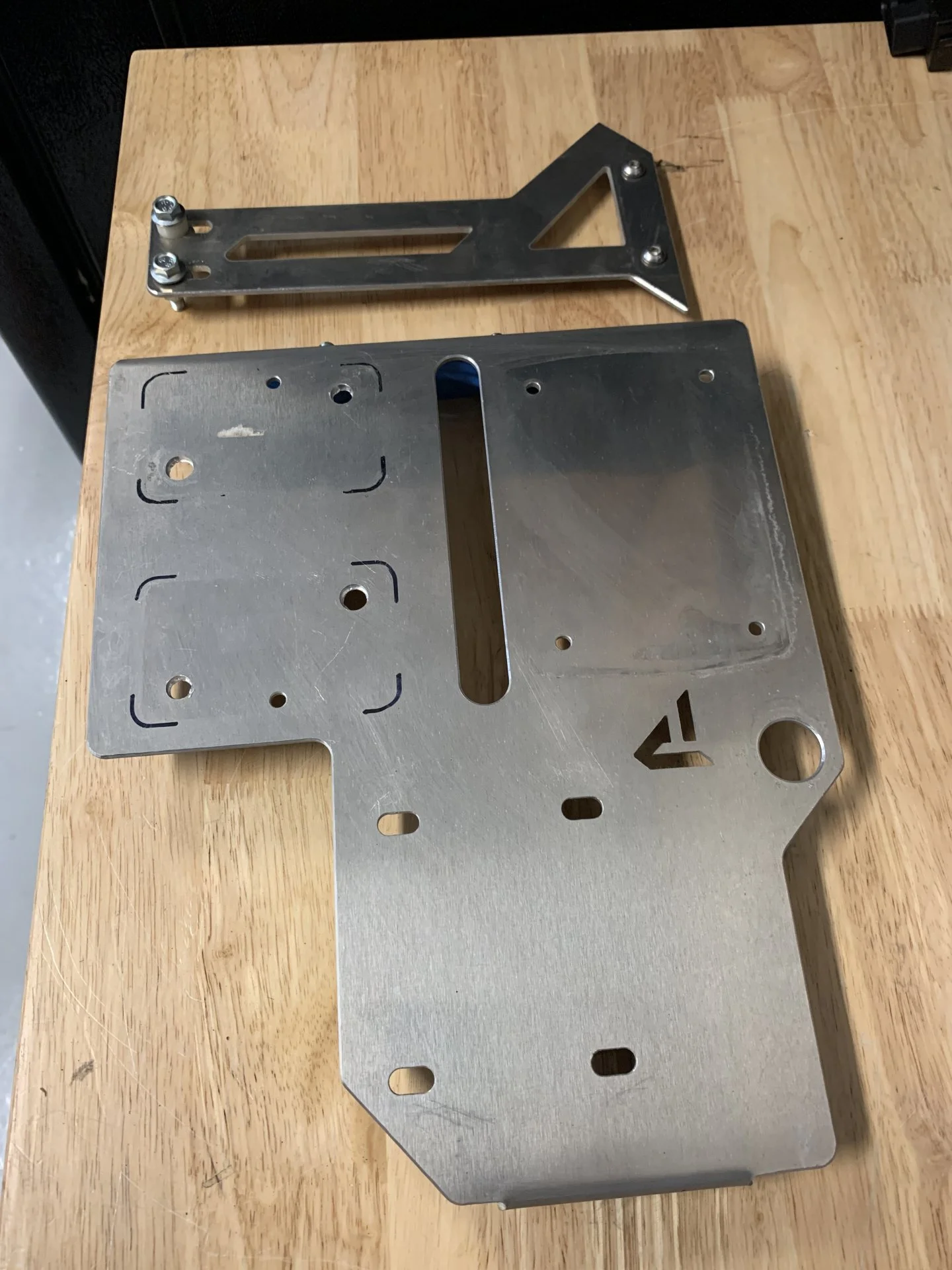

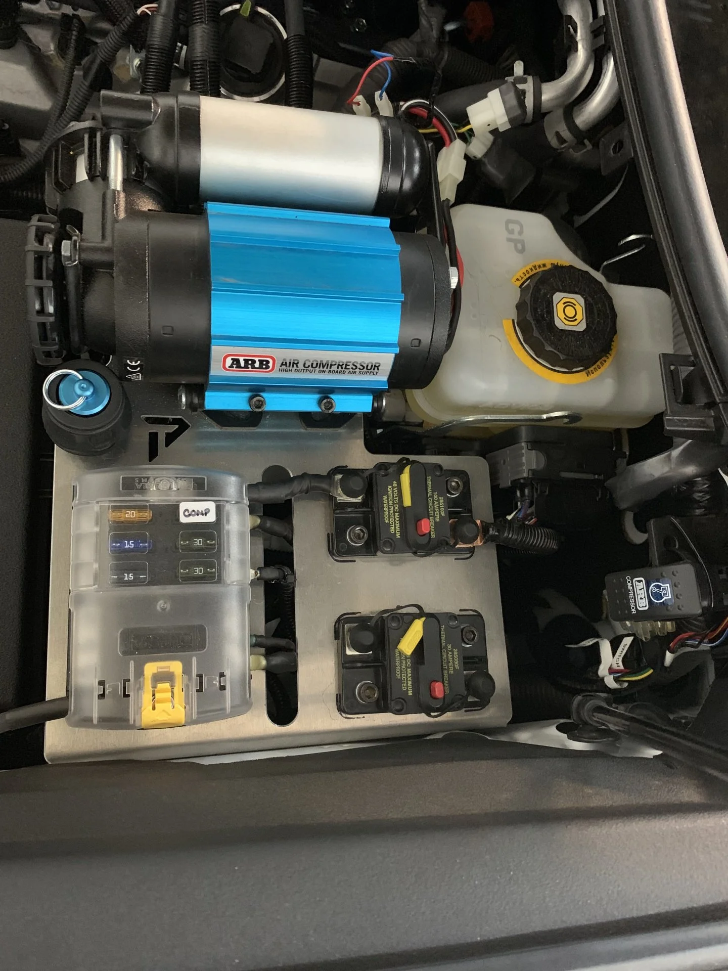

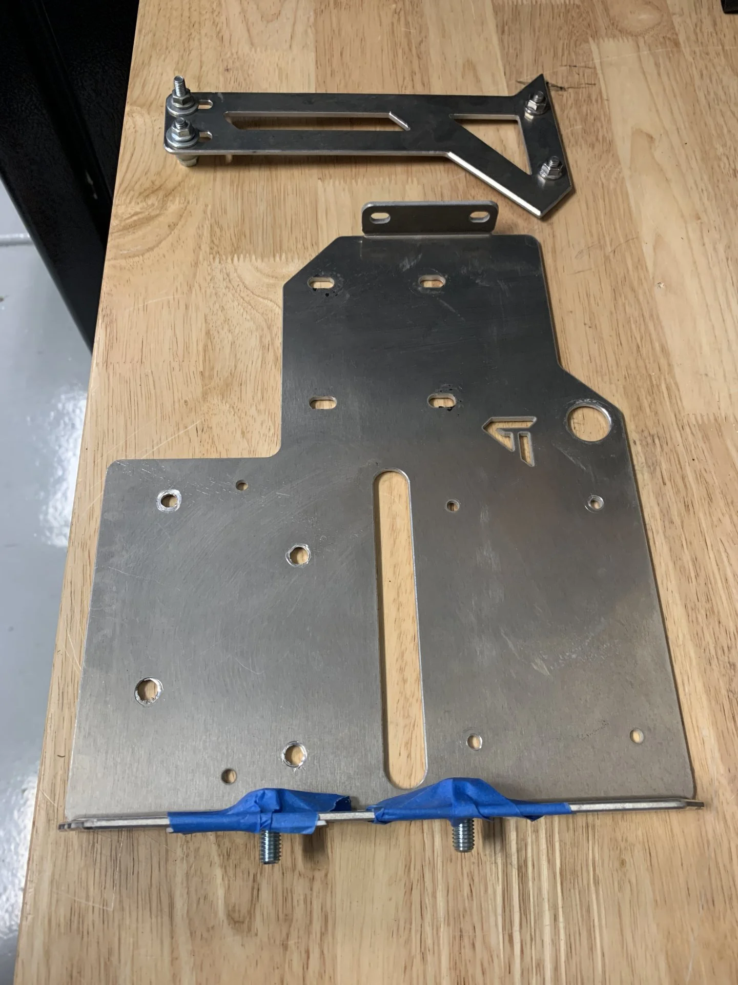

Built my own, 1/8 aluminum. This goes under my power tray is bolted using the same two fender fasteners and a bolt and stainless steel spacer from underneath.

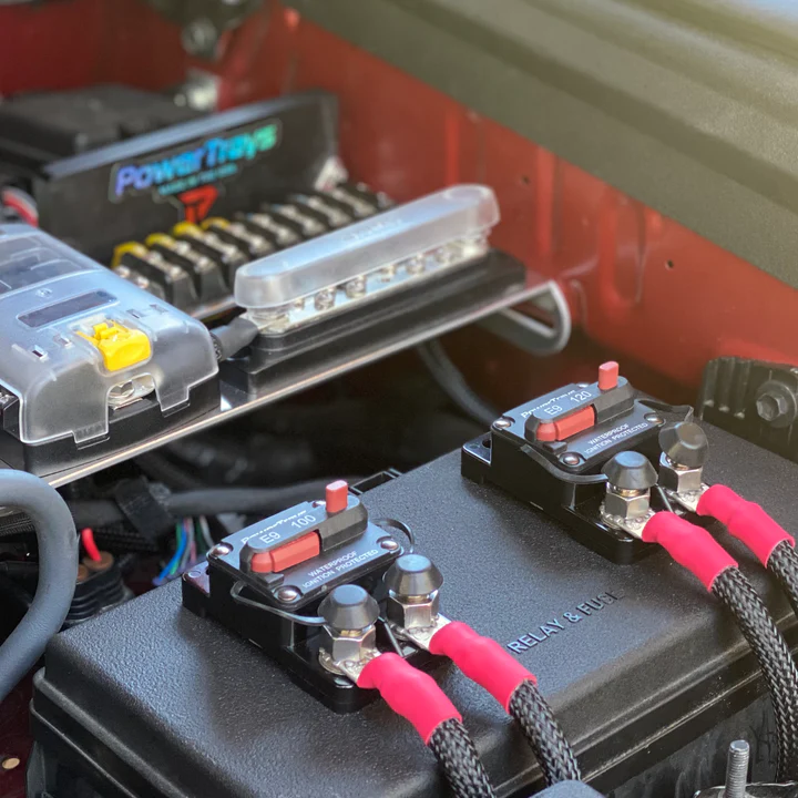

I'm looking at doing a similar setup with that fuse block and breaker. My compressor is in that spot b/t the fuse box and brakes, so I'm looking at mounting to top of fuse box. Some people just mount directly on the lid (PowerTrays Compact Waterproof Circuit Breakers - https://www.powertrays.com/collections/power-accessories/products/high-amp-waterproof-circuit-breaker).

I forgot about the height. That did seem like it might be a problem. I estimated it to be 2-3" based on the scale of the breaker. The clearance needed for the bottom wired breaker (flush mount?) could be an issue. That swayed me toward a top wired breaker (surface mount?) like those in the PowerTrays pic.

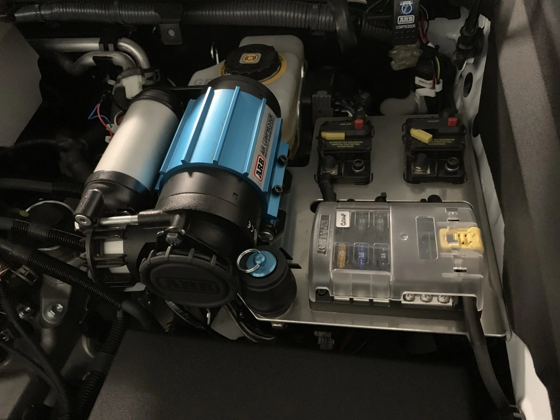

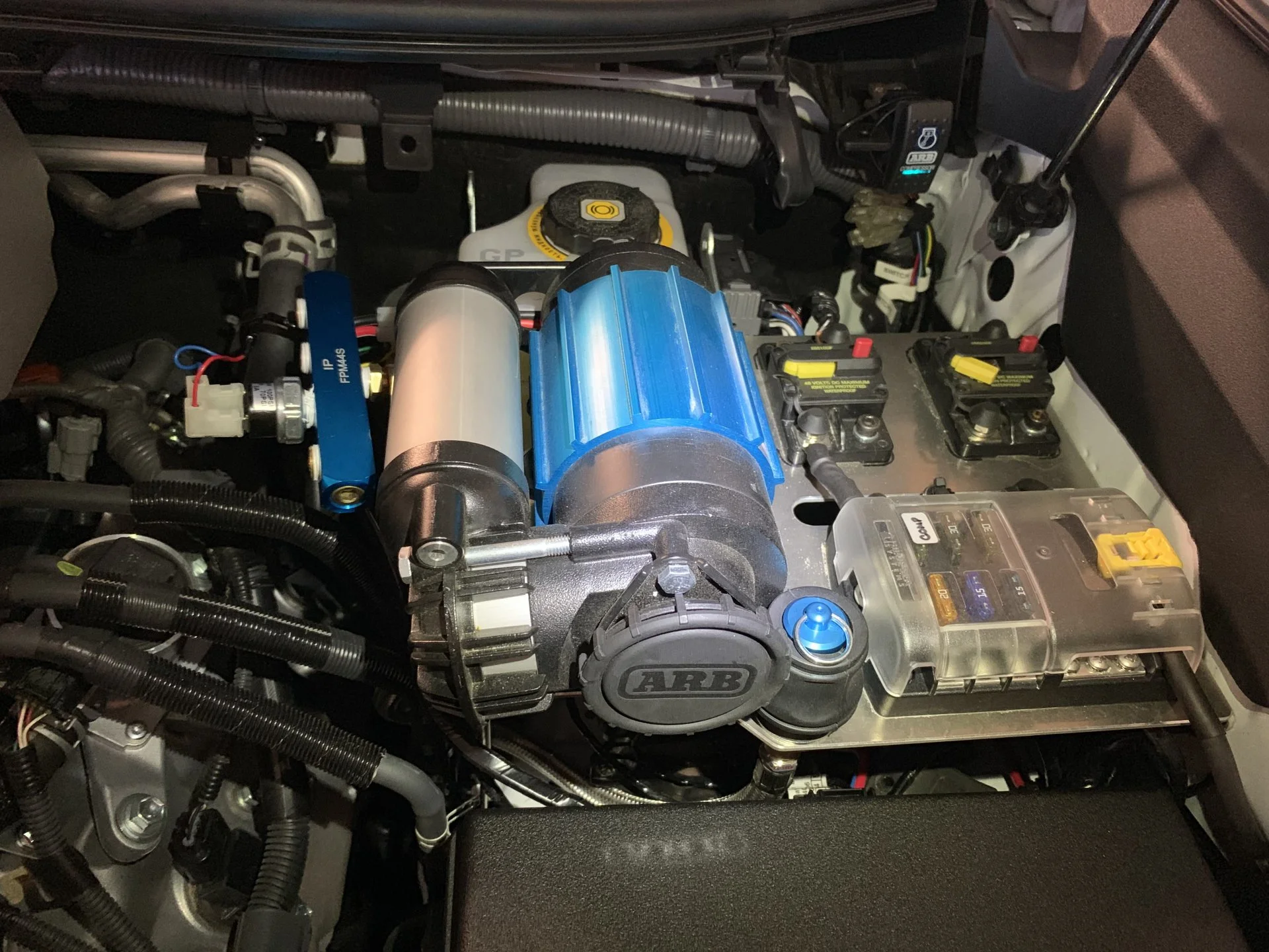

I mounted a blue sea fuse block and 2 breakers with a single arb compressor. I have this same tray for sale as i have sold my GX, ready to ship. PM if interested.
