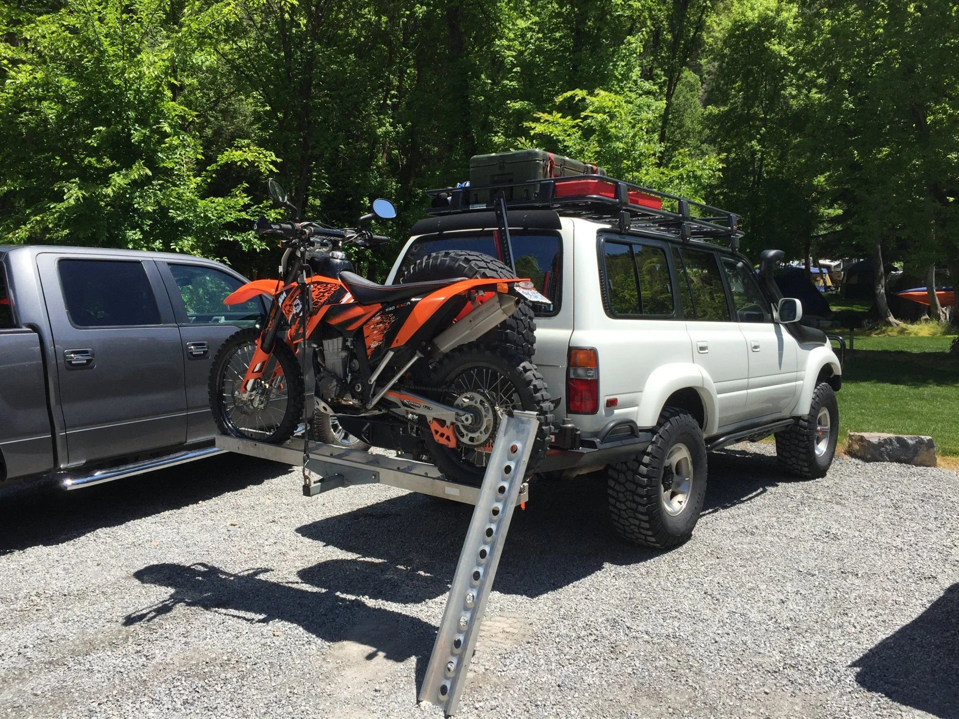

Slee with dual swing outs, I didn’t have the ladder on at the time, but it still fits. That is a big pig KTM 530, I carry a Beta 300RR now with no problem.

I forgot to mention that I put a receiver extension piece on the carrier to get it out past the tire. I don’t know the brand, I bought it used about 10 years ago.

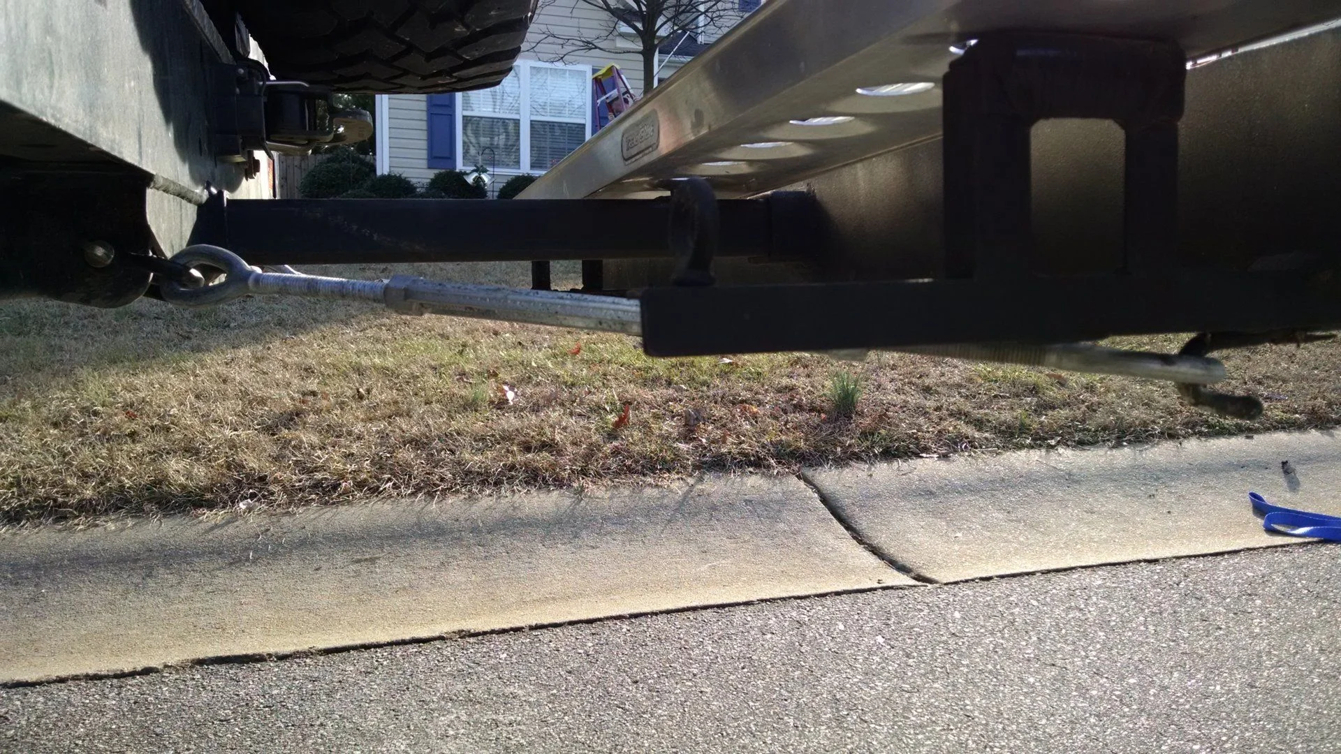

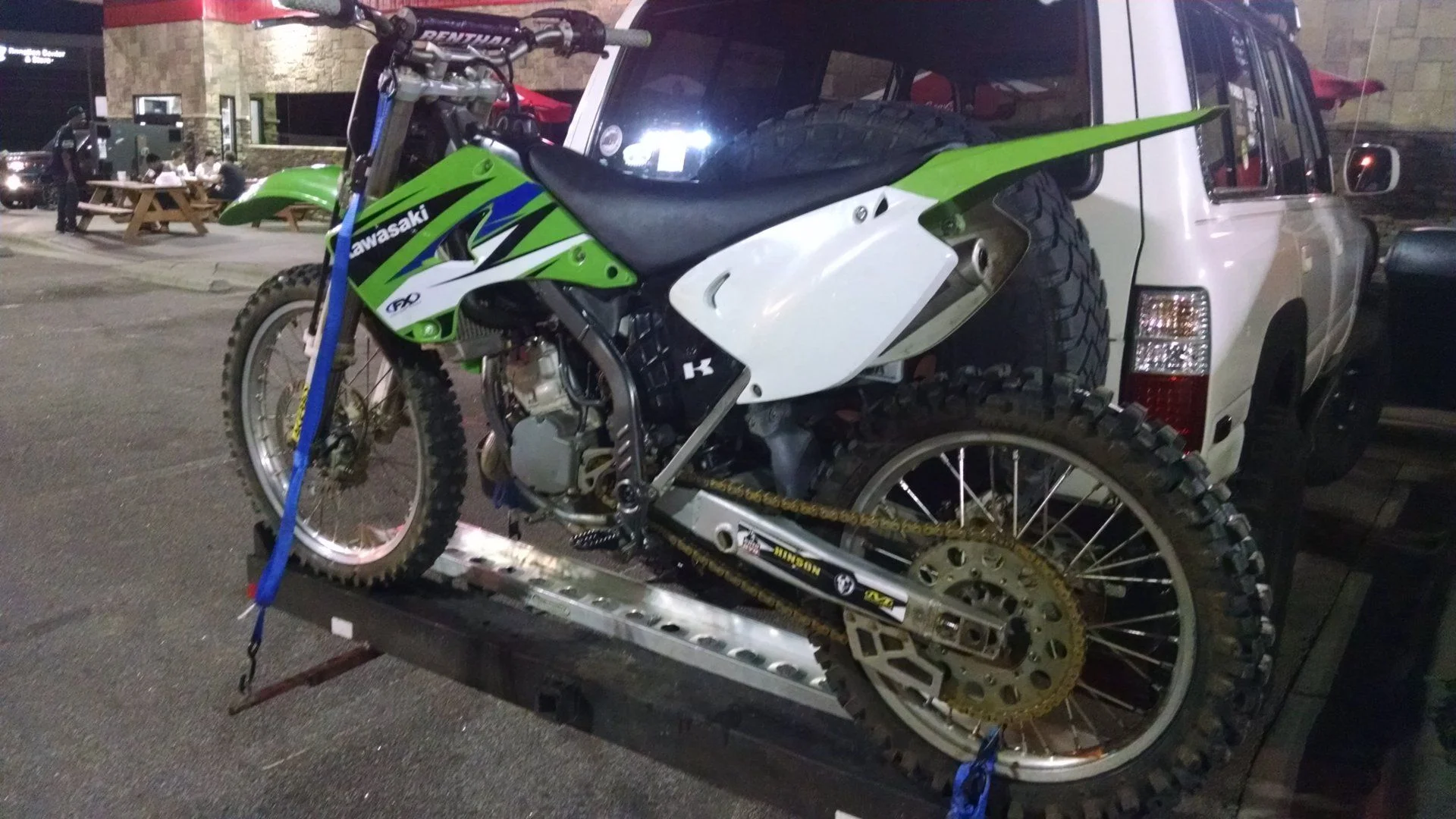

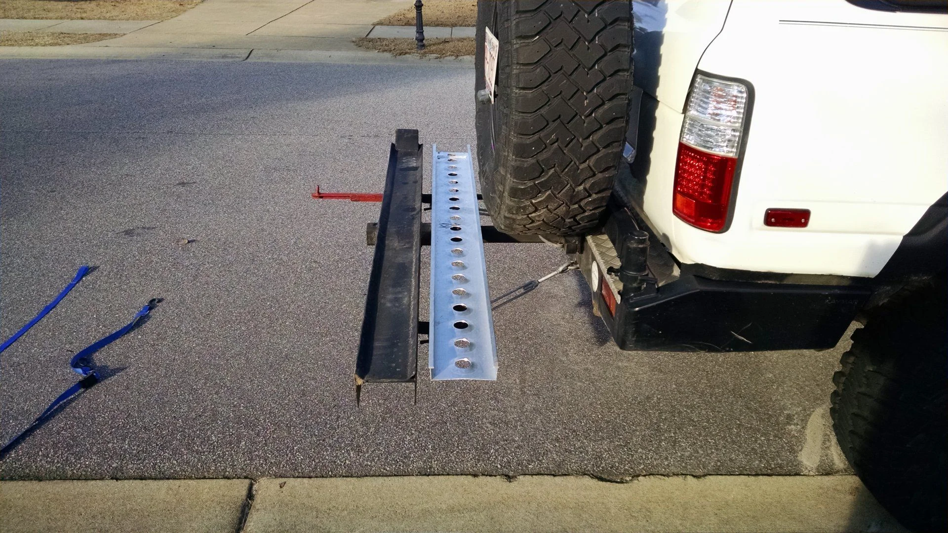

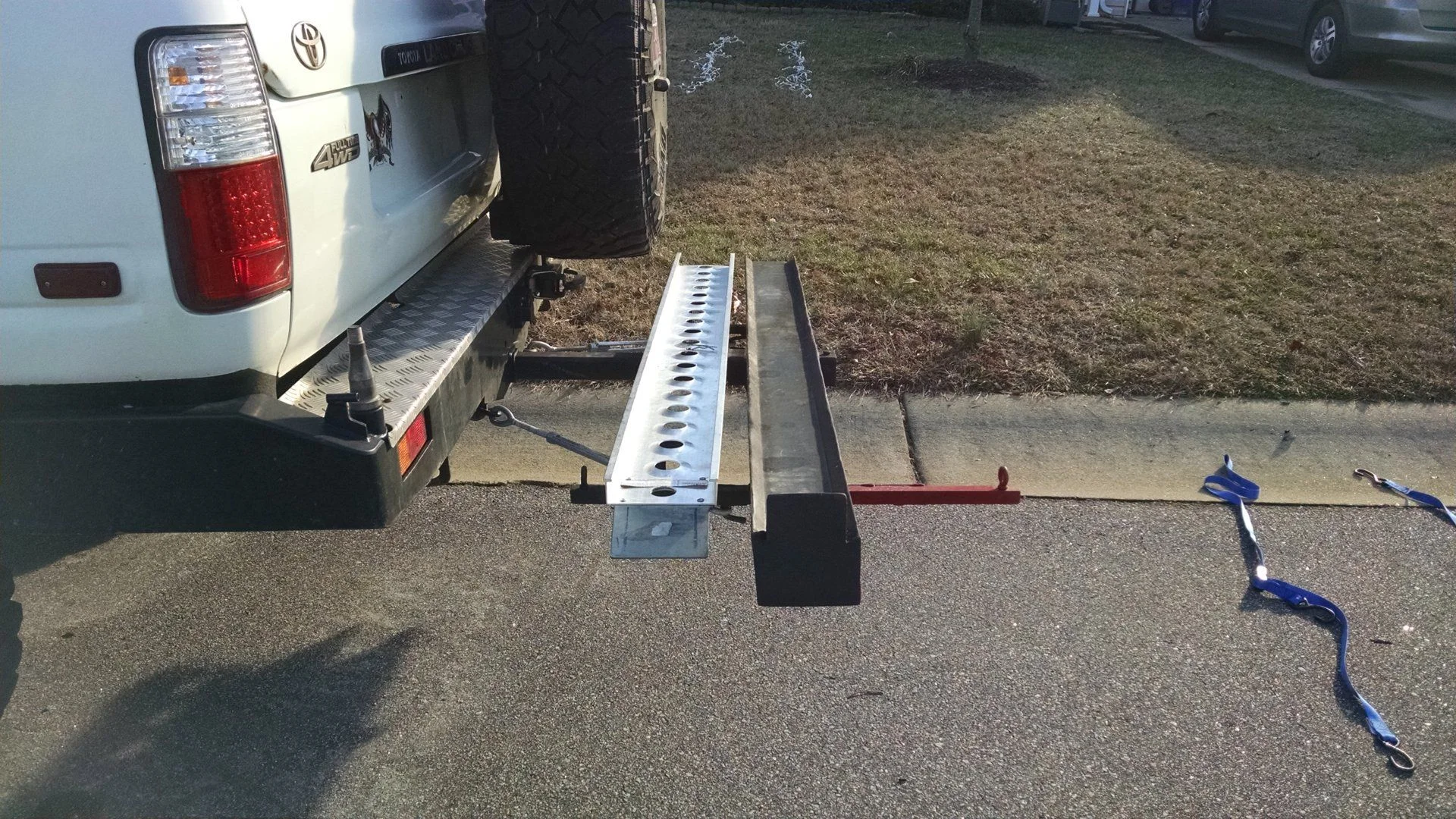

i have a homemade one you can have if you figure out a way to get it, I live near Raleigh NC i have carried several bike up to a yz400 on it no issues at all. very solid i also use the safety chain loops on the hitch in conjunction with a couple turnbuckles to keep everything sung. i purchased a truck and sold the bikes, haven't used it at least a year. The 2x2 tube is 1/4" thick, it will support more then the tongue of your receiver.
The ramp is stored on the carrier also.

that is why i use the turnbuckles. the carrier is part of the cruiser when installed. almost no movement. ant with the 1/4" thick receiver you can slide in a second carrier and haul 2 bikes if you wanted and your hitch could support the tongue weight.
