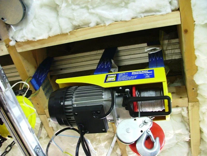

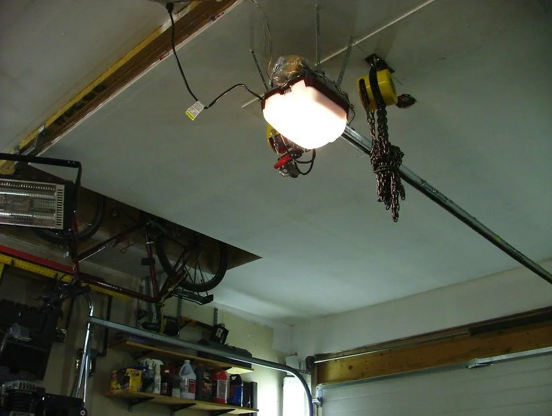

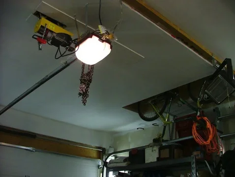

Man, I don't think I would be using that chain lift off that roof joist, the joist is secured by a downward timber which held in place by a truss metal bracket!
Yeah, I know it's not the greatest. It looks better in real life as I the hoist is connected to a 10,000lbs axle strap, which is wrapped around both the centre joist and two 1.5" square extruded aluminum bars that span 3 joists and rest above the diagonal in the joist and thus "pushes" the load somewhat into the vertical 2x4. So the load is supported by more than the one picture would lead one to believe. Also, the truss is bracketed both sides and I'd put more faith in those than perhaps some other method of joining.
I ummed and aahed quite a bit when I needed to use it for one particular job and could probably have strengthened the set-up but felt it sufficed for what I needed, and believe me, I was watching VERY closely when I used it the first time. I use my 2 ton folding engine hoist for heavy duty, lowish height work but believe it or not, I have hoisted my 1HZ out of its metal crate and put a 3B in its place and lifted the engine and crate simultaneously. It's good for about 800 lbs I'd say...:D
Thanks for the concern, it is warranted but for <1000 lbs work where I'm not jumping up and down on it, I should be OK. I wouldn't attempt an engine + tranny + transfer lift. That might be asking a bit much of the set-up and I'd really then have to agree with you.
So, you get first dibs on "I told you so" when I complain I dropped something.:rolleyes:
Better look at axle strap wrapped around bars resting on 3 joists.

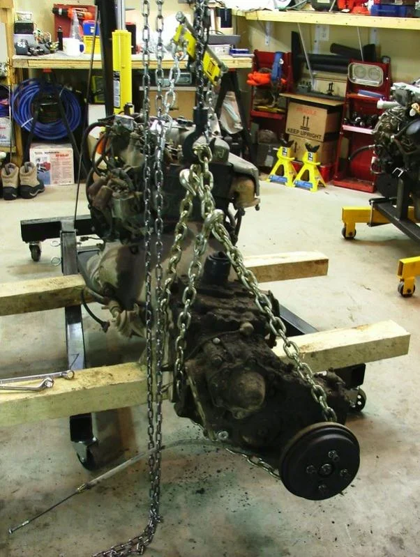

What the chain hoist typically gets used for. In this case to support the transfer & tranny when separating from the 3B that was in the truck. The engine itself is supported by the engine hoist and not the chain hoist in question.
What I really want in the garage is a kick-ass I-beam and trolley set-up. Alas time, space and money have been constraints to date.

P.S. The dodgy set-up is now drywalled so I don't have to look at the potential disaster now.:) Actually, I could go in at a later date and strengthen the joists, if I so desired, as I have left access.
Drywall tape is very strong. You'll be fine. Keep your cell phone close, just in case.

Yup, I feel a whole lot more secure now that it's drywalled. The drywall and tape will add significantly to my perceptions that it is a safe set-up...

The electric hoist is only there because I won it at a club raffle. It has a single line pull of 330 lbs and double line, double that. I personally wouldn't use it on anything expensive and I have it more as a utility hoist and have barely used it.
The 1 Ton chain hoist is as good as any other chain hoist. I doubt there is anything one could screw up building it and I have used it to hoist my expensive 1HZ that I couldn't afford to drop and I trust it.
The folding 2 Ton engine hoist is very good value for money and folds up to take almost no (floor) space in the garage and I can recommend this unit. It is well built and easy enough to take apart (folding legs) and transport single-handedly and has seen a bit of club use. No complaints.

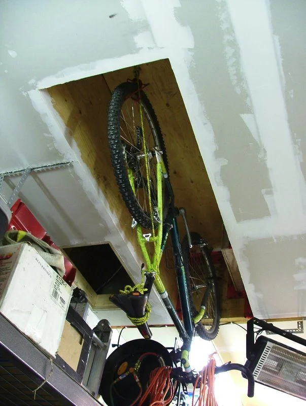

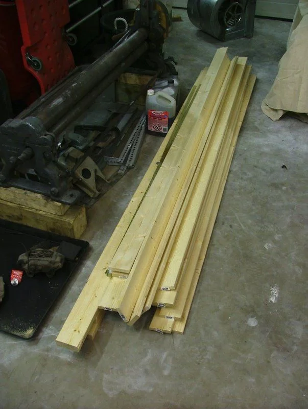

So, three days shy of a month of Sundays (well actually, Saturdays, Sundays and any weekday evening time I could find except a couple of low motivation sick days), the framing, drywall, taping, mudding and primering are complete.
The cubby holes for the bikes to get them the hell out of the way of my precious floor space.
The finished product
So, you may ask why put so much time into doing drywall etc. I have an attached garage. When I fibreglassed the 40's floors originally, the house stank of Styrene for 2 1/2 days afterwards. I want to be able to paint the truck at home to save money and that requires a paint cell that can be deployed in a short period of time that also keeps paint out of the house. My wife will appreciate that greatly :princess:. I also wanted to be able to poaint in winter and that required keeping the heat in so hence the effort. I bothered to tape and paint because I am annoyed with myself for not having done so when I had a lot less clutter in the garage. I was just sick and tired of electricals, insulation and drywall at that point. Now I have clutter and won't get to do the walls justice until the day I move out. Hence the motivation to do the ceiling job right now.
