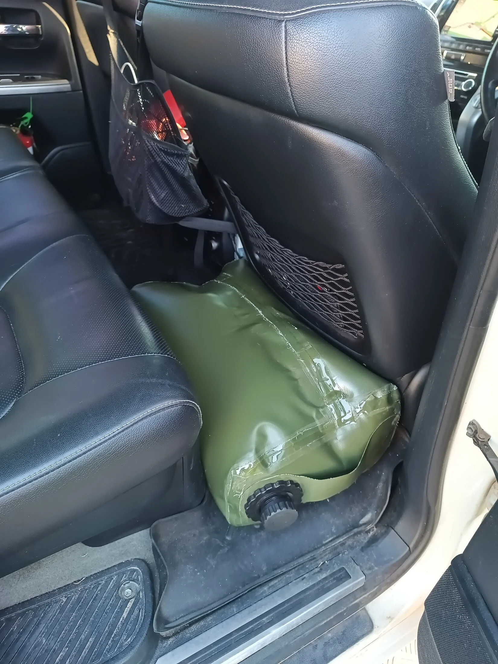

Before I go "all in" on the (sketchy?) plan of carrying 4 or so 33L (7 1/4 gal) bags of diesel fuel on the floor of my 200-series cruiser... does anyone have experience with this kind of thing? I considered inbuilt long-range tanks, but that adds extreme permanent inconvenience by moving my spare "in the way" of the rear doors - as would adding anything to carry 6 jerry cans (if that's even possible - 132L / 29gal is *heavy*).
Thoughts??? Does anyone know what happens to diesel in hot cars? (I'm travelling North and through the centre of Australia - it's going to be *scorching* hot) - does it offgas/expand or anything?
Never used anything like that but I'd be uncomfortable TBH. I would not contemplate it with gasoline at all, of course, but Diesel is much safer, admittedly. Still there is the potential for a big stinking mess, especially given the location of the bungs and the possibility of punctures. Personally, I'd keep the spare fuel outside if at all possible, short of an emergency, if only for peace of mind. I would think the bigger bladders are also harder to handle when filling the tank than the typical 20L rigid cans.
I don't think that those bags are very common in the US -although maybe more so in the military?- so I would ask instead on an Australia-centered forum, especially since there may be transportation legalities involved.
All in all, it would be a No for me, but I am not well-informed about these either, so take that with a grain of salt.

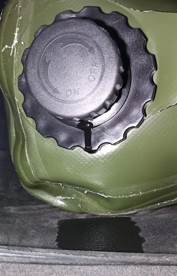

Looks like the bag itself is answering my question for me:
(that's not the cap which leaked overnight - its coming from bag-side - the base of the threads where they join the bag)
So yeah - needless to say this one is not an AS/NZS 2906:2001 approved container...
Just the first picture with the taped (?) seams didn't look like a good idea. Then that there is no labeling (on the other side maybe?) makes me question whether it is permitted.
I've seen the military-style fuel bladders, but have always been suspicious of them...
Come to think of it, these things look a lot like a surplus water bladder I have. OP, are you sure these are even intended for fuel?
