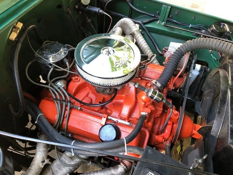

What year is your cruiser? Do you have a single or dual circuit master cylinder?
"Saw several tanks available (She's a '69)."
Haven't got her yet (in transit from SoCal). Hope these pics clarify (?)

You have a single circuit brake master cylinder. I would highly recommend upgrading that to a dual cylinder set up since you're not going for a stock approach. If that single reservoir fails for some reason, you just lost all of your braking ability. If you are off roading and nick a brake line, the fluid could drain and you just lost all your braking ability. There are some mud vendors here which sell an adaptor to allow you to use a later model master cylinder.
There is a lot of information already on ih8mud of people swapping to disc brakes and changing out the master cylinder. Check out the search function.
