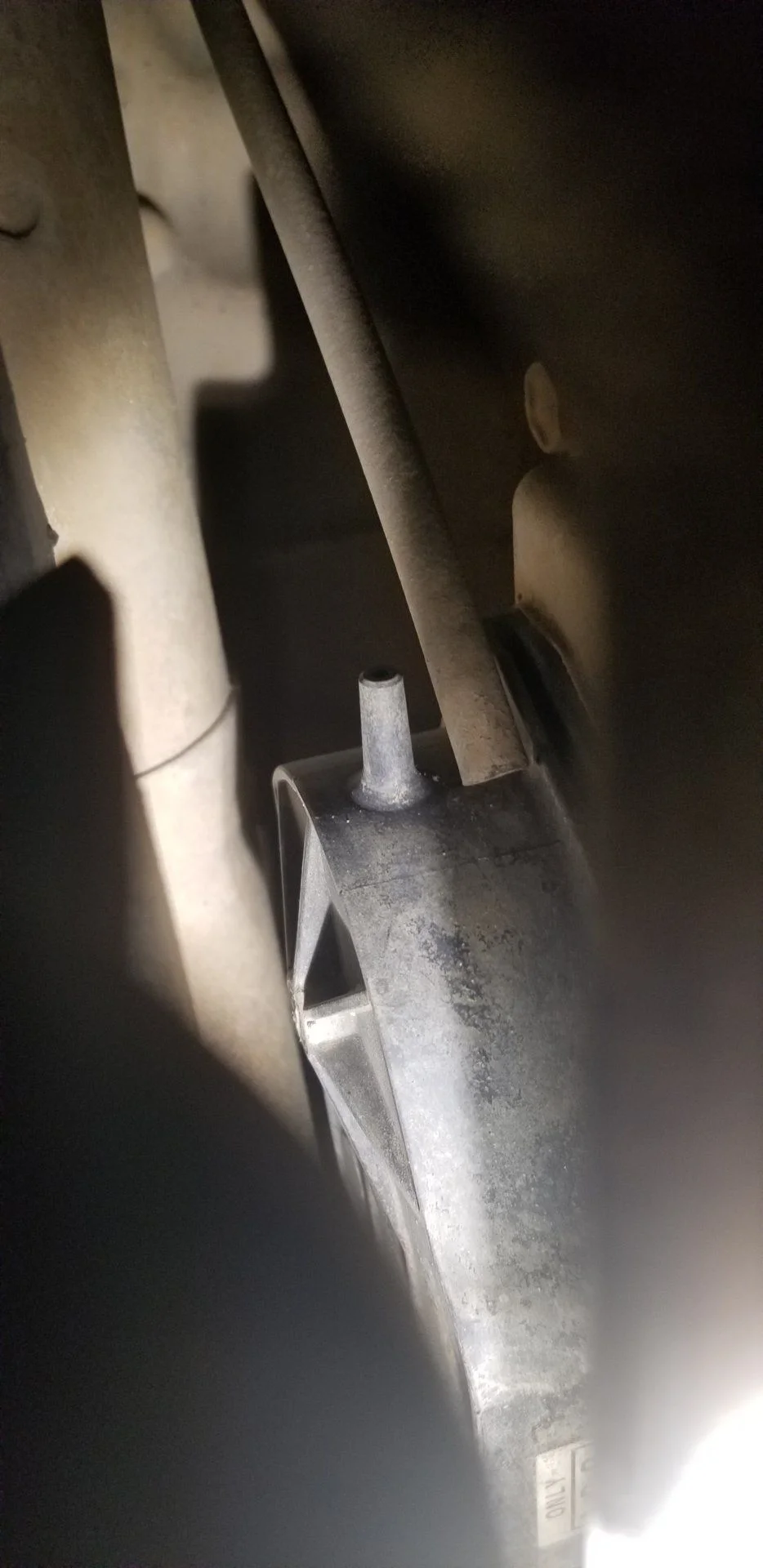

I noticed on the 2nd day my 4WD light was flashing even in 2H but didn't notice anything acting funny, got home did some research and found out the ADD (Automatic Differential disconnect) on the front axle had faulted. I climbed underneath and found my scuba'd breather had come off and I probably sucked in some water going through the crossing. I've been checking it the last couple days and its been actuating and no flashing so I'm hoping it dried out and dodged a bullet. But morale of the story like Frank said, check your diffs and breathers to make sure you didn't suck in any water.
I had extended my front diff breather up to the hood but the rear is up to the underside of the truck which was well under water so I need to check my rear diff.
