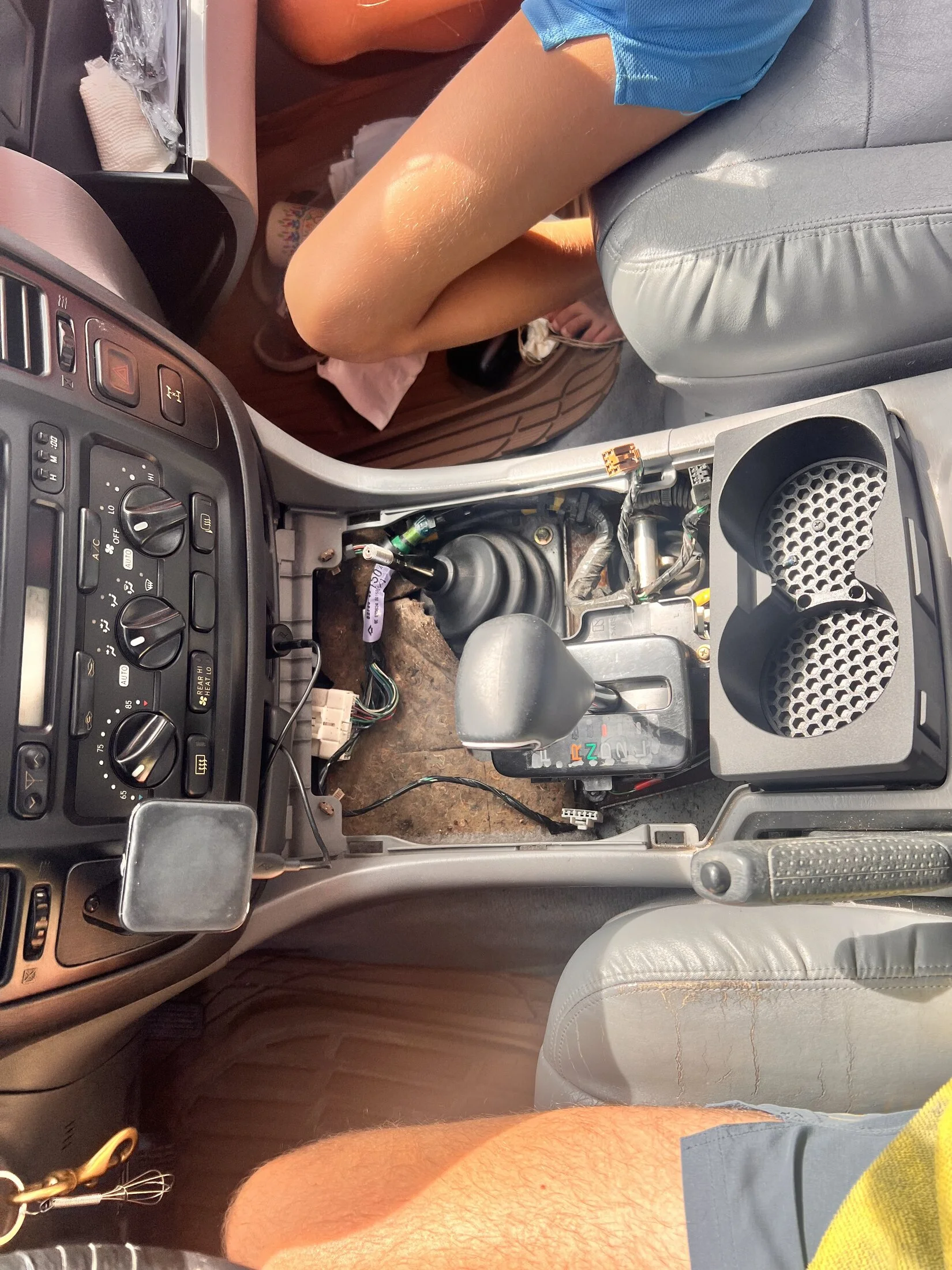

I have been tossing around options for updating my 98 LC non-nav stereo, and something about the dual CD cassette deck has grown on me quite a bit. I upgraded speakers to Morel Maximo components in the front, and to be honest it sounds quite good for my tastes. I had been doing Bluetooth with a cassette adapter, but those require recharging and I get paranoid about the player going out eventually.

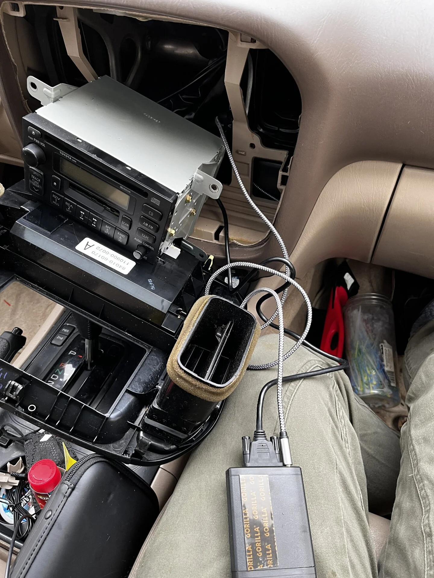

I discovered this cheap Yomikoo” Bluetooth adapter that hooks up to the old style 5+7 connector. For $55, worth a try. Has Bluetooth 5.0, does hands free calling, and aux in. Went in seamlessly, and I was able to route a 1/8” audio cable up through the passenger a-pillar to the headliner light console. I have no idea if the mic they send with these units is any good, and this way I can do swaps in the future without taking everything apart again. I also imagine that these units would work as well as the BT45-TOY that I have seen posted, and they are available for newer stereo pinouts as well. At $100 cheaper, worth checking out.
For anyone trying this in the future, I did zip ties for cabling where I could and used double sided tape to stick the Bluetooth unit on the back of the stereo. Plenty of room back there to hide everything away.
It all went back in without issue, and pairs seamlessly with way better sound quality than the cassette adapter. Hitting track up/down cycles songs through Spotify, if you don’t want to grab the phone to change songs.

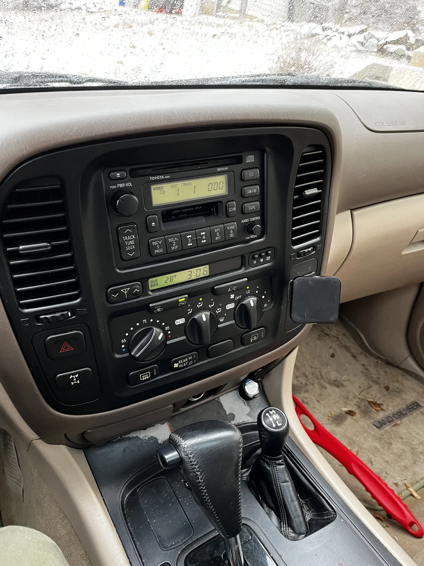

I also wanted a wireless dock, and installed a Peak Design one in the blank on the bottom right. The one caveat to this is that the power on the Bluetooth unit, or the cable I used, doesn’t seem to be working 100% of the time, so will need to sort that out in the future. There are a couple of convenient workarounds for now until I get back in there and mess with power behind the dash.
The end result is as clean as I could have hoped, keeping the interior almost entirely stock. Maybe one day I will upgrade to a CarPlay system, but for less than $300 between speakers, Bluetooth, and charging dock I’m quite happy with the setup so far. Will have to get more time with calling to be sure it’s worth using, but I’m not on the phone a lot on my commute so won’t be upset to pick up on occasion. Forgive the last bits of wood grain that haven’t been pulled off yet in the photo!

Nicely done I used the peak design wireless charger as well. Your the first person I’ve seen using it what a great mount.
Ooh but you swapped sides. I need to bite the bullet and get the bencc printed mount. I do not advise trying to mod the stock blank - it doesn’t support the weight of the phone without annoying rattles/squeaks. I also hid my USBC cable behind the mount panel, so there aren’t any wires hanging out. It’s super slick.

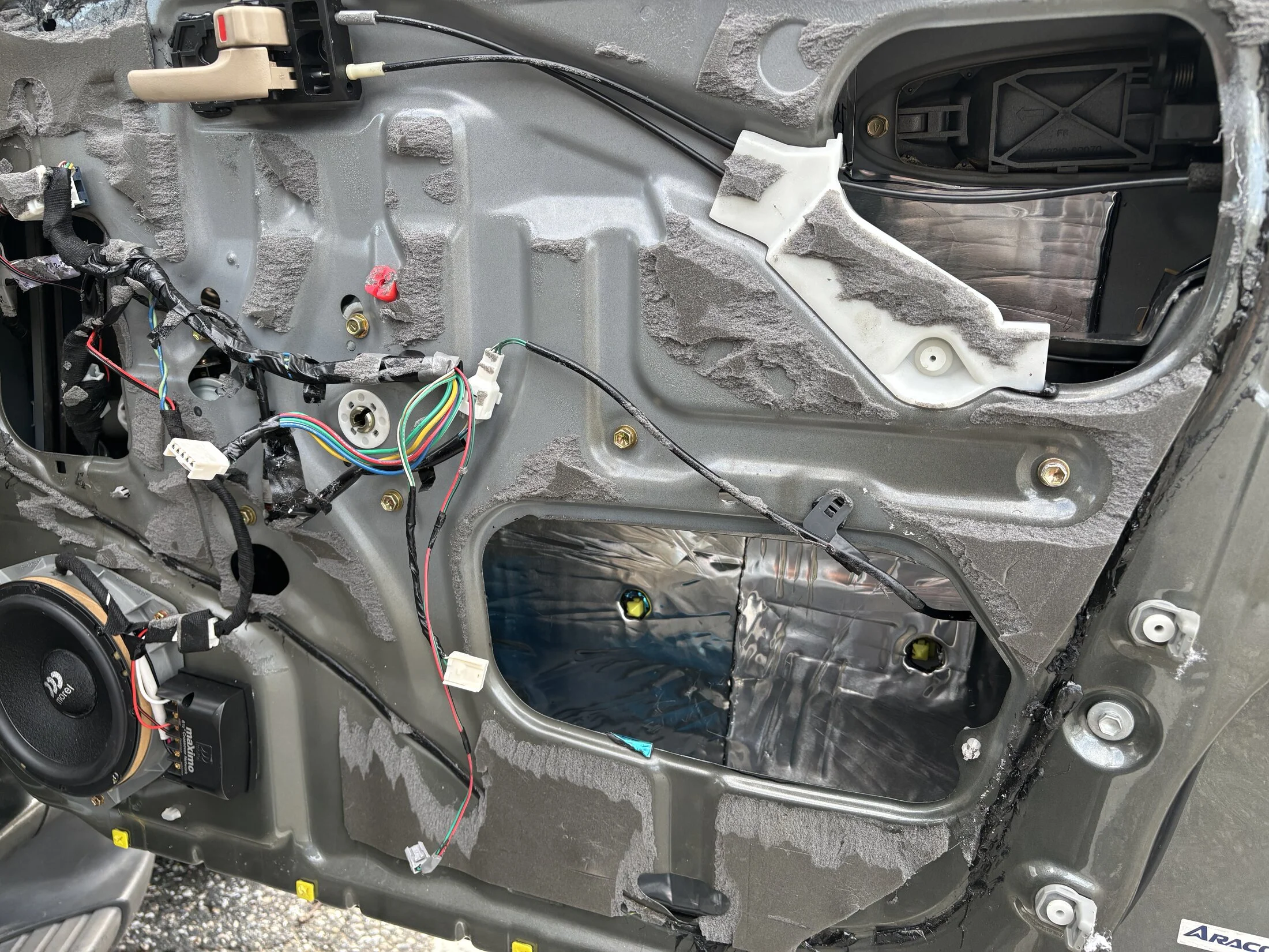

I’m now in the middle of a full stealth stereo upgrade. I posted this elsewhere, but sound deadening the doors does worlds for overall sound quality on the stock head unit and amp in my 98 LC. I spent around $250 on Resonix products (on sale) and I can’t get over how much more enjoyable everything sounds and feels as a result.
I used Resonix Mega CLD on the outer door skin, and ran butyl between the door skin and the crash bar. The latter has something in there from the factory, but the panel is really “live” still. After treating, the door is absolutely dead, and the rears comparably sound like a steel drum.
Don’t mind the nasty grey remnants of closed cell foam on the inner door skin. Pro tip: don’t use the wrong material on your doors, it is far harder to take off than it is to put on. I will be making service panel inserts out of 1/32” lead covered in that foam, since I have so much on hand still. Right now all the holes are just sealed up with adhesive vinyl sheets as a temp solution without a vapor barrier installed.

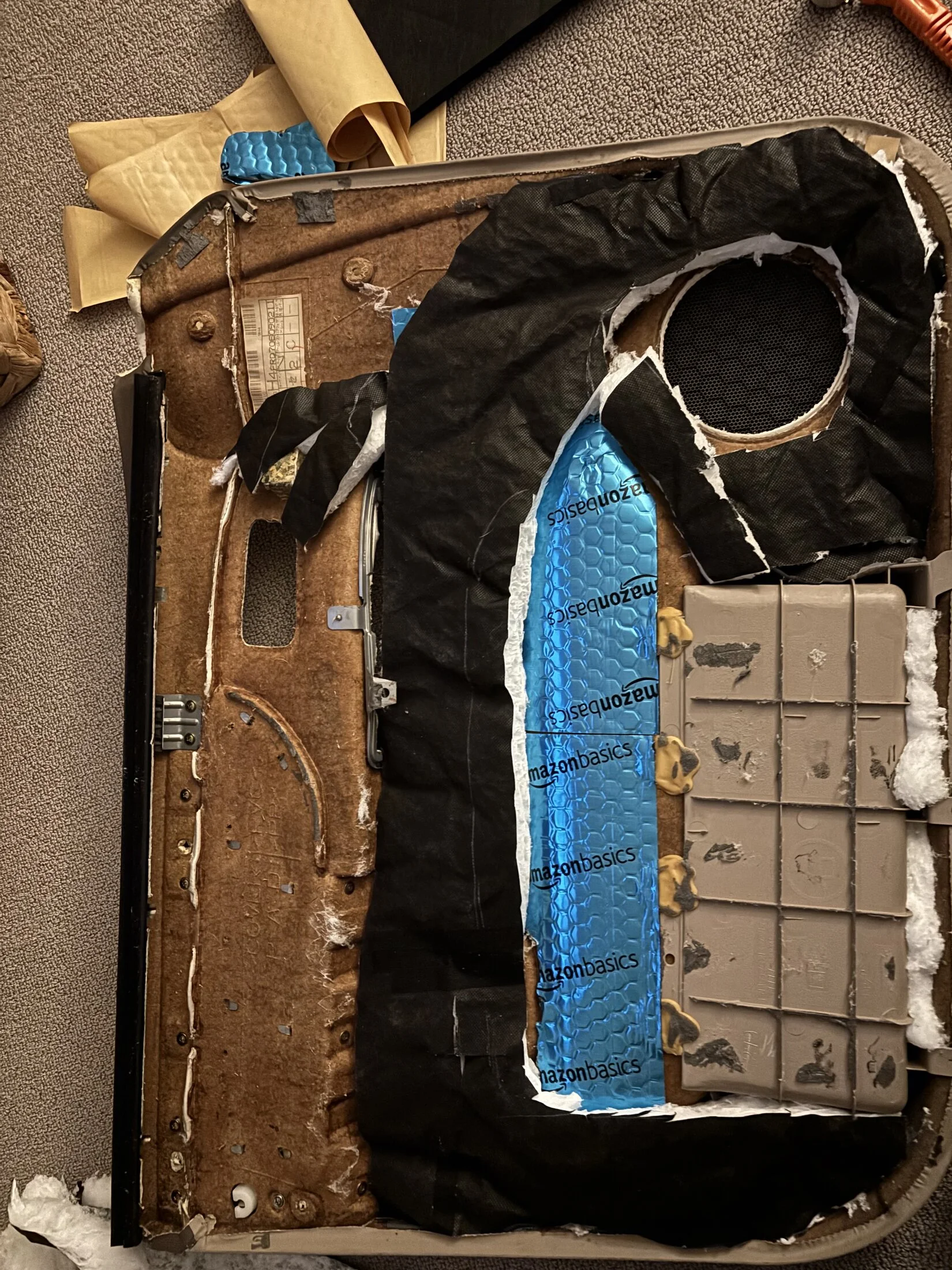

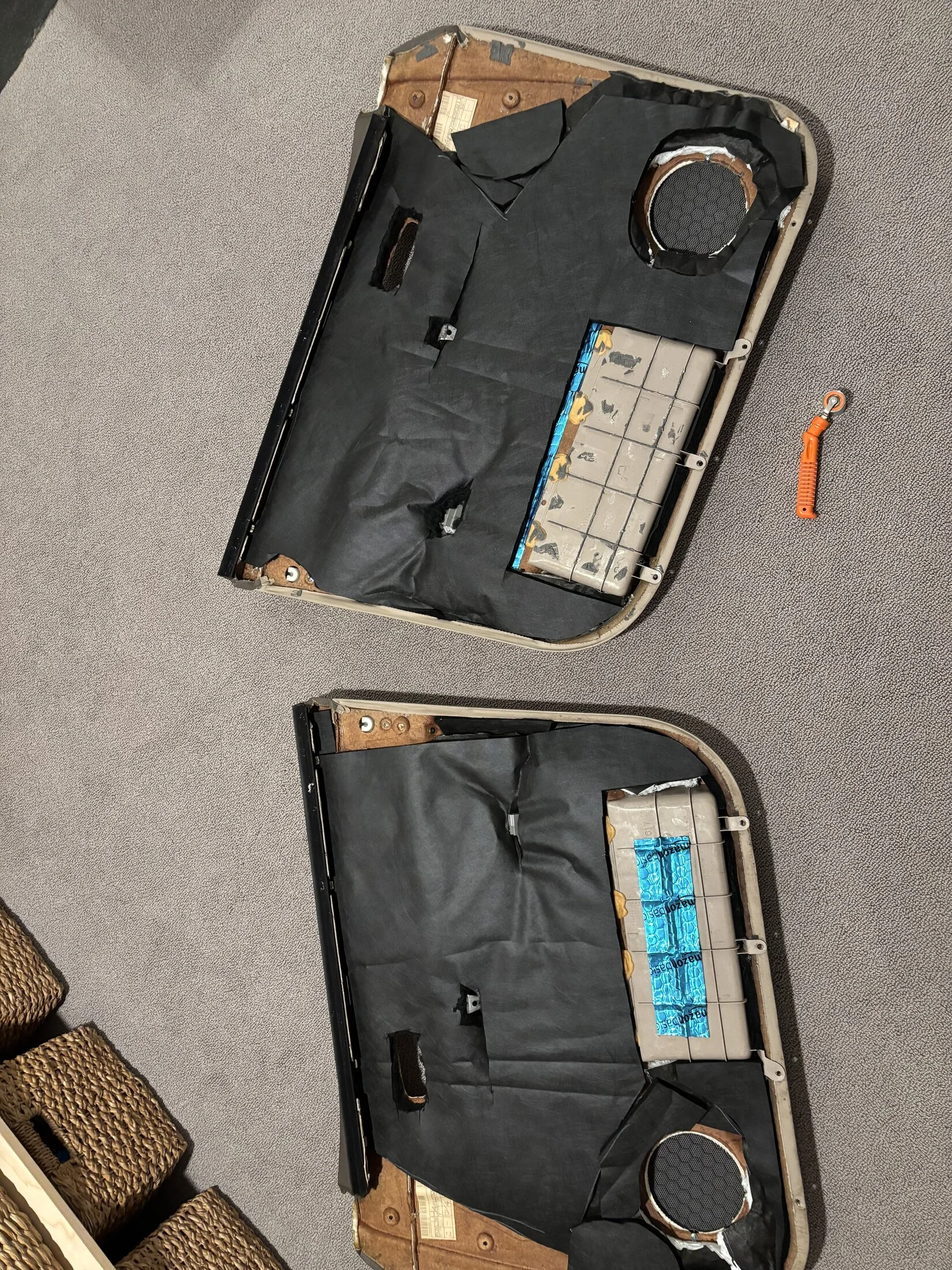

Next, I treated the door skins using 2” Thinsulite 600A and 0.5” Resonix Fiber Mat. Before doing so, I cleaned up the fiberboard and then “painted” it with 1:1 water and titebond III wood glue. After drying for 24h, I used leftover Amazon Basics CLD to add some extra mass (I was paranoid this wasn’t going to stick without a better prepared surface). The Thinsulite only fits into the deep parts of the panel around the speaker and arm rest, and the Fiber Mat is thin enough to go on most everything but behind the map pocket and the very front of the door card.
After all of this, I’m now on a slow roll for replacing the stock amp with a Mosconi DSP setup that has more power and processing than I’ll know what to do with. I started all of this thinking I wanted it to sound amazing, and really don’t think I would have gone much further than treating the front doors had I known how big a difference it would make.
