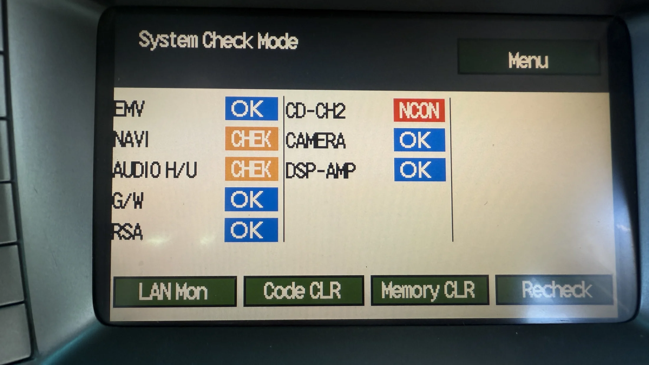

Battery reset and changing the amp fuse didn't have any effect so I'm going to do the on-screen code read and also assume I need the amp repaired, and will report back on findings as I go. I know rarely the head unit has been a failure for some folks instead of the amp.
This is the result of my diagnostic earlier. One thing w the CD is I have the basic plug and play Grom unit that allows for me to connect a 1/4 AUX for music, and does nothing else. I recall that I select that by tapping the CD button on the head unit a second time. When my issue first started I had been listening to music, a call came through over the factory bluetooth, and when I hung up from the call there was no music and just that electronic tick every second and a half.
I’m wondering if the Grom maybe went out since it’s selected via the CD changer selections?
Otherwise anyone had this exact indicator?
